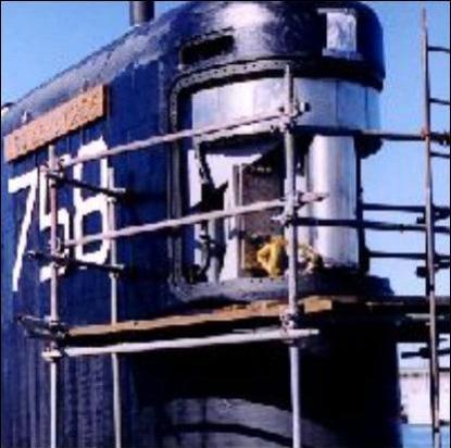

    Came across this pic the other day. Its small and fuzzy but I tried to clean it up as much as I could. Does this look familiar to any of you career sub guys?

    That would be the later version of the BQS-15A, the upper 8 sections are the Massa EC-20 receive modules and the cylinder is the active portion. This was a large improvement over the previous array.
    Prior to that the BQS-15 CTFM section had a flat faced trainable (up-down & left-right) array that was prone to flooding in the train drive motor sections, also sometimes noisey, we called it the nodding idiot.
      So the one pictured was an early "phased array type"?
      • BDFguy
        • May 2011
        • 7
        No, the one pictured is the most recent array being used which also required a lot of mods to the beam forming system.
