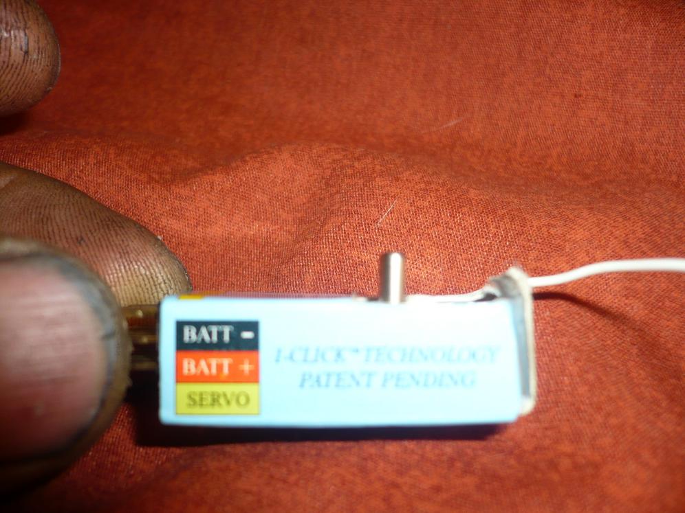

    dumb question sl6 receiver

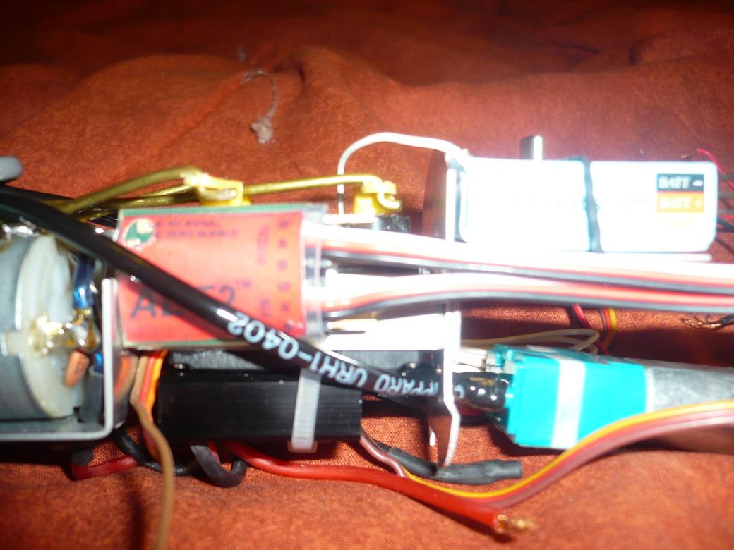

      sorry the question was does the crystal look fully seated.deliacate pins and was afraid to push any harder..all my other receivers the crystal sits flush with the surface of it.as i have never had one this small i don't know if it is fully seated. so figured i would ask 1st before trying to push it in further and damaging it.as you know i let the smoke out of a batt when i was interupted by my 2 youngest 7&9 to ref in a dispute between them and the oldest18..as i got more into the issuei got mad and was not paying attention to what i was donig and cut both power leds on the batt at one time giveing the smoke show to all. then the roches scattered cuz now they had dads undivided attention..so the the toll so far is 1 dead batt to replace and possably 2 more depending if i can solder new cables on to them where i misjugded the lenght neede and made them too short... dave you you just use a y harrness to series you batts or do you solder the leads.. if so do you have a picture?????????????

        I'll take some shots of my parallel connected LiPo's. I simply solder two red wires to a single pin of a Dean's connector, and the two black wires to the other pin. No Y harness, just hard-wired cables to the plug pins. As you (better than anyone else on the planet right now) know, keep the opposed battery wires away from each other till the heat-shrink in on and snuggled down.
        Pretend you're EOD doing careful work as some ass-hole with a cell-pone, around the corner, flashes you an evil smile. Be that careful when handling these batteries.
