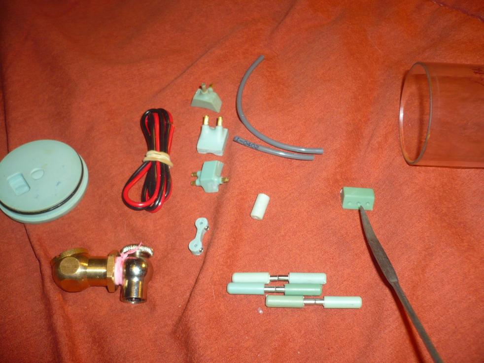

    #2 in the pictures on the site add and the paper the subdriver came with it shows the dumas drive dogs on the output shafts.. mine doesn't have any nor were any on the bag in the batt compartment.is this an oversight? i was going to order 4 of the brass ones in my next order anyway... and the lipogard and a few other things..

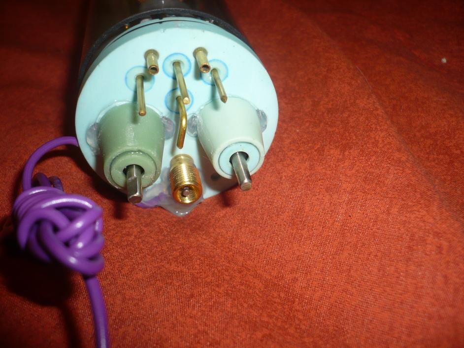

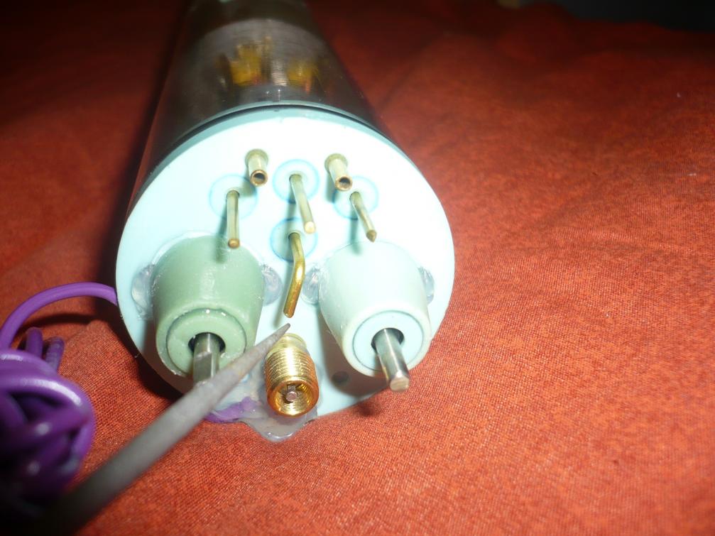

    #4 on the moter bulkhead there is a rod attached to nothing see pic what is this for??????another servo?????

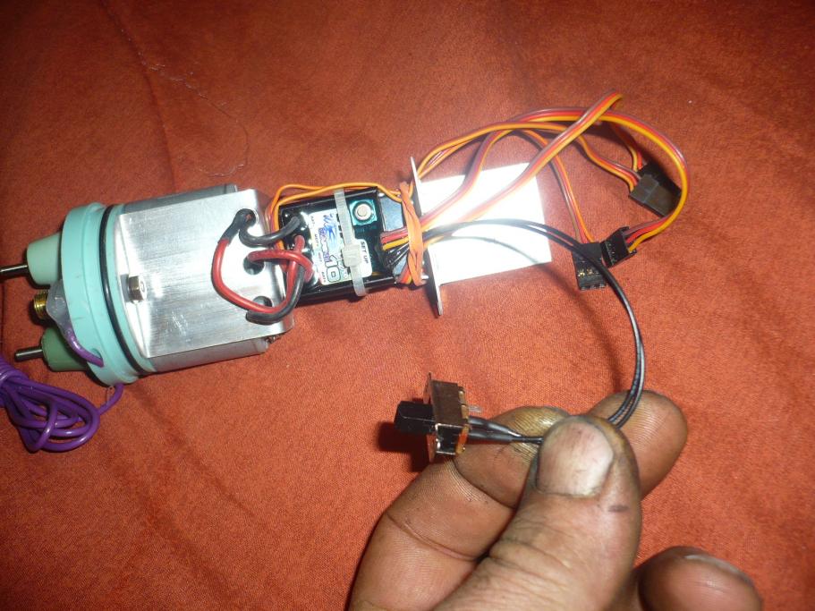

    #5 on the speed controller what do you do with the built in switch?does it tie into the single throw double pole switch that goes on the batt bulkhead........
    #5 whats this????/ the odd looking block with 3 dimples?????

    2. The cast resin Dumas style dog-bones and couplers come with the Type-7 fittings kit, not the SD.
    3. That brass rod is there to blank off the hole of an unused 1/16" pushrod seal. I put the extra seal in the motor bulkhead (which is used for both the SEAVIEW and Type-7 SD's and possible future subjects) to permit expansion of the SD's capabilities in future products. Don't sweat it.
    4. The ESC power switch: cut that sucker off, twist the wires together and solder them, then slap on a short length of heat-shrink tube -- all on/off chores are performed by the mission switch mounted within the forward removable bulkhead.
    5. It's the battery cable strain-relief block. Where the dimples are, open them up with a 1/8" drill bit and mount the block onto the inboard face of the forward removable bulkhead (end-cap). You'll reeve the cable wires through it so you don't put any strain on the wiring where it makes up to the mission switch.
