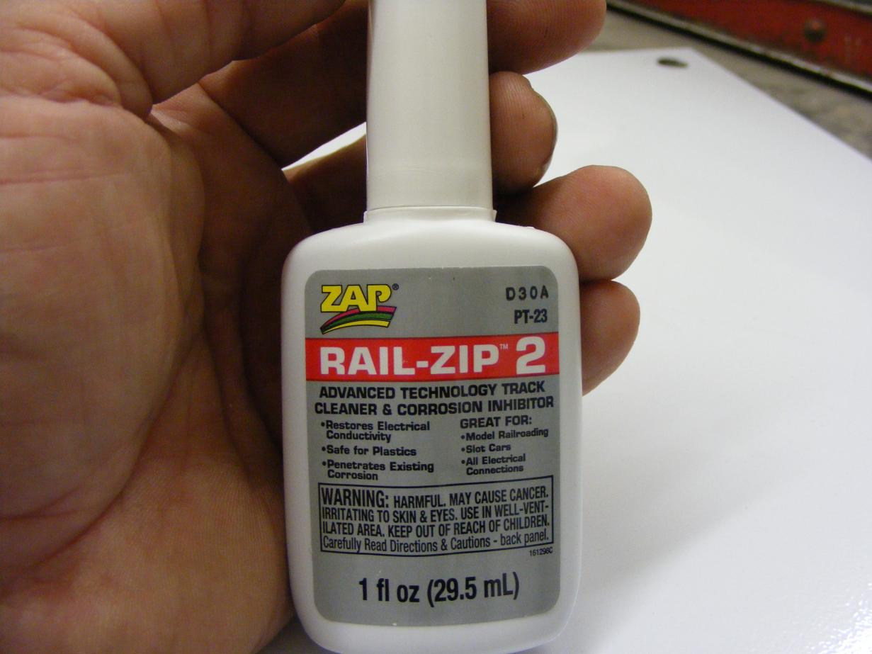

    If any of you have ever spent any time around HO scale model railroading, you know about a constant problem with corrosion of the track and problems with good electrical pickup. So the solution has for the past 25 years been a product called Railzip. It enhances electrical conductivity like Magic. I dont know what its made of but its fantastic. Well, whats that got to do with Model Submarines? I dont know about you but the electrical connection on the back of my Subdrivers, under the thumb screws, turns green. It requires constant cleaning. Ill bet this stuff takes care of that. At the very least itll give me some peace of mind that I wont lose power to my sub because I forgot to clean it or am too lazy to clean it. A little dab will do ya.Click image for larger version

ID:	101775 I bought this stuff from Amazon but Tower Hobbies has it as well.

    Your a genius! That may help on my electrical system. Thank you.
