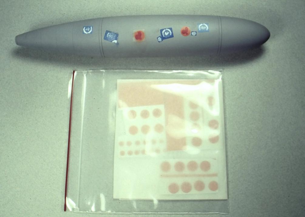

                      The following pictures show markings achieved with decals, ruling pen, and careful masking -- all employing water soluble acrylic paint. The 2K polyurethane clear-coat has no negative effects over those type markings. I've also had good results with dry-transfer markings and self-adhesive metallic foils -- again, no negative effects when overcoated with this type of clear-coat.
                      Keep in mind I make my own decals (though the pre-glued decal paper is a commercial product). I paint a specific color to the decal paper and cut that for strips, squares and circles; or use a mask(s) to render specific images -- the UN logo against a blue background pictures below -- to suit a specific job. I almost always paint the markings with the very benign acrylic type paint. The cheap-ass Walmart paints works just fine.

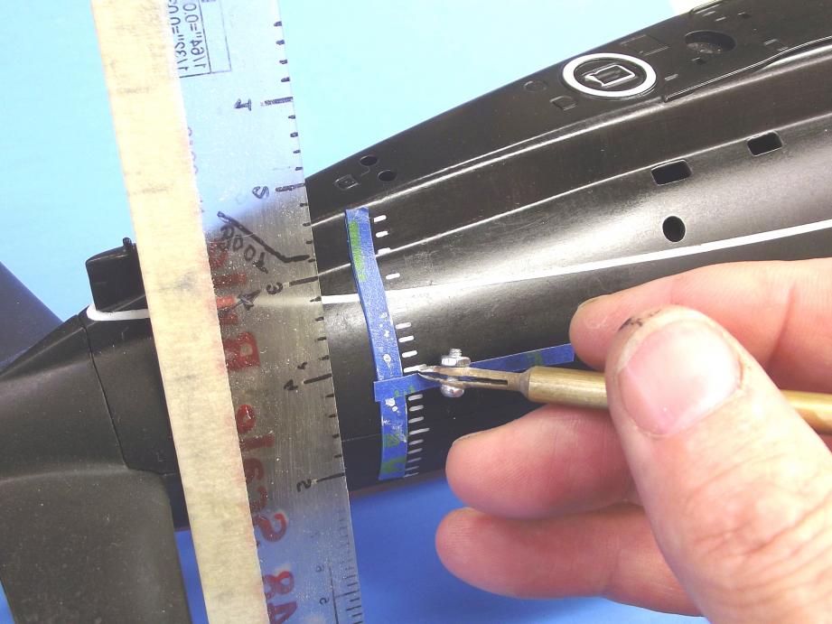

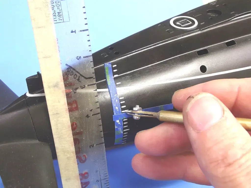

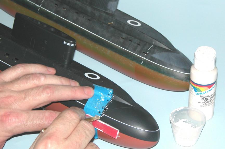

                        In this picture what is the application tip in the tool holder and are you applying acrylic paint or another material? Thank you.
                        Click image for larger version  Name:	IMG_7548.webp Views:	0 Size:	50.7 KB ID:	195054

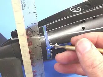

                        In this picture appears to be a second approach to line spacing. What is the benefit of each particular approach please? (yes, running at high risk level for dumb-ass un-researched questions!!!).
                        Thank you David.

                          Keep in mind that though the 'solvent' of water soluble acrylic paint and its 'clear-coat' (often described as 'Artist Medium) is water, once the water has evaporated away and the acrylic binder has polymerized, the resulting hard film is insoluble in water.

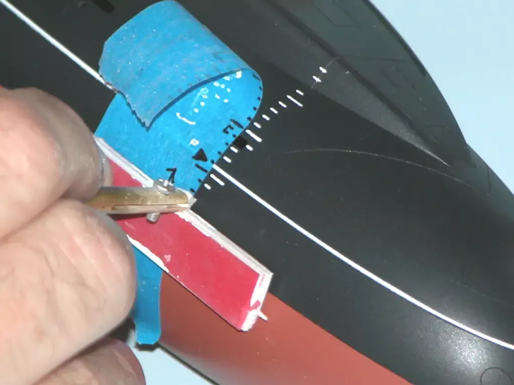

                          You're doing fine, Tim. No dumbassery yet, pal.
                          As you observed I illustrated two methods of applying the 'bar' type draft markings: one using the ruling pen. The other using white decals.
                          The work goes very fast with the acrylic paint loaded ruling pen, but goofs are inevitable -- that's why you always protect the base coats and any detailing previously applied with a protective clear-coat, permitting you to successfully scrap or abrade away the goofs without harming previous work.
                          Click image for larger version  Name:	004.jpg Views:	0 Size:	51.4 KB ID:	195062
                          Click image for larger version  Name:	003.jpg Views:	0 Size:	74.4 KB ID:	195063

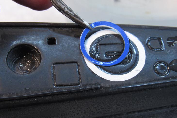

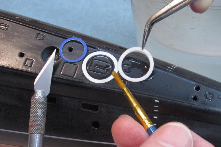

                          Decals tend to be fidely and will try your patience! The work goes slowely, and they don't have the robustness of painted on markings -- though that shortcoming is short lived and not an issue once a clear-coat goes over that work.
                          Click image for larger version  Name:	IMG_4573.jpg Views:	0 Size:	45.3 KB ID:	195065
                          Click image for larger version  Name:	IMG_4568.jpg Views:	0 Size:	47.1 KB ID:	195066
