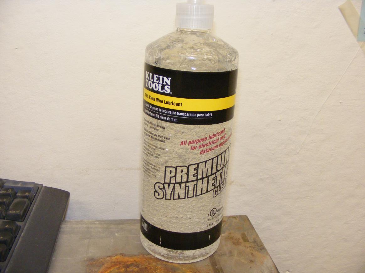

    Check this out. Ive been using silicone grease as a o-ring lubricant for my Subdrivers for a while now and it has worked well. Then I switched to Dielectric grease because its the same thing and easier to get. But the price is steep. Well, I just found this at home depot. Its Klein tools wire pulling lubricant called "Premium Synthetic Clear". Their website doesnt say much about its composition so Ill try it next time and give you some feedback. Its like a gel and 32 ozs. is $6.97.

          On second thought, this stuff acts as a lubricant and might not be the best thing for the orings on your end caps. Wouldnt want the caps to come lose and admit water.
