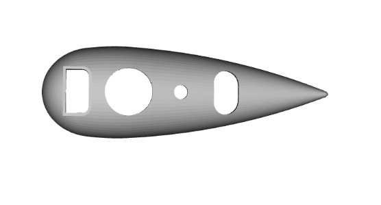

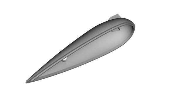

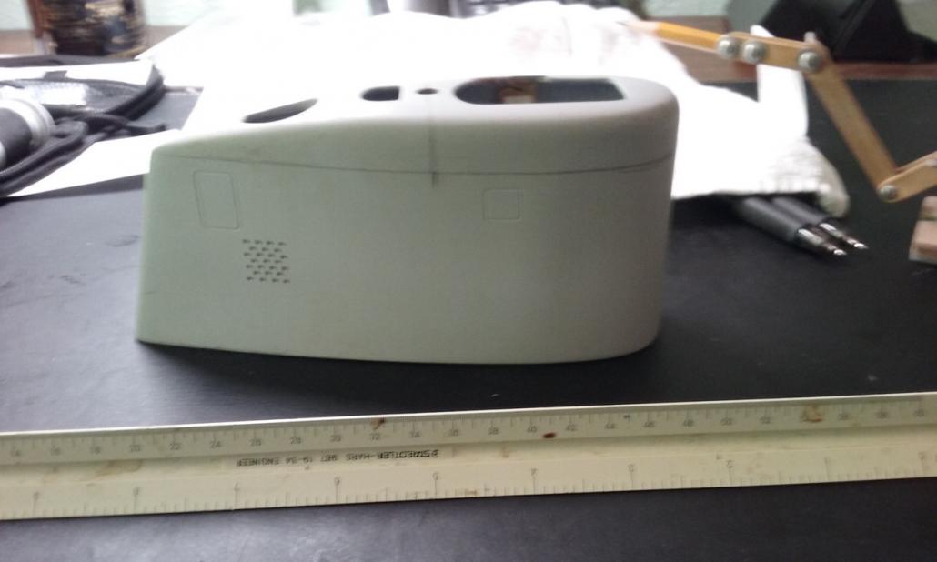

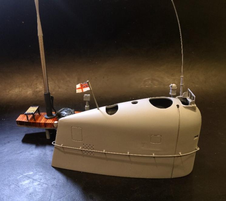

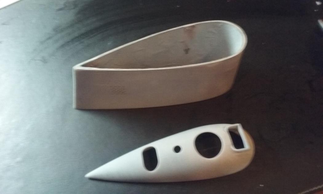

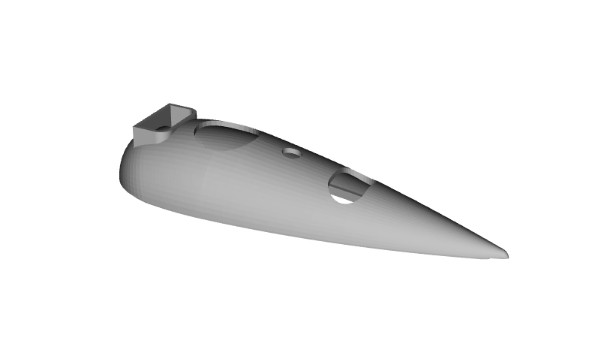

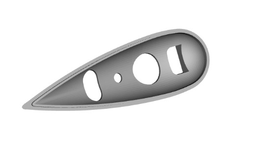

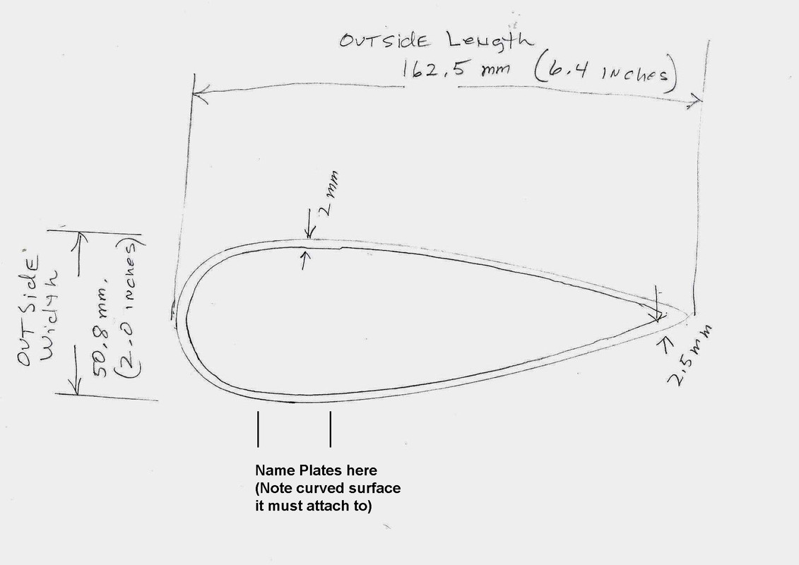

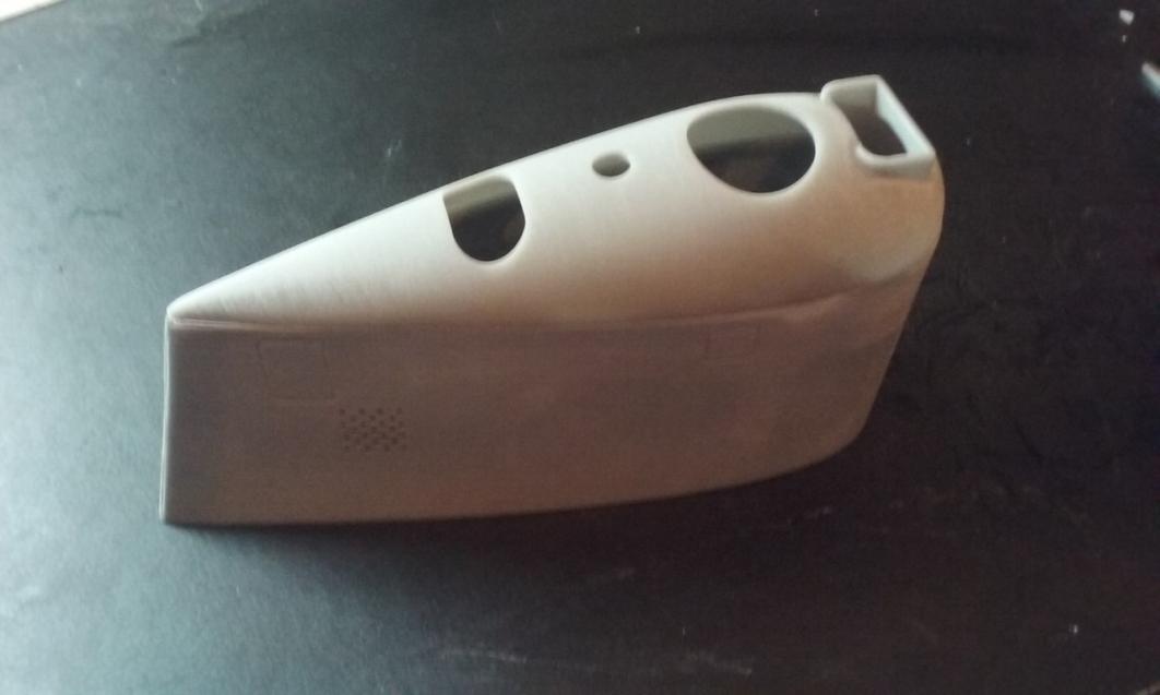

    Sending you here some of my photos and notes on Meteorites fairwater. Seemed easier here than in a private email.
    As we know Shapeways had gone bust with their dumb management model and the programs they made for me and hundreds of others went bust too. Here are illustrations to help you responding to your private emails. Always happy to help you Ganthu. Hope it helps.
    The Germans didn't allow much for their Type XVIIB crews for escapes and safety. It seemed to reflect different cultures and risk assessments vs technical goals, The British redesign at Barrow -in - Furness for this experimental sub converted its torpedo loading and the fairwater hatches into escape hatches with canvas trunks.
    The large round hole on top in images below - notice is deliberately slightly off set from centerline because the bridge hatch was the same off centerline too. This to help align for crew escape - swimming free assents if they got into trouble - also affording another lookout position. The opening diameter same as the hatch below it.
    Funny story I learned in my research was how the British to keep the Soviet inspector away from poking around too much (Potsdam Agreement) when the boat was up on the stocks in the Barrow shed out of the water - they electrified the submarine when it was not being worked on!
    While it could be touched and walked on top or around inside still - there was a low voltage current running through it to make close inspections deliberately excruciatingly uncomfortable. LOL.
    The small hole is for the single air search scope of course. It doubled as an attack scope on the original U-1407 too. The Brits were always impressed with German optics understandably.

      I'm glad you elected to post this here and not squirl it away in an e-mail. A very informative and fun read! You have considerable chops as a writer, Steve. That skill only matched by your Craftsmanship in the shop.
      Please... tell me... you're going to write a book or two before you become worm-dirt.
