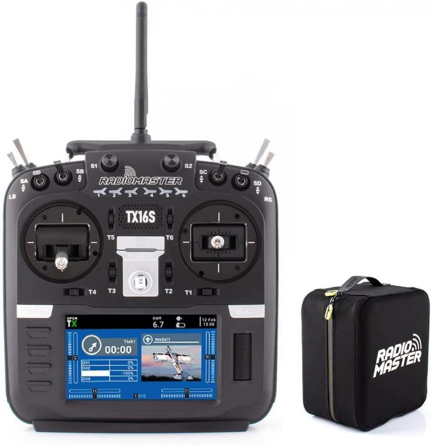

        Well right now if you don't want to do any soldering and just want to put it in your sub like a reg 75mhz system and just set the setting on the radio, It will cost you around $323 for the Transmitter, 915mhz module and receiver, without tax of course. As I said before , Amazon or drone hobby shops sells the stuff As I like I like a big screen and a ton of other stuff that a RC sub doesn't really need I went with a transmitter that was a higher price and with a 915mhz module that was the most power for the 915mhz TBS Crossfire module It can pump out 2000mw of power, however it is a overkill. A module that does 1000mw is fine and a hell of a cheaper, that is why my system ended up costing $553 a lot of needless overkill.

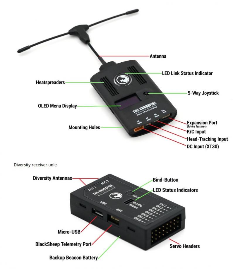

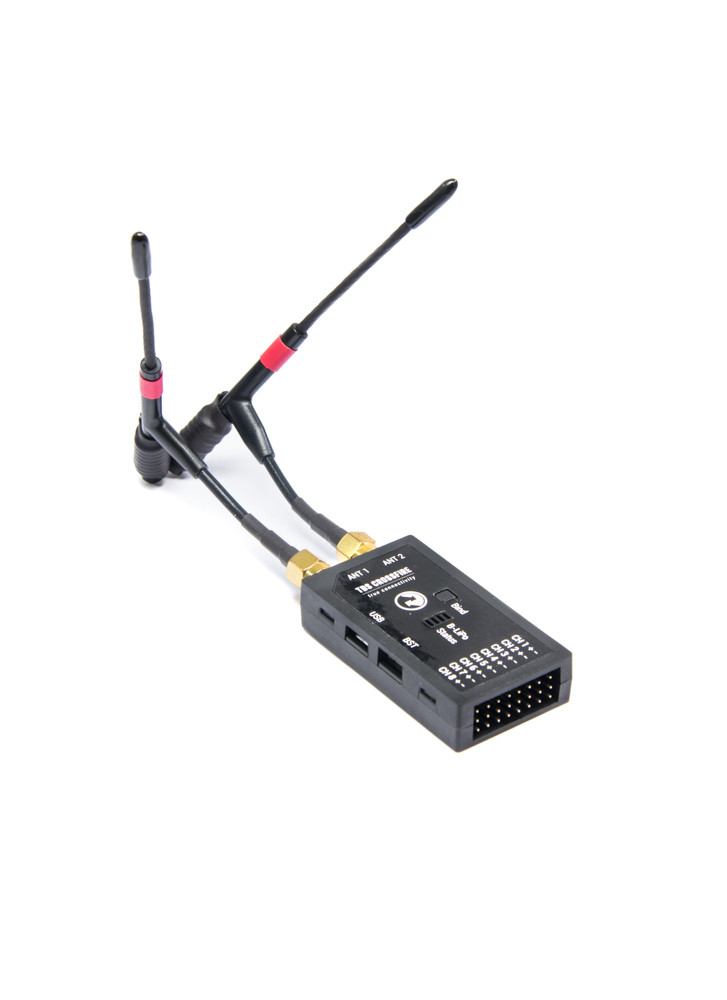

        I am using a Radiomaster TX16S transmitter with a 915mhz TBS Crossfire Transmitter Module and a TBS Crossfire 8 Channel Diversity Receiver. Below are pictures of what I bought and worked in my sub, but both the transmitter and the module I bought are overkill.
        The better and cheaper options I think would be a Radiomaster Boxer or Radiomaster Zorro transmitters and 915mhz TBS Crossfire module that fits one of those Transmitters. However I have not tested those, other sub people have. Also don't just buy stuff, make sure your buying the correct stuff as don't confuse 915mhz stuff with 2.4ghz stuff as the packaging looks the same.

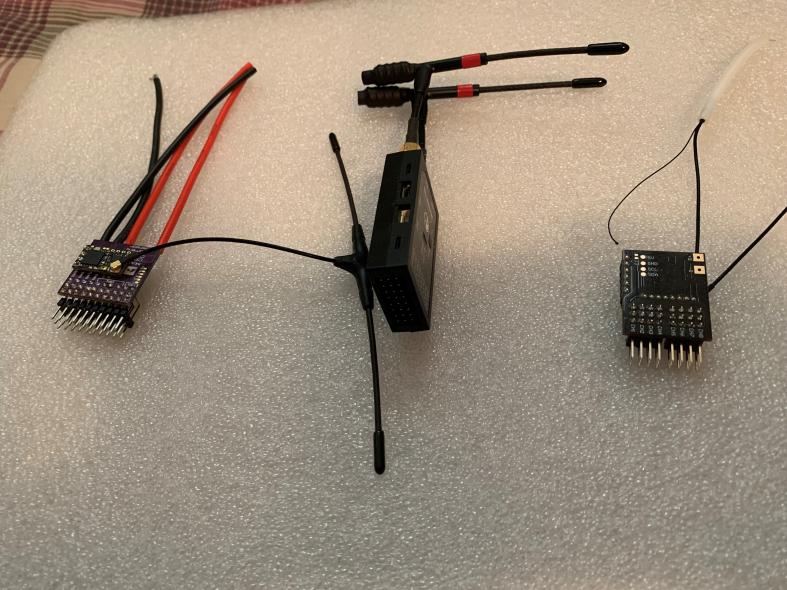

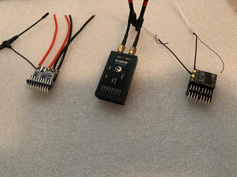

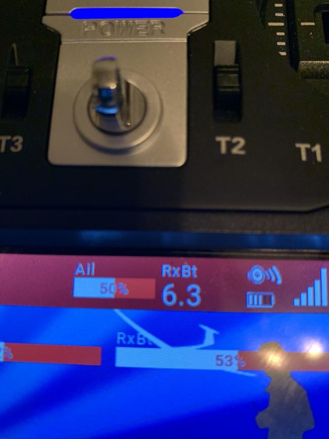

            I was testing a prebuilt 915mhz 8 channel receiver in the lake and it worked good the other week. I now bought another TBS crossfire 915mhz receiver and bought a daughter board for the receiver that can send the Battery voltage and other stuff thru the receiver to the transmitter.​ Next test will be to take the Sub down to the lake again to see if i still get the Sub battery voltage when the Sub is 2 feet down. Here is a picture of the Transmitter showing the RX voltage being sent to it from the RX..​ I also added the three TBS Crossfire receivers I am testing for sub use below.
