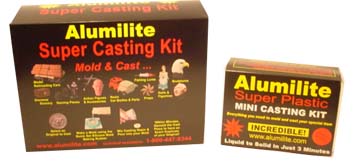

    Alumilite is what Mr. Merriman uses and he puts a blue dye in it to get the green color you refer to. (Maybe your monitor shows it green-ish?)

      Thats the stuff he uses for his fittings kits? I'm thinking of my recently assembled Revell VIIC fittings kit, where the planes and rudders are greenish. Thats the stuff right?
      Unless that Alumilite is the actual material to make the casting. I might not have asked the question correctly before.
      Thanks,
      Daniel-
        • 14014
        Alumilite comes in a slow and fast cure formula. Get the slow-cure stuff.
