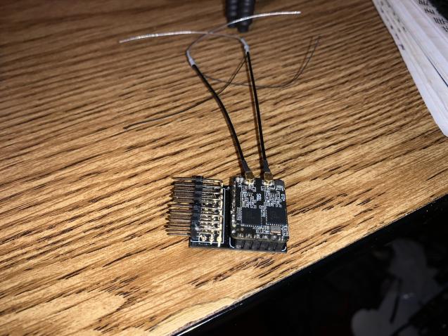

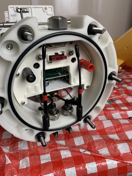

        Ok first one of my subs to be tested with a 915mhz TBS crossfire receiver will be my Neptune.

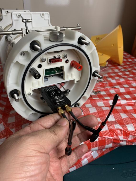

            It was one of Tim Senecal videos a bit ago that started me thinking about it. I tried to contract him to ask, what radio, 915mhz module and receiver he uses. Some people said he use some type of crossfire 915mhz stuff and some people said he uses 915mhz Express LRS stuff. I went with the best 915mhz receiver I could find and the best 915mhz module, also the most powerful, TBS crossfire stuff made for long range aircraft. Basically a drone receiver with servo inputs with 8 channels. I also bought the same TBS crossfire 8 channel receiver in a smaller form, with smaller antennas.
