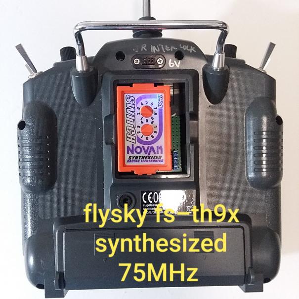

              More detailed PDF instructions translated in to English. Please note the modules in Europe have a green PCB and I believe in the US there beige.
              JR Module mod.pdf

                Wow, this is very cool. There are other 2.4ghz modern radios that also use the JR style modules, some of which are very cheap. I'm guessing this mod would work on them too. Of course you still need to find a 72/75 mhz module and receiver but it's a great way to get modern programmability with sub friendly low frequencies.
                Jason​
