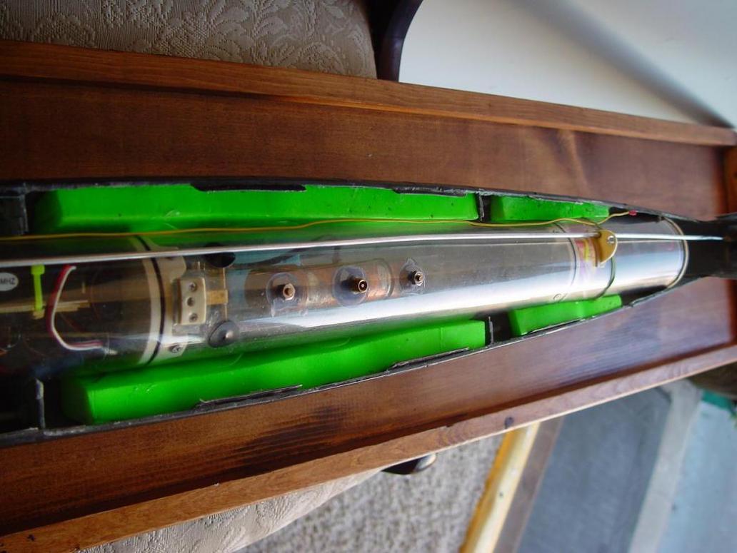

          I was the one that painted my flotation foam because it was pink i was looking for blue but could not find it. I painted it with a flat neon green it does nothing to the foam in any way it works just fine plus it's the color i wanted .Go to my gato submarine thread and you will see three pictures of it inside the hull it turned out just fine. If you like pink then live with it. personally i do not like the color. Oh what the heck heres a picture of it. I got my foam at lowes, its insulation foam used in bathrooms you can find it at construction jobs look in there dumster i see it all the time:D

            Banned
            • Jan 2009
            • 300
            #35
            I love that colour of green. If your not man enough for pink, I always say go green. ;)

                I think woman would like that color more then a guy :eek: and i wanted my submarine to show its more aggresive side. :D
