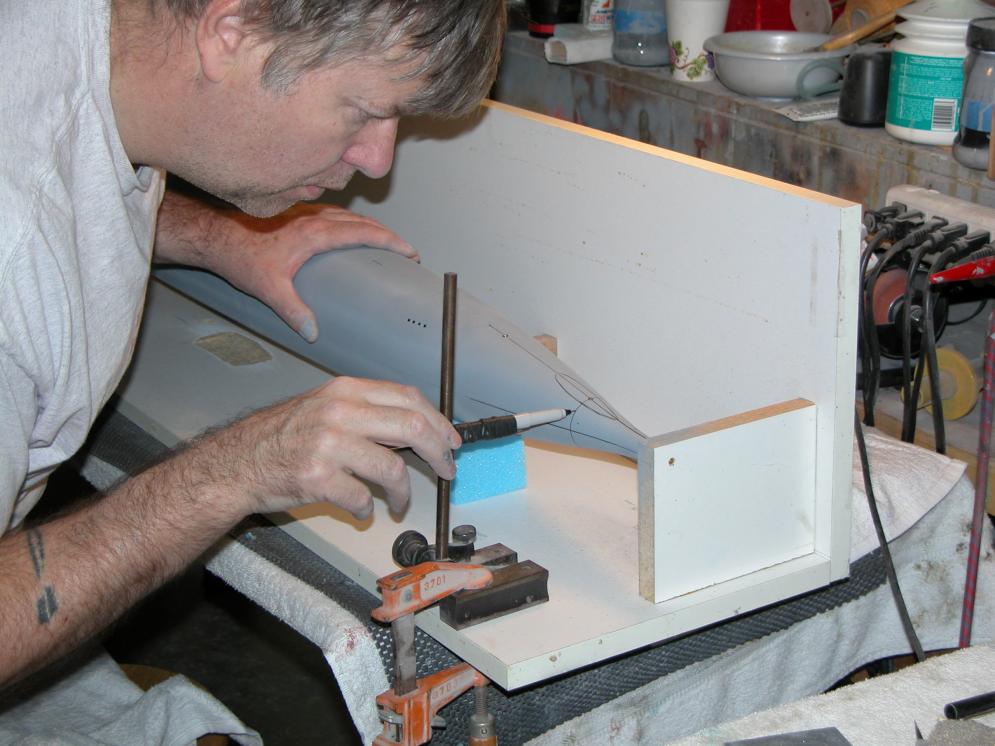

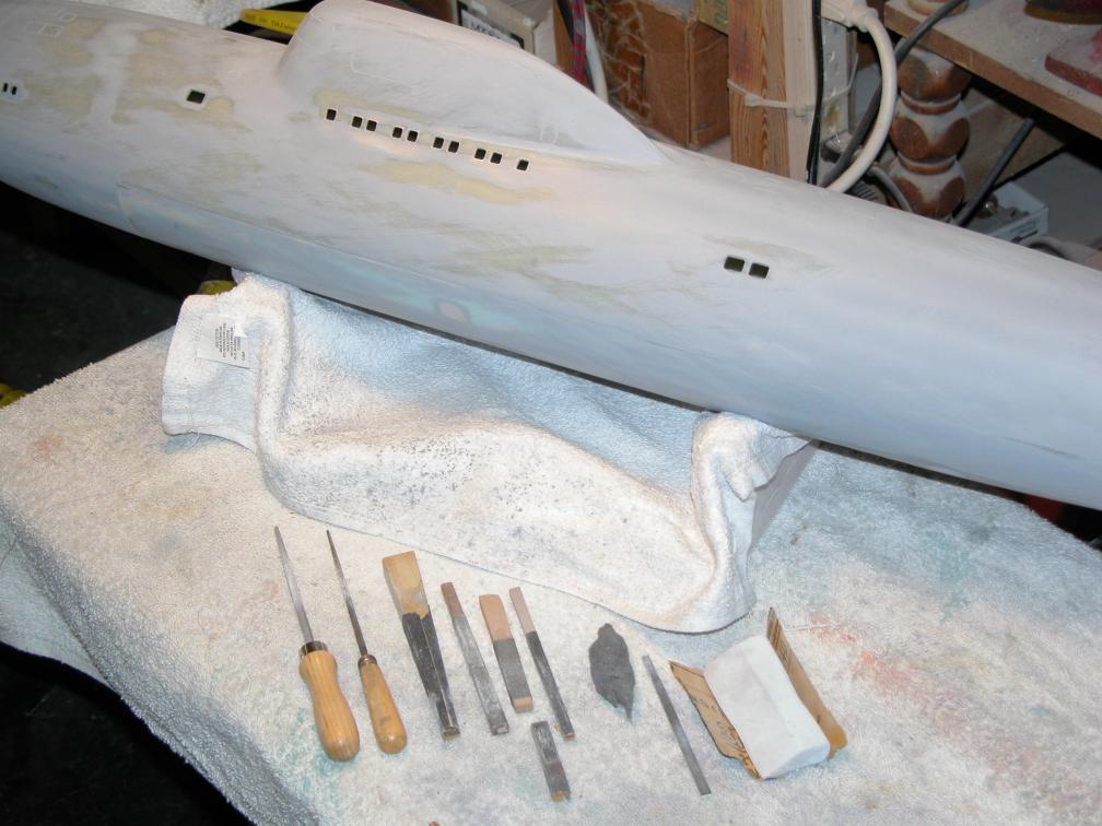

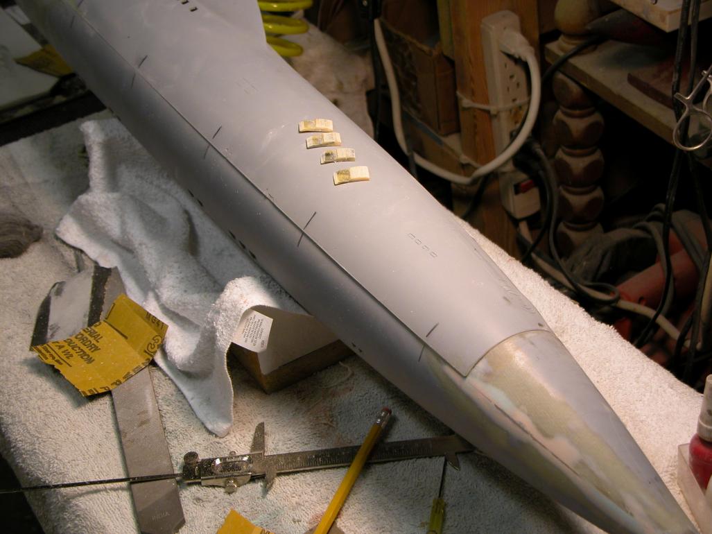

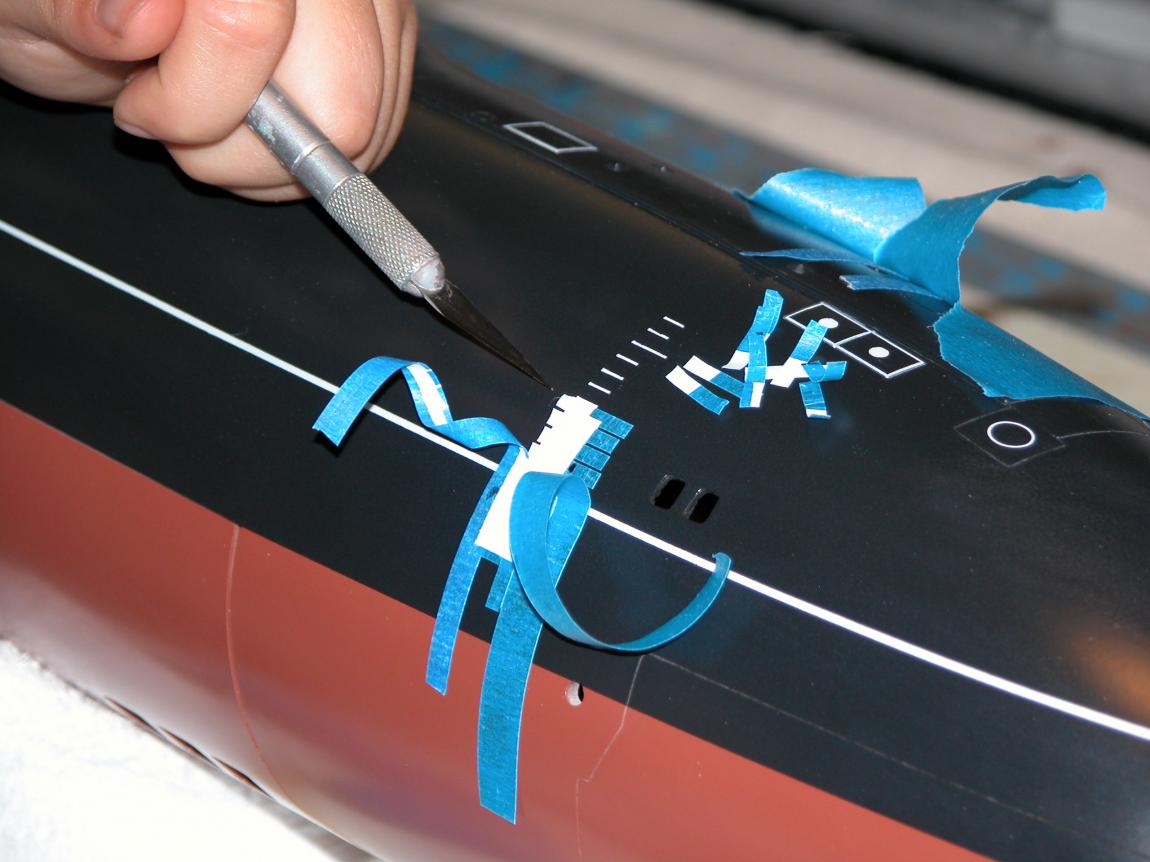

              In my movie effects days I learned the trick of using solid 60/40 soldering wire (available in a veriety of diameters) to simulate pipe and electrical conduit runs on miniatures representing compartment ceilings and walls, and building exteriors.
              I've used solder wire almost exclusively to represent Soviet style safety-tracks on 1/96 and 1/72 models. It's easy to bend, will 'give' when the item it's attached to slowly or suddenly shifts, can be worked with tools and dies to specific cross-sections and takes very well to CA and other adhesives.
              Before priming or painting the soldering wire has to be pickled with a quick pass of Ferric Chloride then scrubbed with a water-soaked rag and dried.
