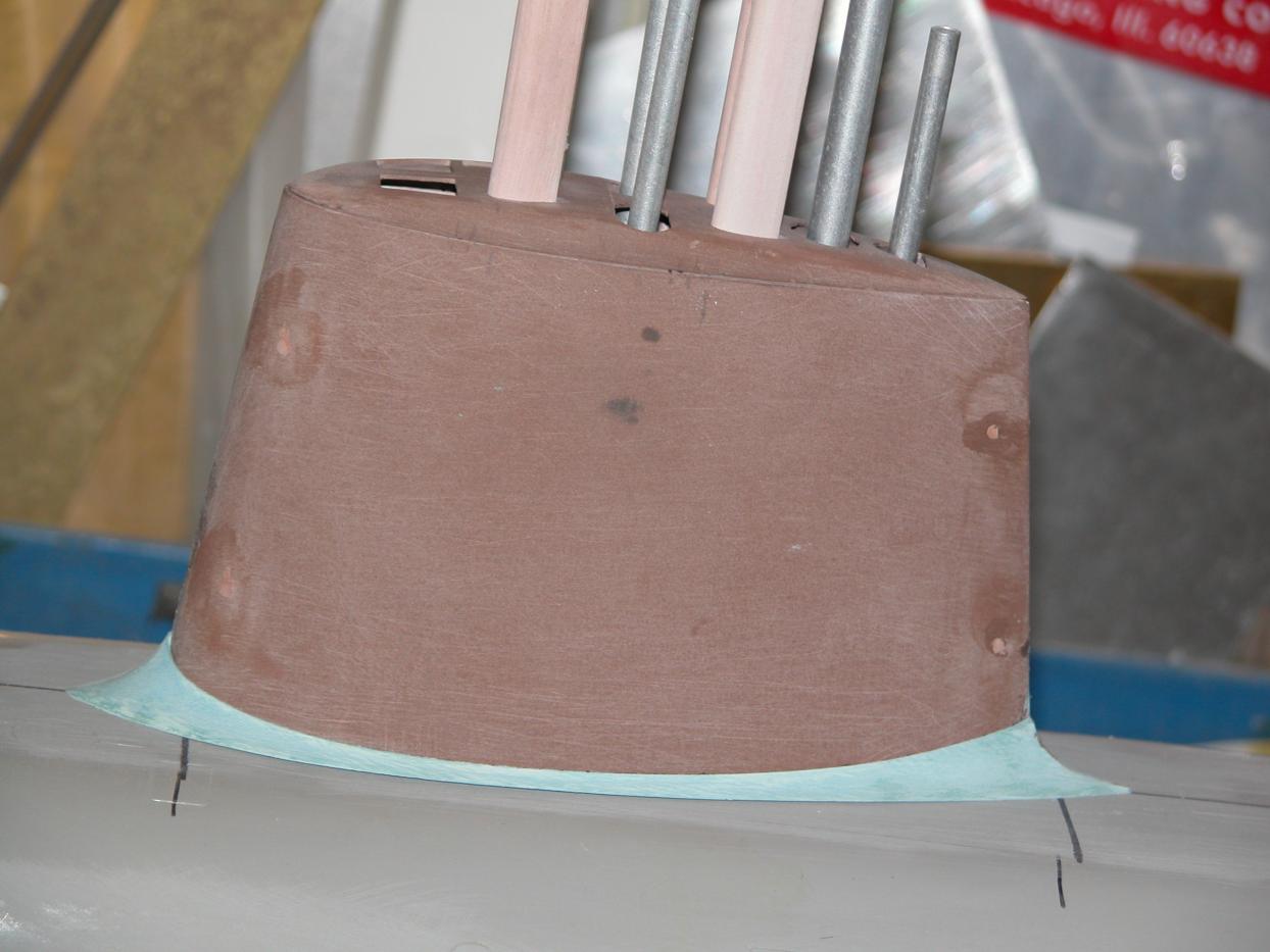

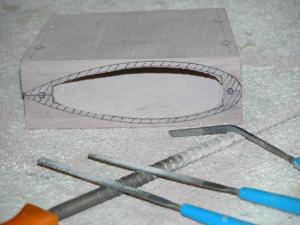

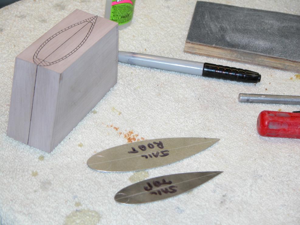

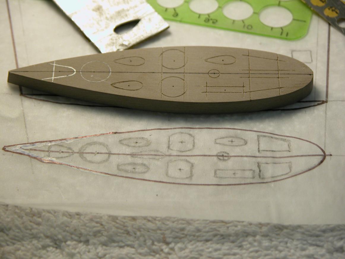

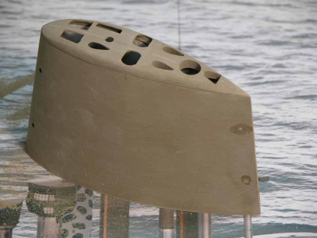

    The Jecobin drawings look about right to me. But if you want to double check, you should be able to extrapolate enough information from all the pictures I posted up on the Sub Com forum. There's a slim chance anyone here will be able to give you exact dimensions, but in my mind, if it looks right, it is right.

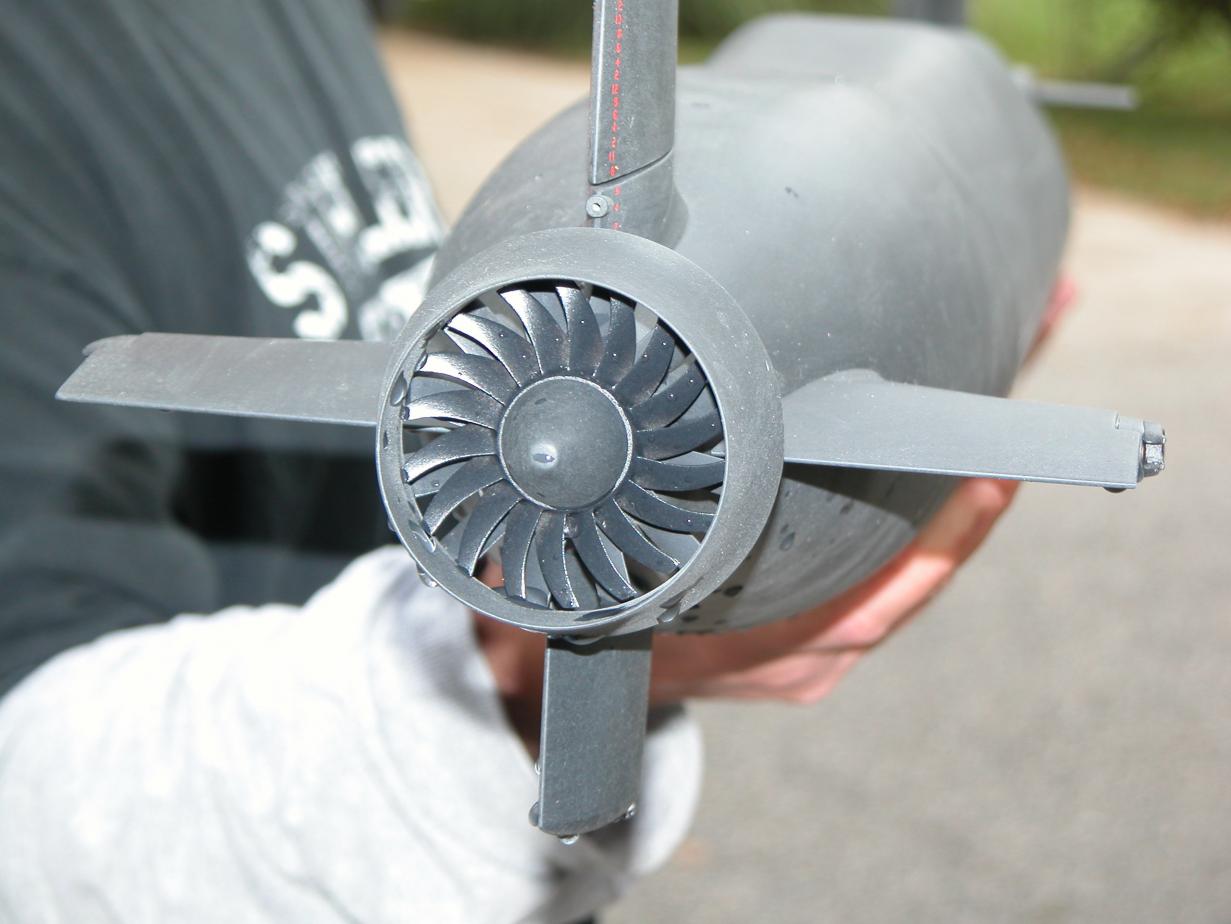

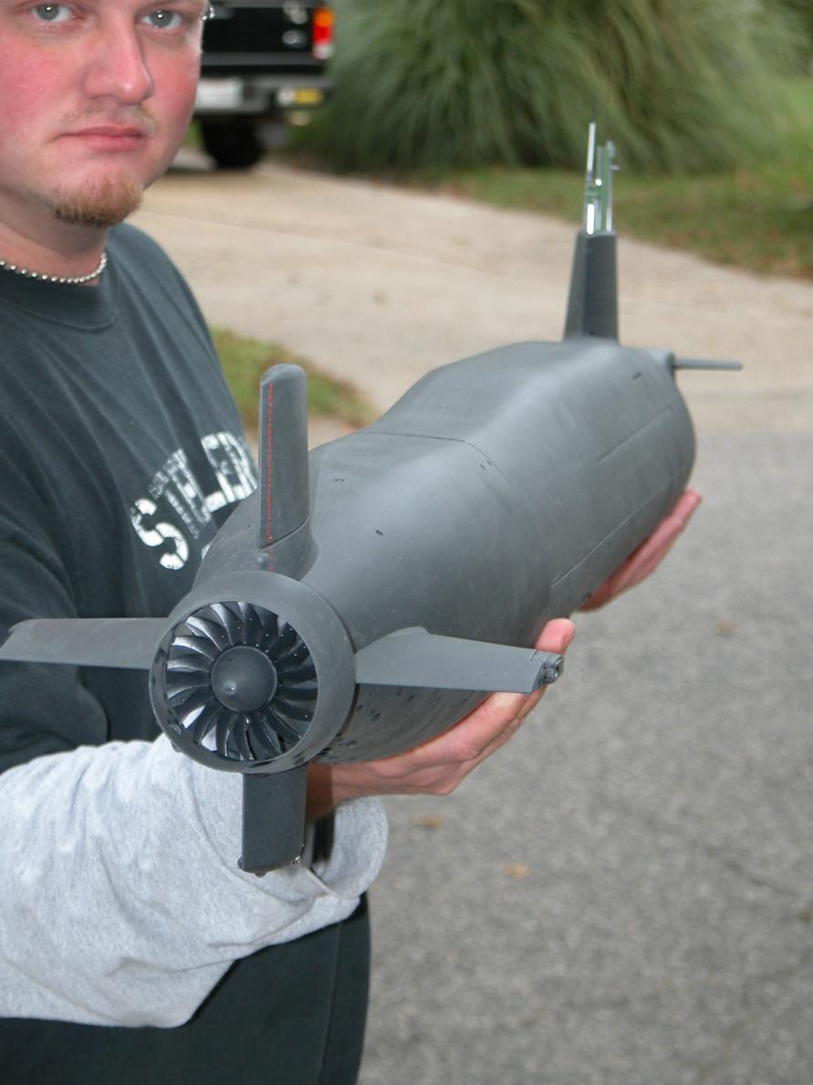

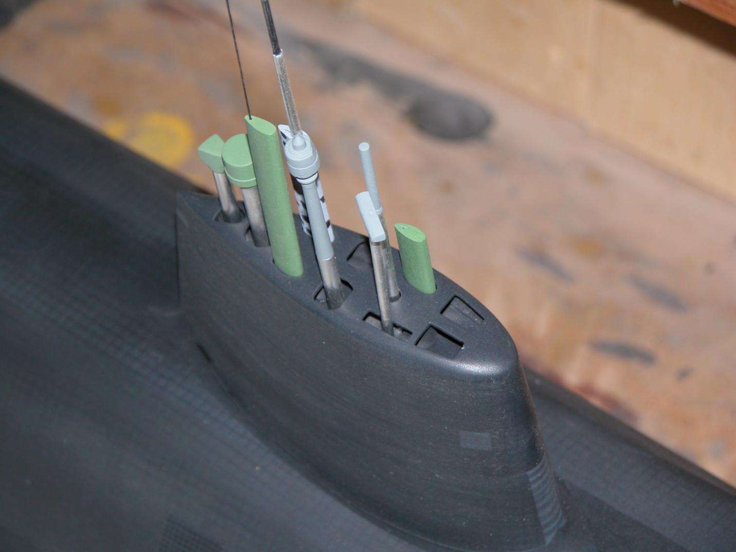

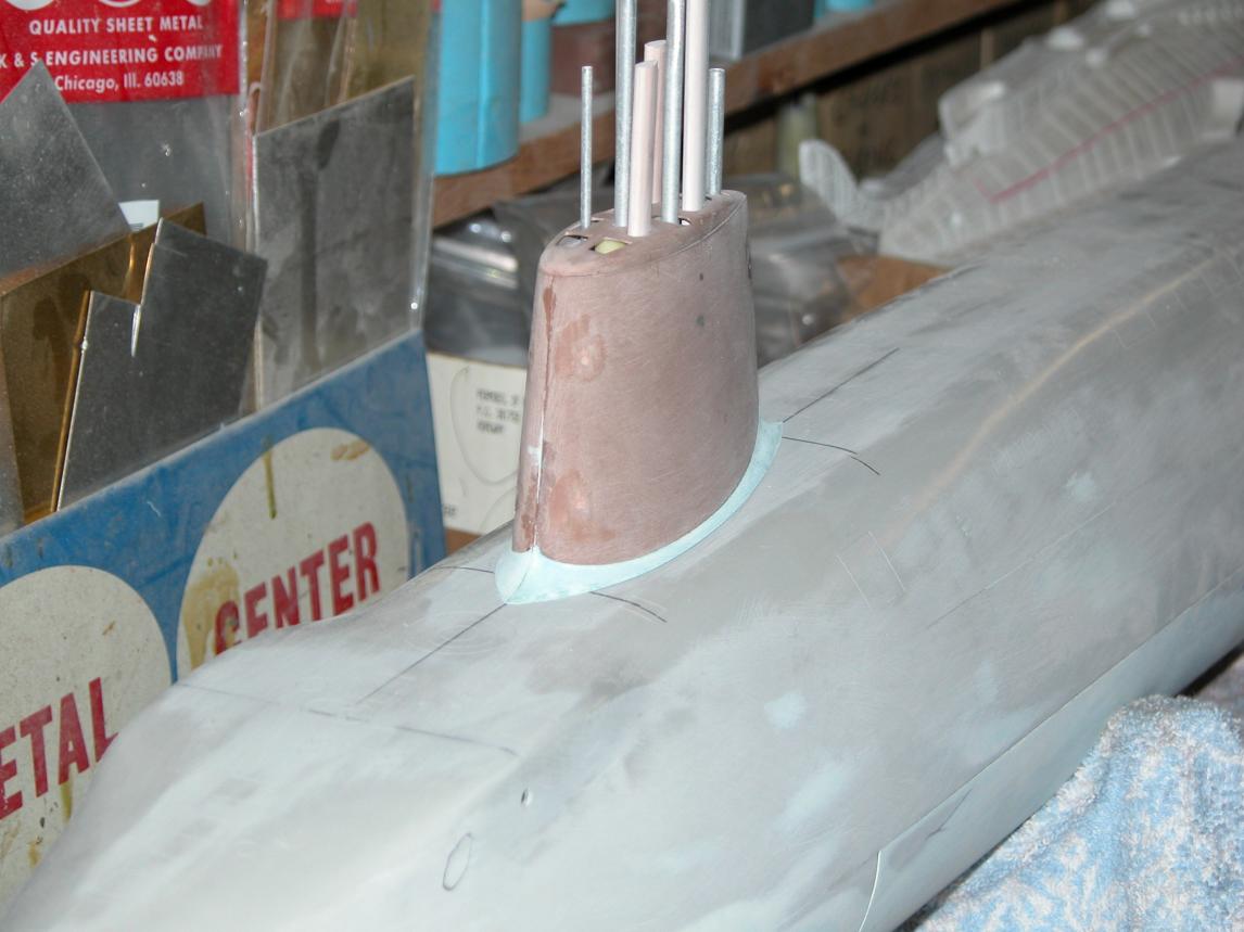

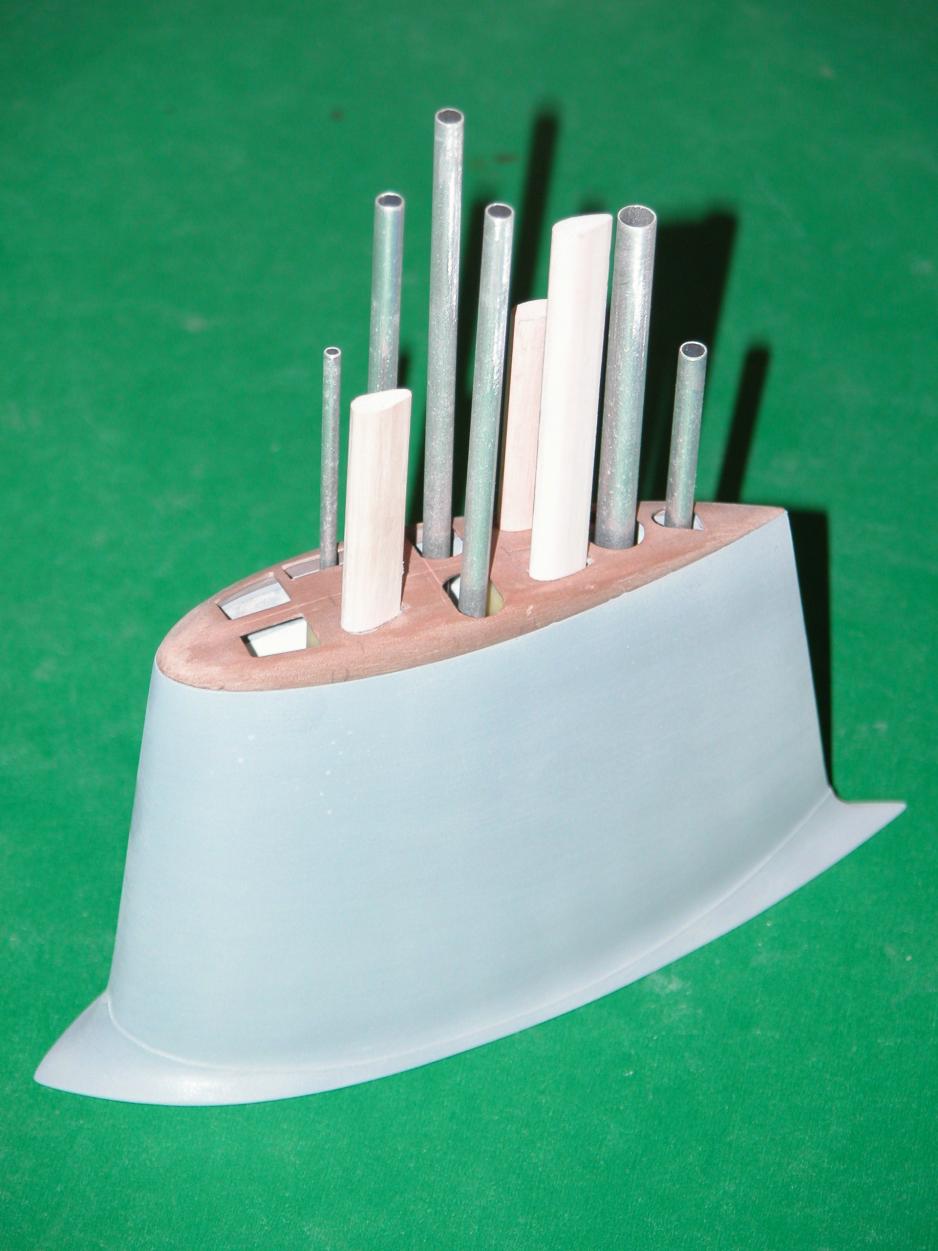

    Dave did a lovely retool of the sail for the Vanguard, which is now included with the OTW kit along with the improved appendages. The original sail was too tall.

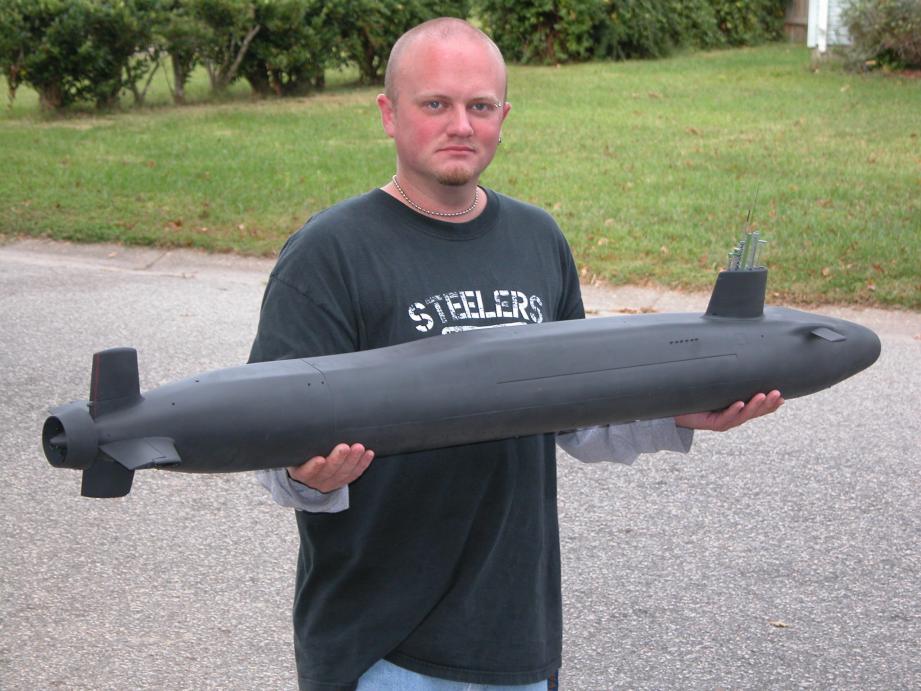

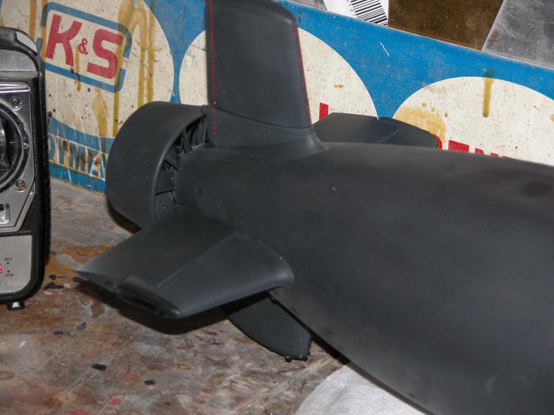

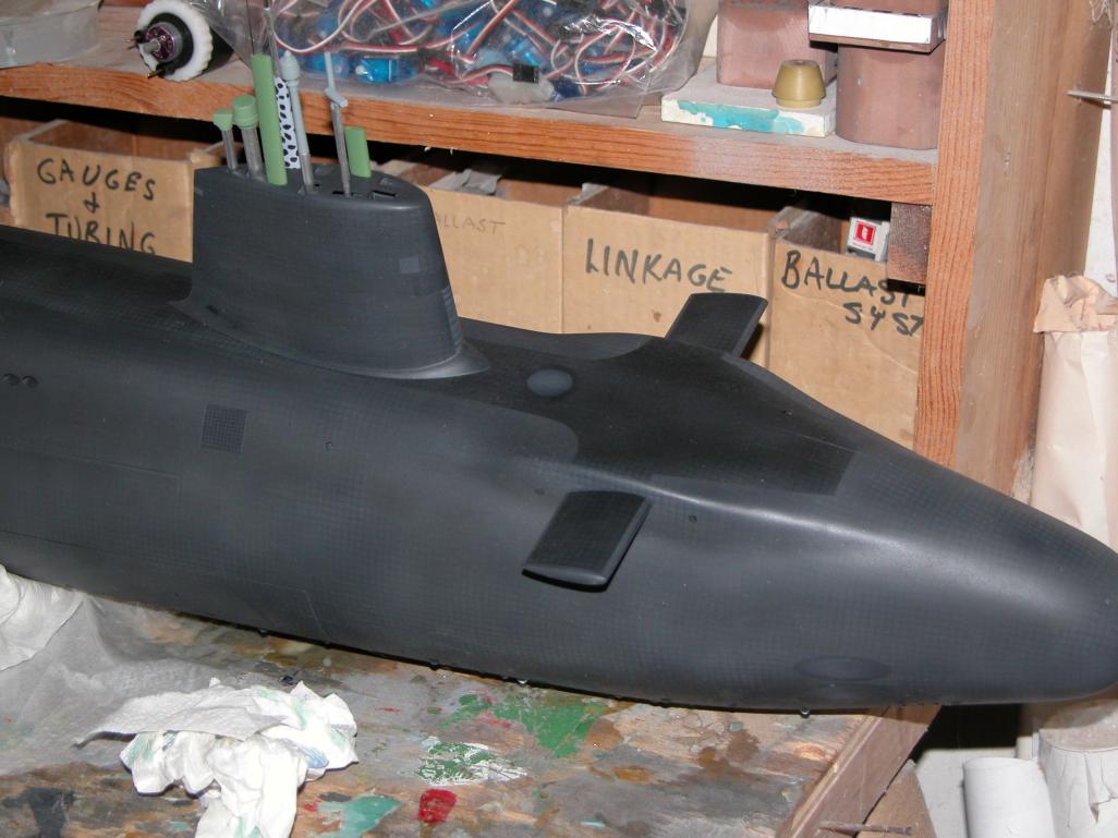

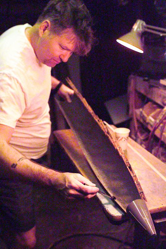

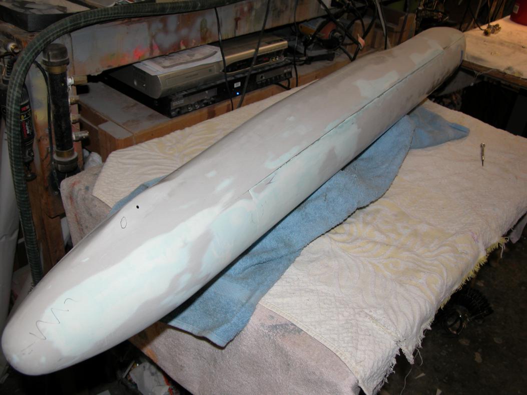

          Dave, thats the one that gave you so much trouble with the warping of the hull wasnt it? Looks like you got it all straightened out. Who was the manfg.? OTW?
            • 13968

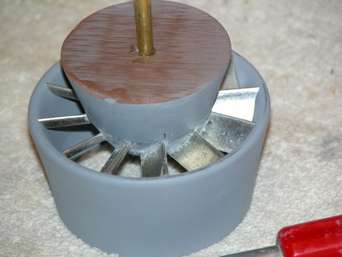

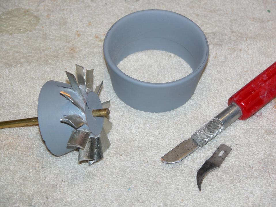

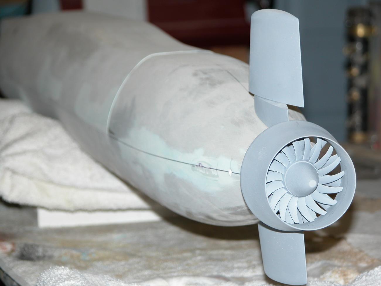

            Mark,
            The warping of the OTW VANGUARD hull was all my fault:
            As delivered, both halves of the hull have a big inside flange at the longitudinal parting line, this inboard flange works to keep the hull halves warp-free. But, at the time -- being the unthinking-hack-and-slash-idiot I'm sometimes famous for -- I cut those stiffening portions of the hull halves out. Initially, everything worked out fine and I got a near seamless fit between the two halves when they were assembled.
            Two months later ...
            ... the two hull halves bowed out. Awful!!!
            I spent two weeks building up, installing, and re-working the matting surfaces of the two hulls.
            The moral of this horror story: Don't mess around with a fine product!

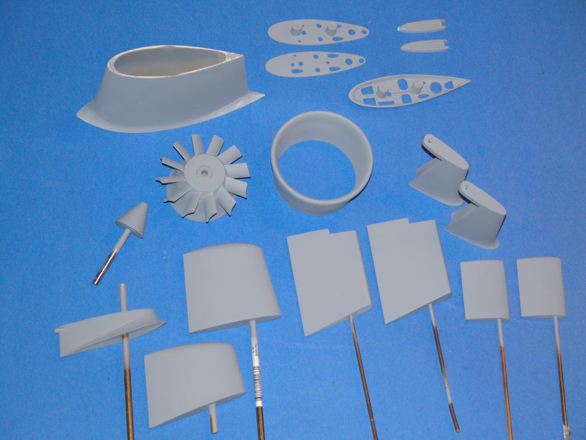

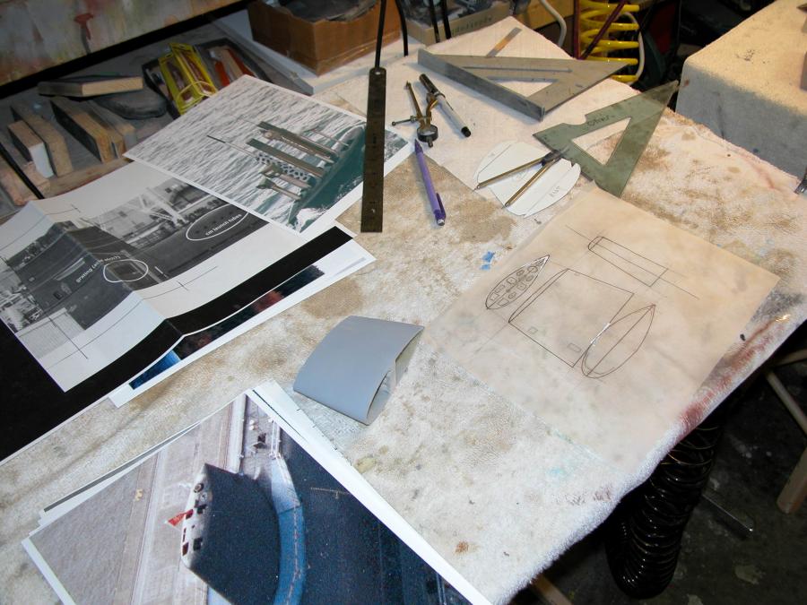

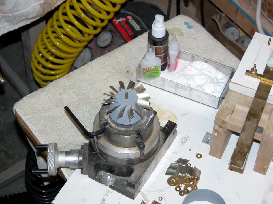

            However, I did make an entirely new appendages set for the 1/100 OTW VANGUARD kit and sent those tools to Bob as an upgrade to the product.
