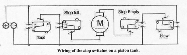

    Straight away I noticed the piston tank didn’t function how it seems it should. Well not at all. I suspect there might be an issue with the wiring to the micro limit switches. I checked the schematic that came with the kit but I don’t trust it as I have already found a number of errors in the assembly drawings. I cross referenced the wiring with photos I found on the interwebz and sure enough it wasn’t the same.
    Does anyone have a functioning Arkmodel piston tank set up that can post a photo of how the micro switches are wired? Would like to double check that against what I’m seeing with the setup I have.

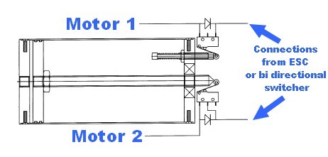

    Nothing for that particular tank, but they’ll just be limit switches and there’s only a few ways they can be wired depending on what you are using to control the tank motor and whether you want to slot the high or low side.

          Thanks guys for your replies.
          UPDATE: managed to get it sorted out this morning. Piston tank is functioning properly now. The wiring was incorrect and the wiring diagram included with the BCU is incorrect.

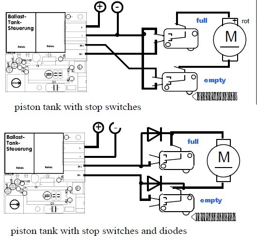

            Andy, who's piston tank board is that you are sharing?
              That's one of Norbert's boards.
                Do you like his boards?
                  I prefer transistorised boards. Markus Rieger are good, but pricey, not sure about present availability. Pololu do some nice servo boards. You can also use servo amplifier boards for smaller tanks (about 50mm 2" diameter).
