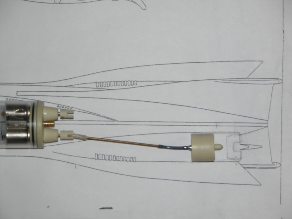

    Rule one in running gear is to isolate the motor from any axil loads -- ahead and astern -- presented by the propulsor. The only load that motor should see is torque.
    Absorb the ahead and astern loads at the propeller shaft, either near the propulsor itself, or forward where the propeller shaft interfaces with the motor or intermediate shaft.

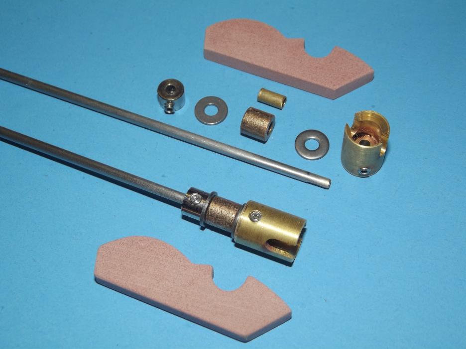

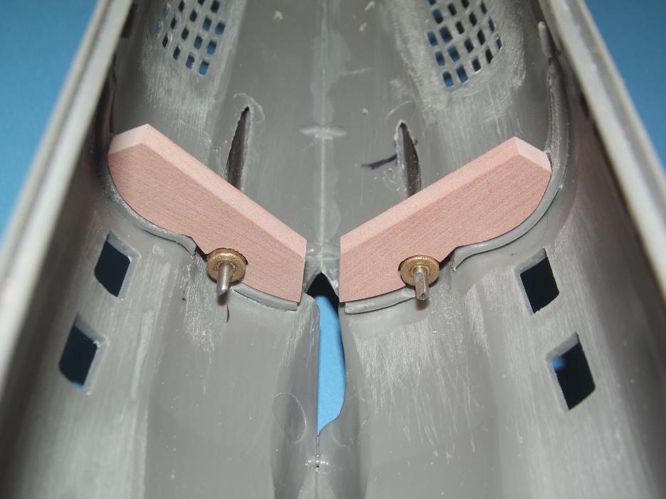

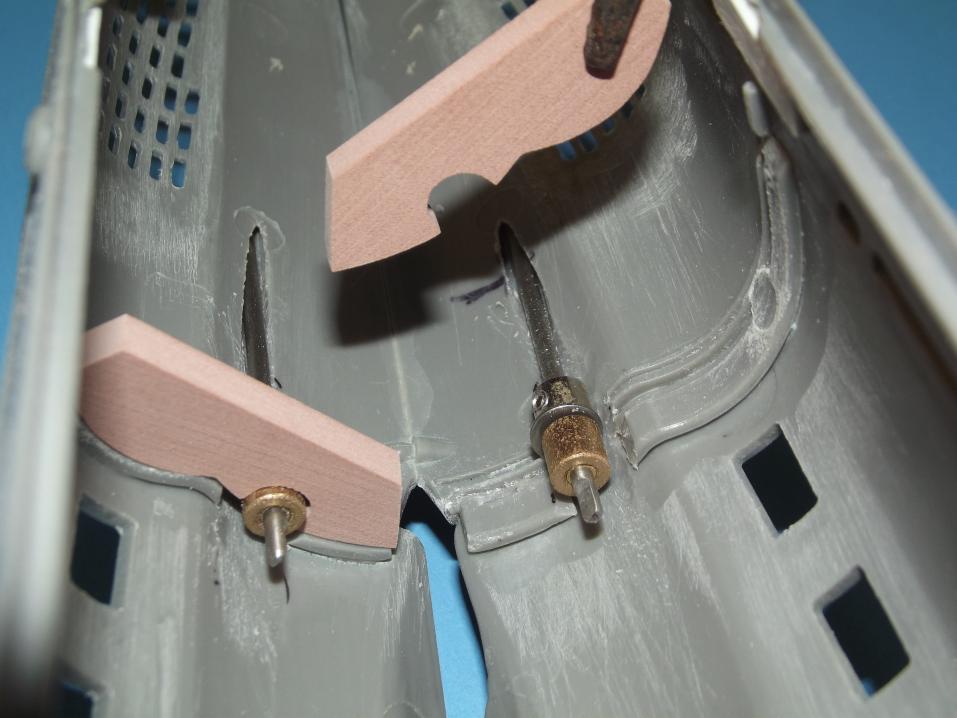

    In this example the propeller shaft is supported laterally and axially by flanged Oilite bearings set into the stern of the model:
    Click image for larger version  Name:	DSCN0032.JPG Views:	0 Size:	68.7 KB ID:	143527
    Stainless steel washers between the Oilite flange and propeller hub (the ahead thrust bearing), and the Oilite flange and Dumas coupler (the astern thrust bearing) when lubricated with silicon grease produce a low friction bearing surface between stationary and rotating elements of the running gear.
    Click image for larger version  Name:	DSCN0055.JPG Views:	0 Size:	59.7 KB ID:	143528

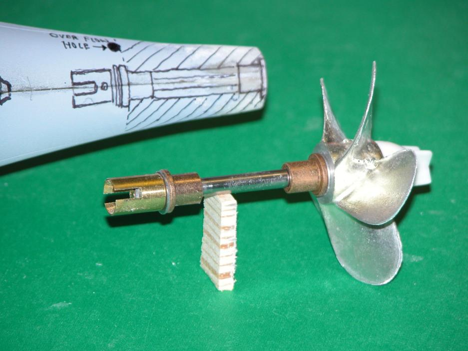

    Or, you can use a single Oilite bearing, glued into a suitable foundation, at the forward end of the propeller shaft, and secure the shaft from axil motion by the Dumas coupler aft, and a wheel-collar forward. In essence you're sandwiching the Oilite bearing between the two rotating elements of the running gear. Again, use stainless steel washers to reduce rotational friction.
    Click image for larger version  Name:	DSCF8200.JPG Views:	0 Size:	65.4 KB ID:	143529Click image for larger version  Name:	DSCF8201.JPG Views:	0 Size:	60.2 KB ID:	143530
    The Dumas universal coupler (coupler-dog bone combination) delivers only torque, not axial force between motor and propeller shaft.
    Click image for larger version  Name:	DSCF8208.JPG Views:	0 Size:	61.1 KB ID:	143531

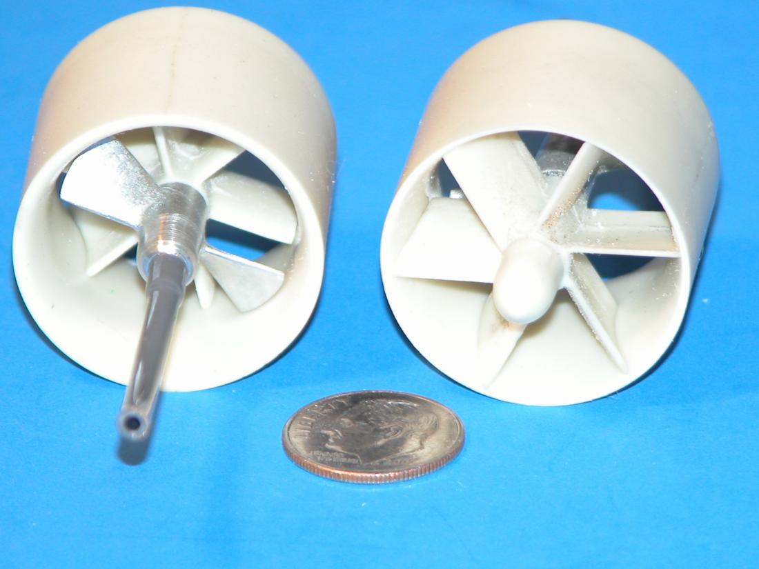

    Or, in the case of this pump-jet, the axial force (thrust force fore and aft) is handled in the Oilite bearings set within the stator hub.
    Click image for larger version  Name:	DSCN0076.JPG Views:	0 Size:	70.8 KB ID:	143532Click image for larger version  Name:	DSCN0069.JPG Views:	0 Size:	51.8 KB ID:	143533Click image for larger version  Name:	DSCN0084.JPG Views:	0 Size:	37.3 KB ID:	143534
    I recommend 3/16" diameter SS shafting for a model this size. You'll find both the shaft stock and Oilite bearings at the McMaster-Carr site.
    Go get 'em, Tiger!
