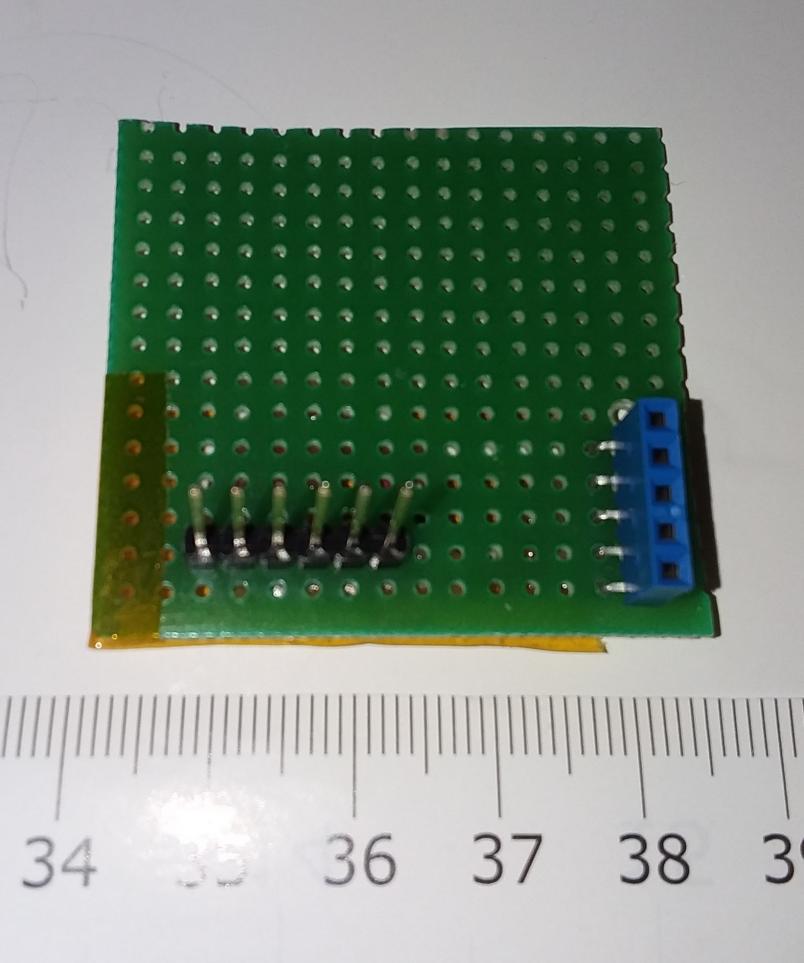

        one cheap arduino 6 channel DIY ppm OK (+)
        transmitter with Futaba RF bay.
        WILL Have to replace the pins in the RF bay to make it fit.

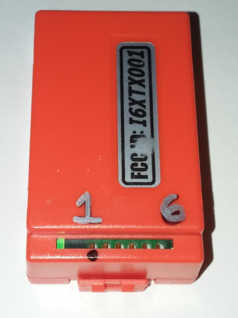

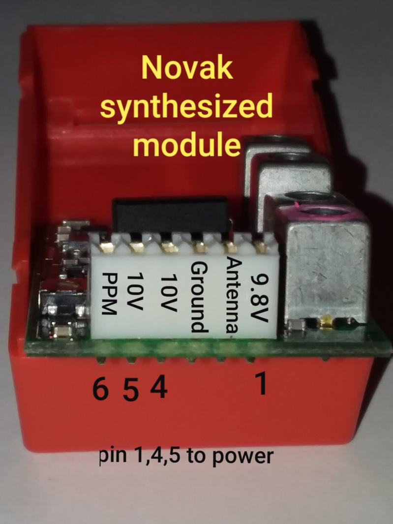

          Forget the pinout of the Novak module.
          some how the Airtronics module smoked one of my old JR transmitter.
          THIS is based on Airtronics M8 transmitter
          1. 9.8V
          2. ANTENNA
          3. GROUND
          4. 10V
          5. 10V
          6. PPM SIGNAL

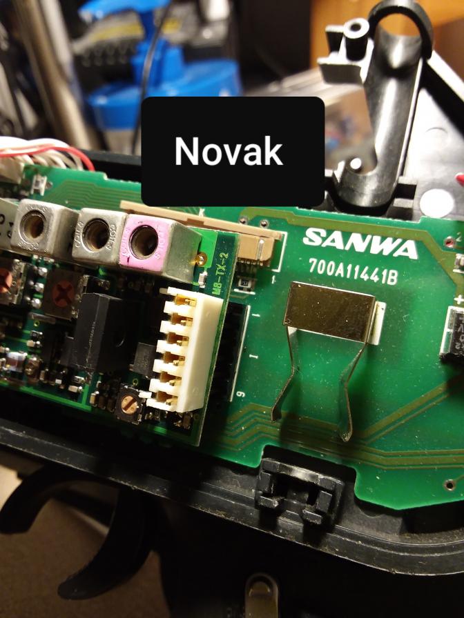

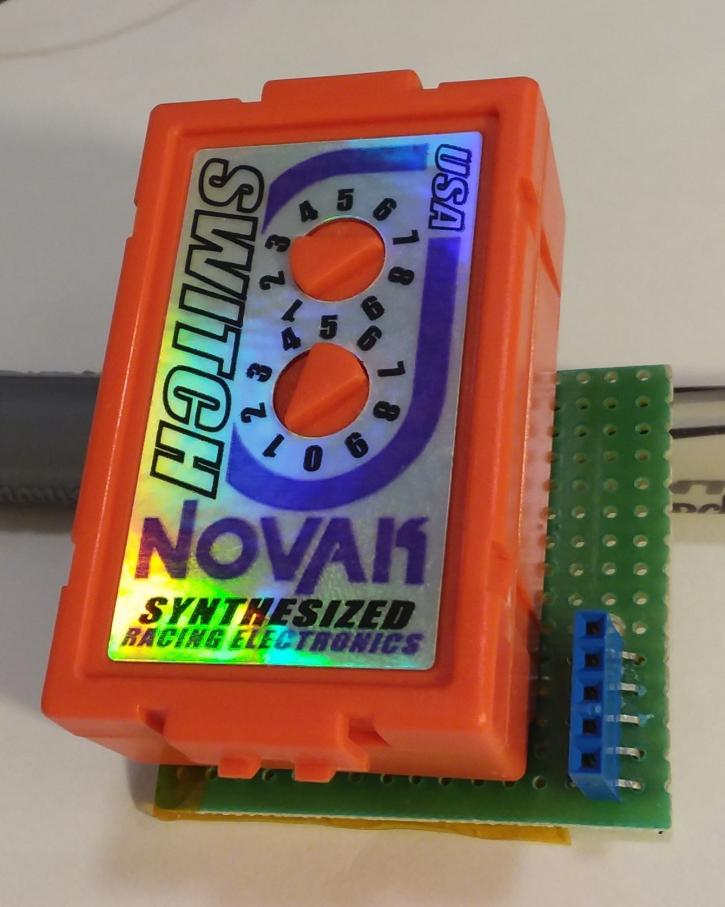

                    Kim Sleep ask about the futaba RF module.
                    I am try to get everything at one place.
                    The Novak turned the futaba single to (+) shift so now work with JR receiver, have to add a single inverter. For the futaba Rx to work.
                    Trimming inside of the module bay for pin alignment. A new pwb ...
                    Hitec Prism 7 is easier, reprogram the shift, replace the small pwb.
                    Thinking try to find a way that you could use the standard module and synthesized module.
