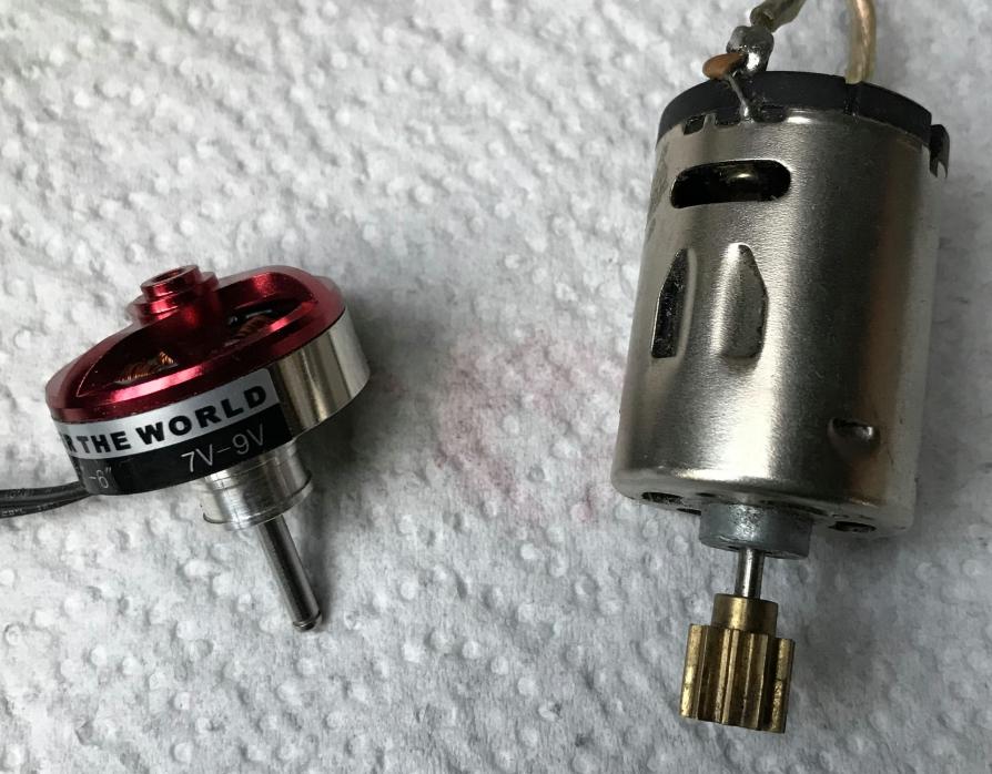

                      Watt for watt, brushless motors will produce a bit less heat than their brushed counterparts, as you have no friction generated from brushes and commutator. The difference is going to be minimal at lower power levels however.
                      Most model motors tend to have efficiencies of around 60-80%, which means about 20% of the power you put in is lost to resistance in the windings and friction. Clearly if your boat is using say 10-20 watts, it's nothing much to worry about, but if you're pushing 100 watts or more, you need to start thinking about some additional cooling- this would apply to any electric motor brushless or brushed.
                      A lot of marine modellers seem to equate brushless with power, well they can certainly deliver that, but do you need it? If not size the motor a bit more carefully, a brushless motor of equivalent performance to a brushed motor will be much smaller in size.
                      The 28mm outrunner motor on the left here offers twice the performance of the speed 400/380 on the right, yet takes up much less space, with no nasty electrical sparking to compromise your radio and costs about four pounds. It can spin a 27mm prop direct drive at around 21000RPM, suitably geared it can swing much larger props, and has sufficient power (about 100watts) to propel most model submarines unless very large. I use these with 20A rated controllers.
