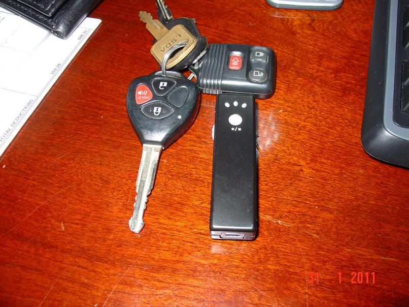

    Hello John:
    I got this camera and movie camera from Nitro planes. Cost $ 19.90 US. It requires a micro chip for operation. I believe my chip is 8g. As you can see it's real small. Very light. Not real sure how you would water proof it. Takes great movies. I attach it you my RC 450 B400 helicopter or attach it to my hat to record the helicopter. It might work as a sub camera?

      Thanks-
      when you say micro chip do you mean memory card?
      Also does it plug into you computer via USB connection / cable?
      Thanks
      John

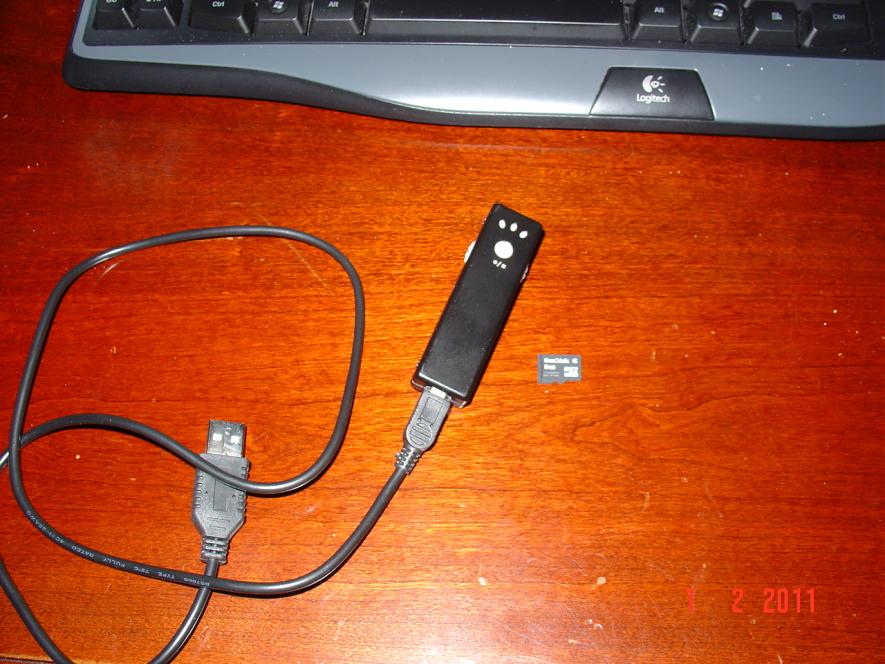

                Sorry - I fell asleep on this post. Yes - The camera has a usb plug into the computer. I has a sandisk that goes in the side. The Micro SD is the real expense. I think it was $ 39.95. The camera was only $ 19.95. Works great.
                Plugging into the computer's USB port is also the way to charge the camera's battery
