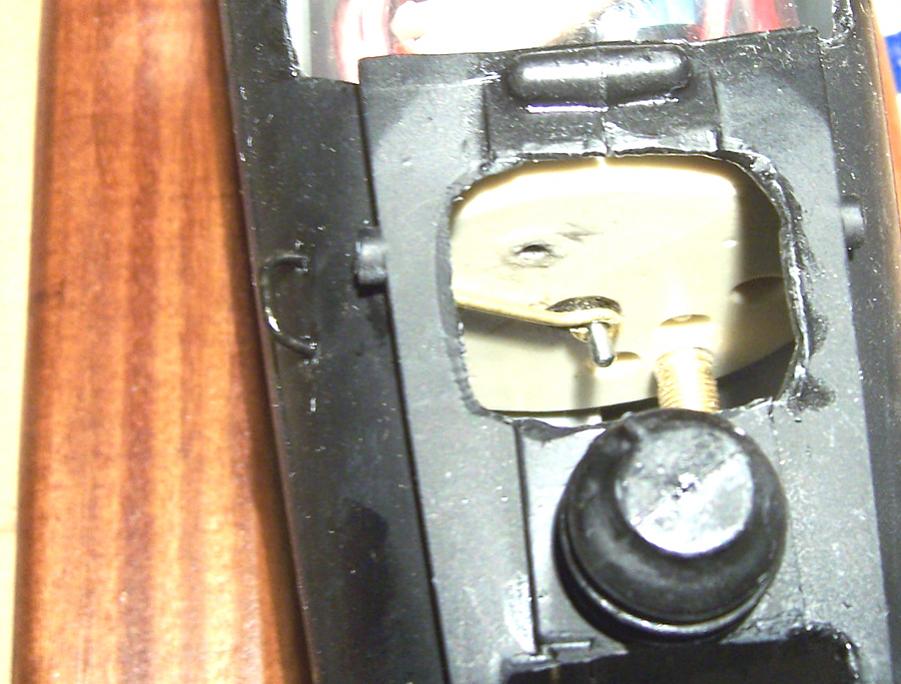

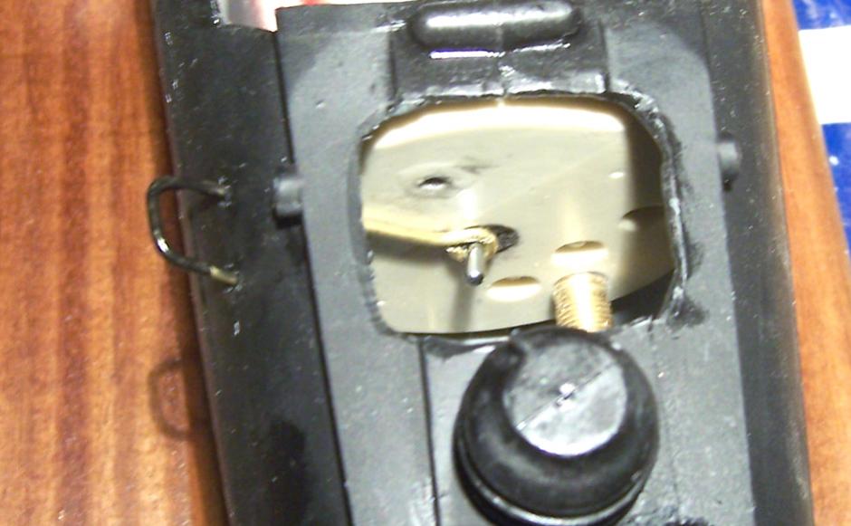

    I was able to make a simple looped push-pull rod to slip over power switch to turn it off/on.
    Where rod goes thru hull it is bent into a U shape, then goes into another hole in hull, to lock it in place. This allows the rod to be almost completely removed, so it won't interfer with installing the SD, which has to be pushed past the rod, to engage shaft-couplings, when installing SD.
    It slips over the switch easily but does Not slip off when actvating switch, since the U-bend holds it tightly. :)
    See Pics: (first is in Off position, 2nd is On)
    Notice the black U-shaped wire protruding thru hull. That is all that is seen on outside, just at bottom of superstructure.

                      like the way you ran on /off switch will be next project on my gato
                      hate pulling top to turn on and off
