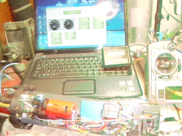

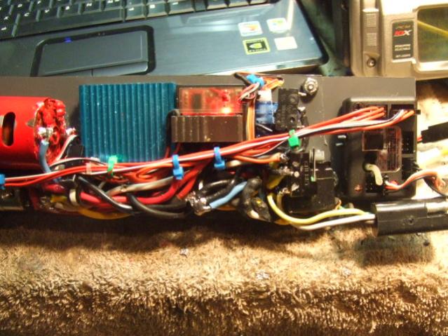

    I installed mine in the XXI today it took me not even 15 minutes to hook it all up and another 10 to program it on my laptop,the soft wear is superb and easy to use.
    Even the combined readouts can be seen on any video system with another unit installed.
    What I have done is to monitor the right motors temperature the same side ESC temp and prop RPMs along with the entire subs electrical usage,one can monitor just say the one motor electrical input but by simply installing the "ring" sensor at the negative or positive main power leads ,there is no splicing by the way its a hall effect sensor,sweet indeed,the entire sub is covered,how because as say a pump comes on the power comes from one place and as one uses other systems it simply increases its digital read outs,even accumulated mahs are displayed.

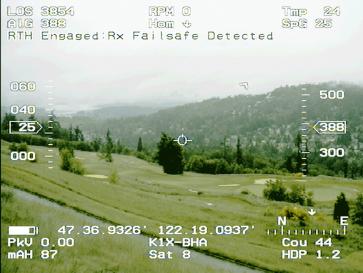

    Lots of these important parameters can be displayed in either classic Gage or in a large digital readout on your laptop,but while in Dashboard mode only in digital Read outs with 3 letter tags you set up individually say "MTA" or motor temperature A,the screen has 8 different screens to set up as you like and if there is an alarm it automatically goes to that screen and beeps!
    One might say well we have to much alClick image for larger version

ID:	100565ready to worry about or its to complicated not so,it simplifies and spells out what is going on in the sub no guesses or hoping that the thingClick image for larger version

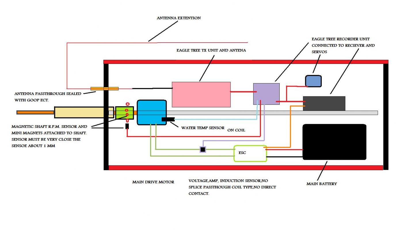

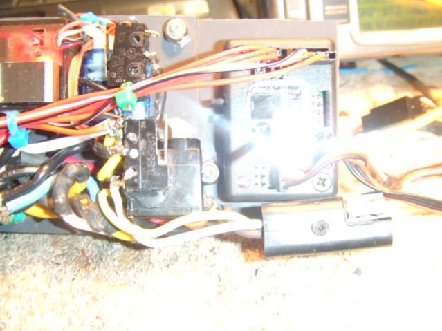

    The servo like box on the end of the tray with the wires connected to it is the recorder then there is a TX unit that connects to it all are nice and small light waight units with all the necessary markings so that there is no guessing what goes where.The wires usualy 2 or 3 to each sensor plug in like servos to a reciever easy as that!Install the system once all of the subs systems are installed and just follow the easy steps to get it operational,remember it will not interfear with the radio but check it anyway,so far I have no problems.
    Dave Amur Sub Yard
Name:	EAGLE TREE DIAGRAM.jpg

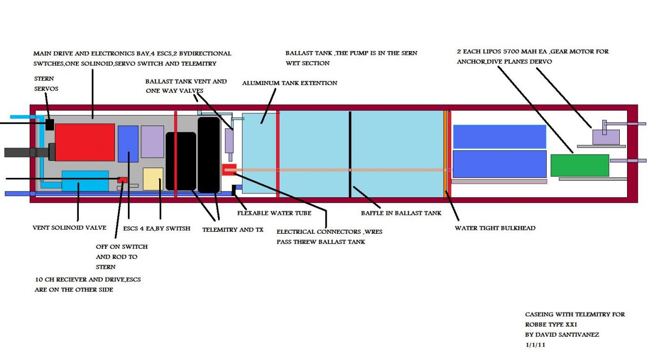

                A diagram of the casing with Telemetry for the XXI.
                Now the fine tuning and testing begins with the completed unit, so far very good results, no glitching and all functions working.
