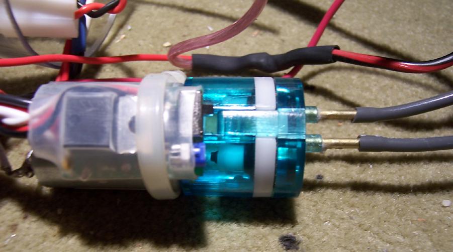

      I moved the 2 air-line tubes to forward-bulkhead and installed and sealed the power-switch but when connecting flex-tubing between forward-bulkhead and snort-pump I found that the pump's inlet and outlet ports are larger than brass-tubing provided in bulkhead, (flex-tubing did not fit pump).
      So I'm thinking about drilling out the pump-ports slightly and CA gluing some short pieces of brass-tube inside the pump ports to reduce diameter and to lengthen them, since the pump ports are also very short?
      Is that the best solution?

        Bad idea!!! You get any shavings into the ports and they get at the check-valves within. Game Over!
        Heat a 3/32" diameter brass pin and stick it momentarily into the end of a piece of flexible hosing, repeat till you enlarge the inside diameter of the end of the flexible hose till it will fit over the nipple of the LPB compressor with just enough interference fit to assure it stays there -- experiment first on a discarded piece of flexible tubing.

          Okay, I'll give it a try. I was afraid a hose may come loose and pump the battery compartment full of water, doing it that way. :(

              I tried heating and stretching the flex-tubing but just couldn't get it correct, either too tight or too loose. So I went with my original plan. Drilled the pump ports with drill-bit in a pin-vise (no power drill), did it slowly and carefully, to make sure nothing got into pump. The plastic is very easy to drill by hand. Brass tubes fit perfectly and I think 'It's Good to Go'. :)

                  I put a couple pictures of the modified pump in the 'Builder Threads' forum.

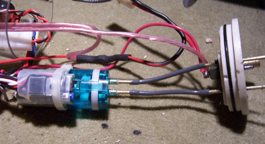

                    I went ahead and uploaded the modified Pump pictures here also.
                    (I don't know why they wouldn't upload here before ???)
                    Click on Thumbnail pics:

                      I desided to use brass tubing for most of the air-lines to and from Snort-pump. With 2 short pieces of flex tubing connecting them to SD. Outlet tube RTVed to bottom of SD and Inlet tube is RTVed to top of SD. There will be another short piece of flex tubing at upper end, were it goes into sail, which will make it easier to feed in, when installing deck-assembly/cover.
