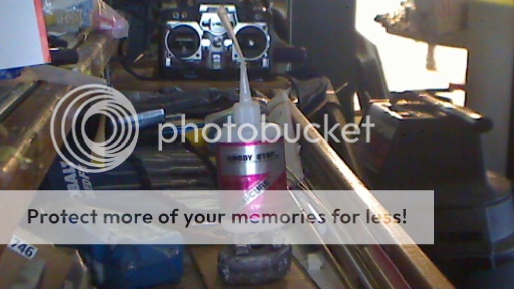

Ever have trouble metering just a small drop of thin CA? Usually you get too much and make a mess. You might want to try these. Tiny hole at the end of the straw helps keep CA from coming out when you turn your CA bottle upside down to try to get in somewhere tight. The answer to many modeling problems.http://www.ebay.com/itm/Superglue-Mi...&_trkparms=aid

I use these also. I use them as a plug in the CA top and when I need to use CA, pull it out of the opening and let the CA run down the small tube to the area needing glued and/or spread it around using the small plastic end and re-plug the CA glue bottle with it.
Doesnt the CA "stick" to the little fragile tube and cause it to break off down inside the bottle?9 August 2016
I use these also. I use them as a plug in the CA top and when I need to use CA, pull it out of the opening and let the CA run down the small tube to the area needing glued and/or spread it around using the small plastic end and re-plug the CA glue bottle with it.IT TAKES GREAT INTELLIGENCE TO FAKE SUCH STUPIDITY!Comment
10 August 2016
No, but after about 9 months of pulling it in and out of the bottle the tube has started to bend and/or I have bent the small tube some way and/or it may be the big glob of glue on the end of the bottle nozzle that makes it sorta hard to get back into the nozzle. I still think it makes for a good cap for the CA bottle and you have something handy to pour the glue down (against) if needed.
