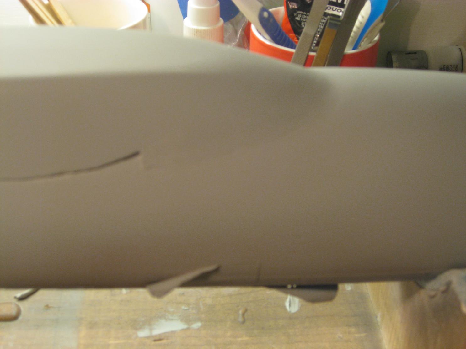

      Here's what I've done so far but I'm not happy with it. The intersection of the superstructure with the hull is not a nice clean line as I recall you did with the OHIO.
      • SSBN659
        • 418
        OK, I went to You Tube and searched on Copeland and Ohio. "Ohio 10 Model Submarine Build Define Hull & Deck" did a good job showing me what I'm looking for.
