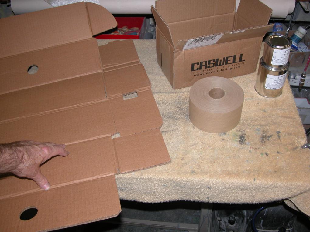

    Just got a first-run heavy-duty grade custom cardboard box from Mike yesterday -- first in a line of different sized 'generic' boxes specifically designed for the r/c target and submarine Driver in mind.

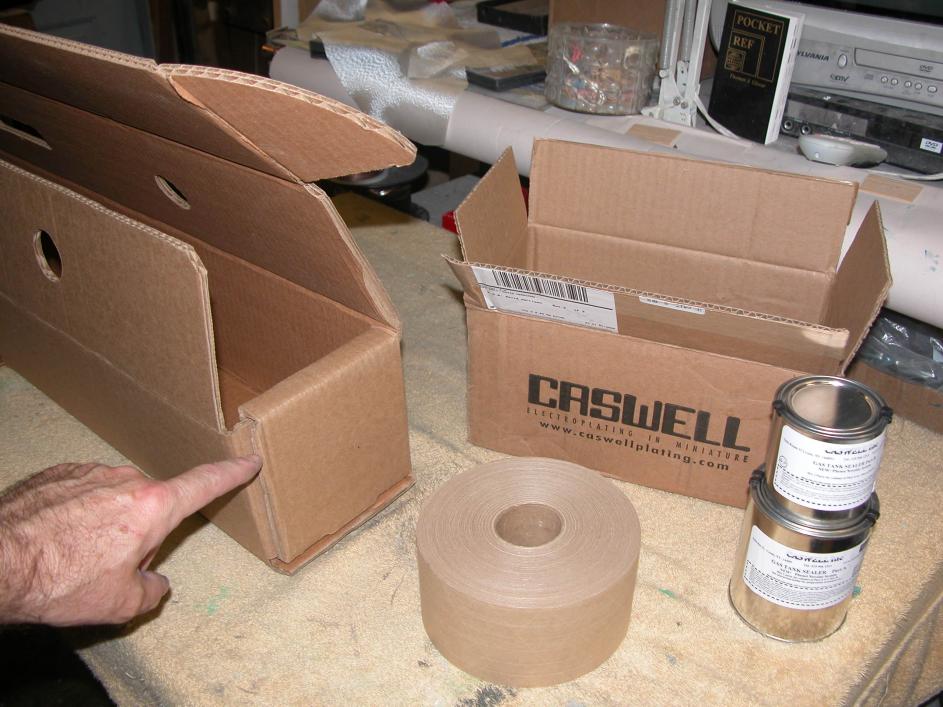

    You not only get a well engineered pre-cut and creased 'box', but also the gummed re-enforcing tape and epoxy resin needed to make the thing reasonably water tight.
    Tonight I assembled the box and applied the gummed re-enforcing tape to buttress the inside joints.

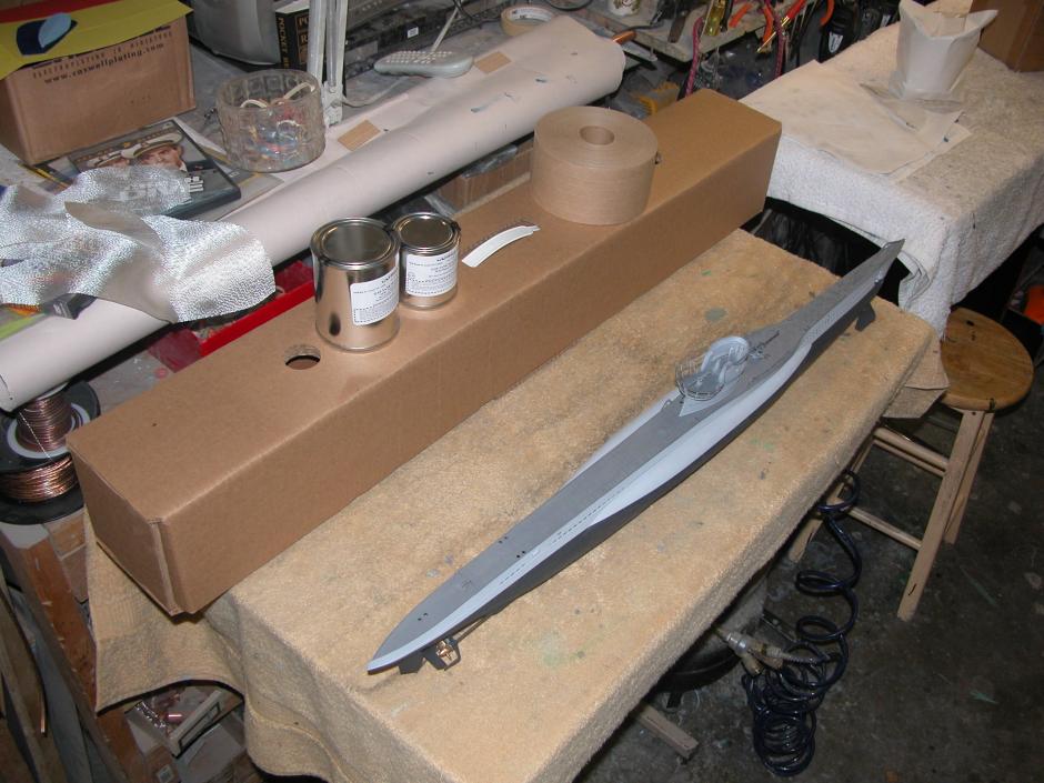

    As you can see, I'm going to use this particular box (they are cheap) to protect my 1/72 Revell Type-7 r/c submarine, but this size box can also find service protecting a 1/144 GATO or 1/144 SEAWOLF. I'm sure there are other r/c subs out there suitable for use with this box, but they don't come to mind.
    I'm tired, hungry and my feet hurt; been busting my hump all day for the great Caswell Empire -- he's got me doing double-time getting some 1/96 Type-212 kits and SubDriver's ready for him. This Sucks! I wish I were dead!
    Anyway ... here are the photos:

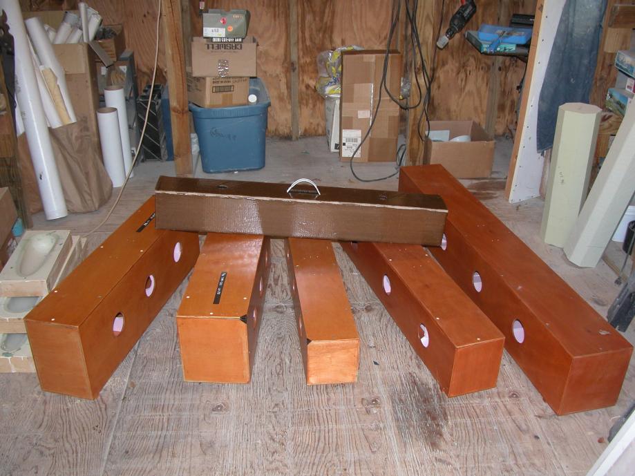

          Those of you who have seen me at a regatta undoubtedly have admired the boxes I use for each model submarine – no one takes greater care with their work than me! And I advise you to also invest the effort to protect your work. Either make your own box, or buy one. The below shot shows the typical purpose-built wooden boxes I make for my submarine models. In one shot, atop the five boxes on the floor, is the new Caswell Inc. heavy-duty cardboard shipping/storage box I put together the other day.
          Now (soon to be added to the catalog) you'll have a cheap, nearly purpose designed, effective means of storing your model. These boxes will be available in several sizes that will suit most of the r/c submarine (and some of the smaller model boats) out there today.
          About the Caswell cardboard box: Very neat design. Once you fold this thing up you have an easy closure box with an assurance that it will not open until you are ready to open it! The provided carrying strap forms part of the closure system. So, as long as you have the strap (handle) running through the top lid of the box, it won’t open. And the stiffness of the box after you coat it with the supplied special formula epoxy resin (which should be thinned with lacquer thinner to make application easier) also contributes to the tightness of the two outboard flaps that engage recesses at the sides of the box when you close the lid. Neat!
          It typically takes me six hours to make up one of my wooden submarine transportation/storage boxes.

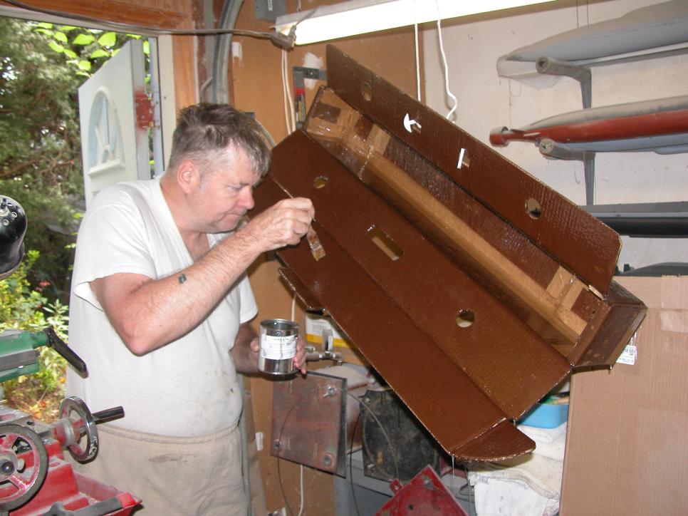

          (I goofed when I applied the supplied stiffening and water resisting resin provided with the box: I applied it un-cut. Mike informs me that you should cut the resin with lacquer thinner to make it easier to apply and to insure that the mix saturates deep into the cardboard. Oop’s! Anyway, I still got a good coat down and the things is sure water resistant! I like it.)
          Some pointers when you resin coat your box:
          First, I coated the inside of the box, then did the sides and bottom, and finished up the resin application after suspending the box by tying a piece of line around the handle and a ceiling fixture. That’s where it remained till the resin had cured a bit. Once the resin was past the tack stage, the box was taken outside to finish curing under the noonday sun.
            That's a damned nasty vicious haircut you have there David!
            And, yes, I thought you understand that the resin needs to be 'cut' with lacquer thinner to make sure it soaks right through the cardboard tri-wall.
            It is very important that you add twice as much lacquer thinner as resin, and apply two coats, to ensure the cardboard will will never take on water.
            As for the foam to keep the model inside the box: remember that you must keep the model still, so pad the ends with carefully shaped foam to absorb the inertia of the weight of the boat moving. If the boat can slop about inside the box, it will get damaged.

                We could supply our epoxy to Oz, but it is a hazardous material so will incur additional charges. A polyester will work fine. Make sure you can thin it with a solvent like cellulose (lacquer) thinner. Mix the resin at about 50% mixed resin to 50% thinner, and apply a second coat after the first has set. Then paint it if you like.
