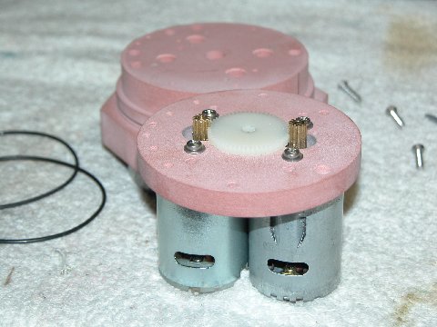

    As many are aware, we are only making these in KIT form now. The Wiz has modified the end-cap of the 3.5 (single screw) to make it carry two motors. For more torque (and less battery time) use the two motors. Or simply disconnect the 2nd motor, keep it as a spare, and run the one motor. As they both run onto the same drive gear installed in the dry space, you now have this greater flexibility.
    And I don't want to hear any moaning about having to pay for the second motor you don't want. To quote The Wizard -- "Too bad pal!":wink:

    Its great - I have ordered two of these new end caps. You also get the output shaft centred, the older version had the final output offset via the external gear box.
