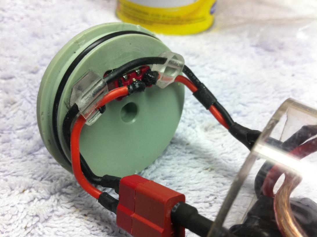

                Anticipating a future refit with 1/72 torpedos and a space need for an operating servo in the fwd battery compartment, I have routed the switch wiring off to the sides using two 'strain relief' blocks:
Name:	SD-2 SWITCH 01.jpg

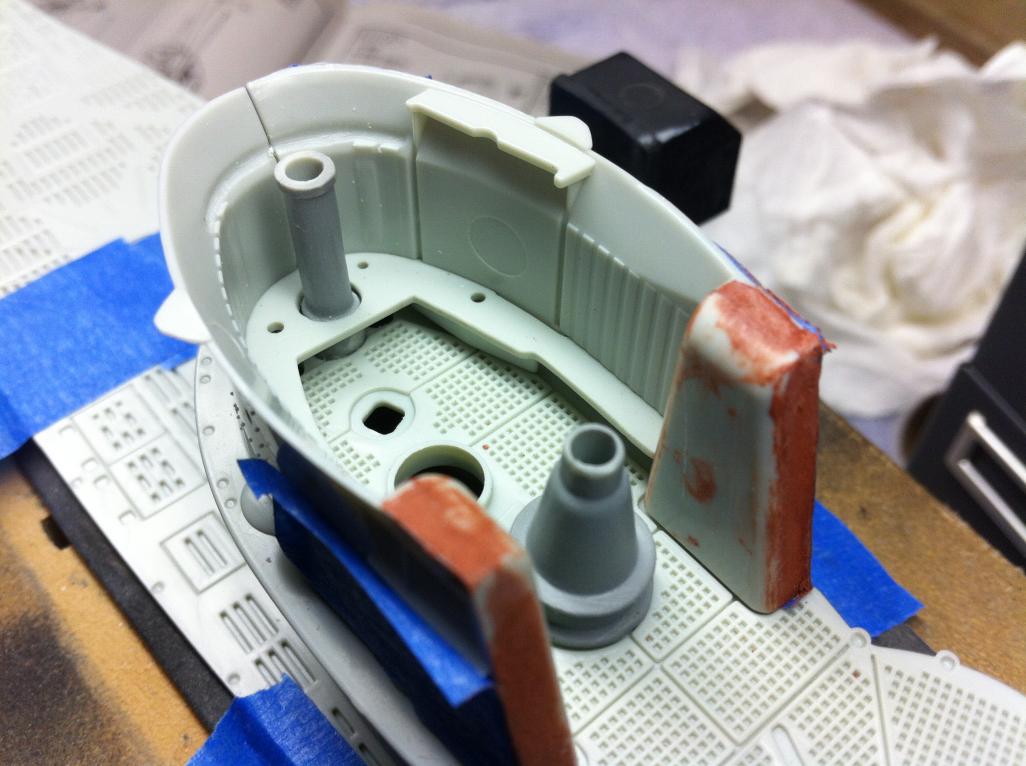

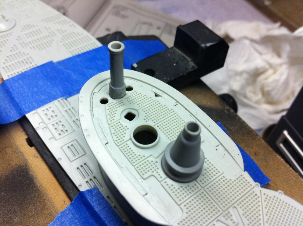

                Also, here's a stab at facilitating trapped air venting thru the conning tower with the pair of fwd holes seen here, which are fairly hidden when the bridge framework is attached.
Name:	BRIDGE HOLES.jpg
Name:	TESTFIT BRIDGE.jpg
