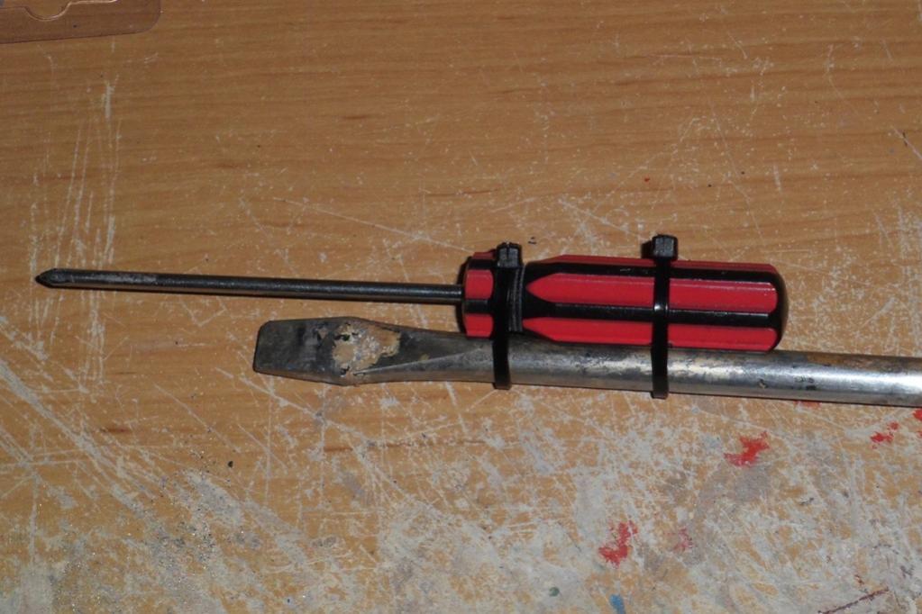

                  Originally posted by roedj
                  BTW, I have to tell you it's just so much fun trying to cram my 4" OD hand down 8" into a 3" ID tube to mount that servo. I have to believe you mount that servo to the bulkhead before you stuff the bulkhead into the tube.
                  This is how I got round the same scenario... Cause all the same fun was killing me!!
Name:	Ballest servo extended driver.jpg
                  Cheers,
                  Alec.
                  Reality is but a dream...
                  But to dream is a reality
                    [ATTACH=CONFIG]20130[/ATTACH]
                    If you put a small amount of CA on the tip of the screw driver and attach the screw to it, I found it reduces the fun factor as well. The screw driver will pop off once you get the screw tightened down or at least started. I got tired of chasing screws or falling off just as I was about to get started in the hole.
                      Thank you, I'll try that. I had been using a small amount of RTV for the same purpose but it wasn't quite doing the job. I cannot seem to magnetize my screwdrivers enough to accomplish the task as well.
