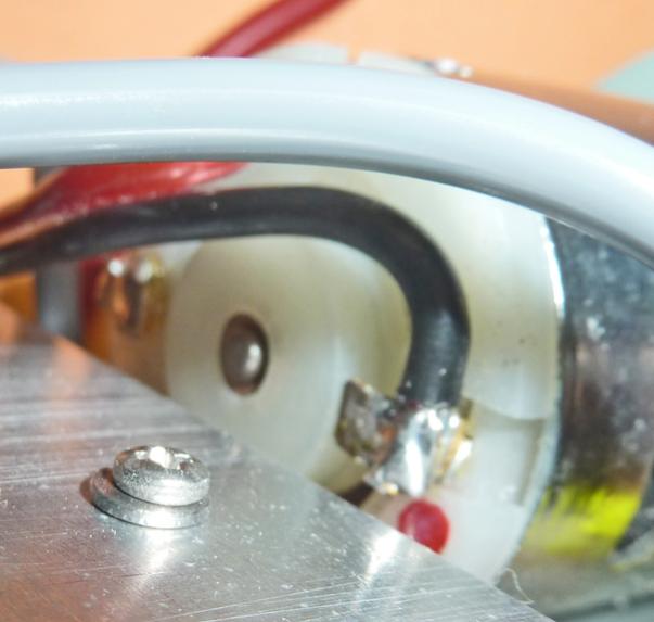

    Attached is a pic of the power cable end of the motor supplied with the 3.5" SAS for the Skipjack. I don't see any RFI caps installed. Are they internal to the motor case? If not, I would think I should install them. Please advise.
Name:	motor showing no RFI caps.jpg
    Dan
    • 14014
    Recently Mike was able to negotiate a deal with the supplier of our 555 and 380 sized motors to provide them with internal spark-suppression capacitors. And that's the case with your 3.5 motor, Dan. You're fine -- that motor is spark suppressed. You can tell by the small gauge wires that come out of the motor back-plate and are wound around the motor terminals.

      Thanks for your response. I always believed that Caswell/You wouldn't offer a motor that wasn't somehow RFI suppressed.
      I must admit, though, that I do have some reservations about routing an unshielded antenna lead along side a motor, RFI suppressed or not. In my multi-year experience of operating radio communication gear in an RFI rich environment (think cars and trucks) I would go out of my way to keep the antenna lead (always shielded coaxial cable) as far away from any RFI generator (thing spark plugs and on-board computers) as possible. Even then, I would ground the shield to the engine block in multiple points.The fact that it apparently works in the confined, RFI messy quarters of any WTC is more a tribute to sound receiver design, RFI suppression through judicious use of RF by-pass capacitors and/or plain dumb luck.
      My two pfennigs worth,
      Dan
        • 14014
        I share your trepidation here, Dan. My hand was forced -- I could not find any other way to get the receiver antenna length to the outside antenna length. However, it works. Never had to run coax between receiver and antenna lug. Amazing still to think that we can get away with this.
        • roedj
          • Sep 2008
          • 564
          Just to be totally anal retentive about this, I will run the antenna lead to the outside either:
          1) By means of a piece of 1/16" rod (push rod) routed through the waterproof seal nearest the safety float valve with a means to attach wire to both ends and appropriately sealed with RTV, OR
          2) By simply attaching the antenna lead to both sides of one of the SAS brass nipples on the back end plate by soldering on some sort of spade lug to both sides of the nipple and sealing with RTV on the outside.
          Either way, the antenna lead won't run by the motor at all. I'll be careful to provide strain relief whichever way I go.
          Dan
