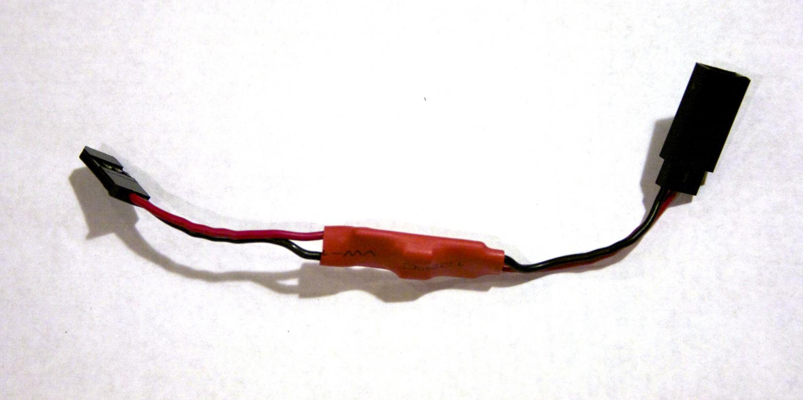

                            Kevin,
                            You are right it is called a LiPo Voltage regulator.
                            Here is what it looks like:
                            Thoughts?
                            • KevinMc
                              • 305
                              Well, that definitely wasn't included in my transmitter, but then again I've had mine for quite some time now and even if it hadn't been there I wouldn't use it anyways. It must be some kind of series voltage drop device though, otherwise it would likely drain the battery 'till it was flat.
