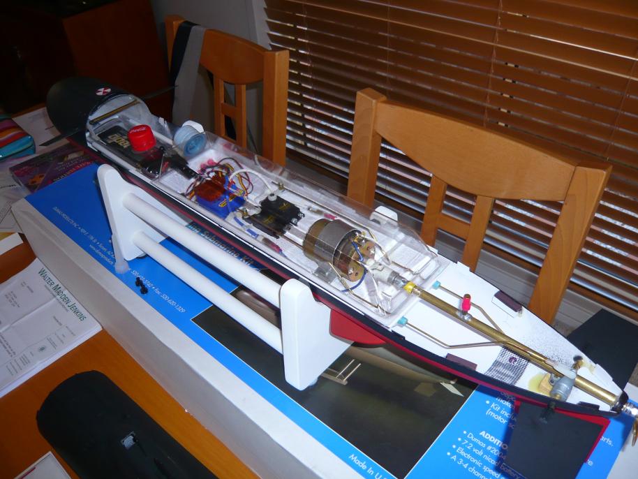

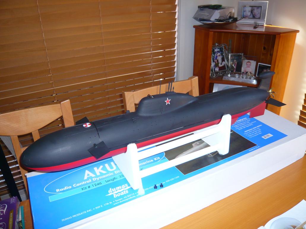

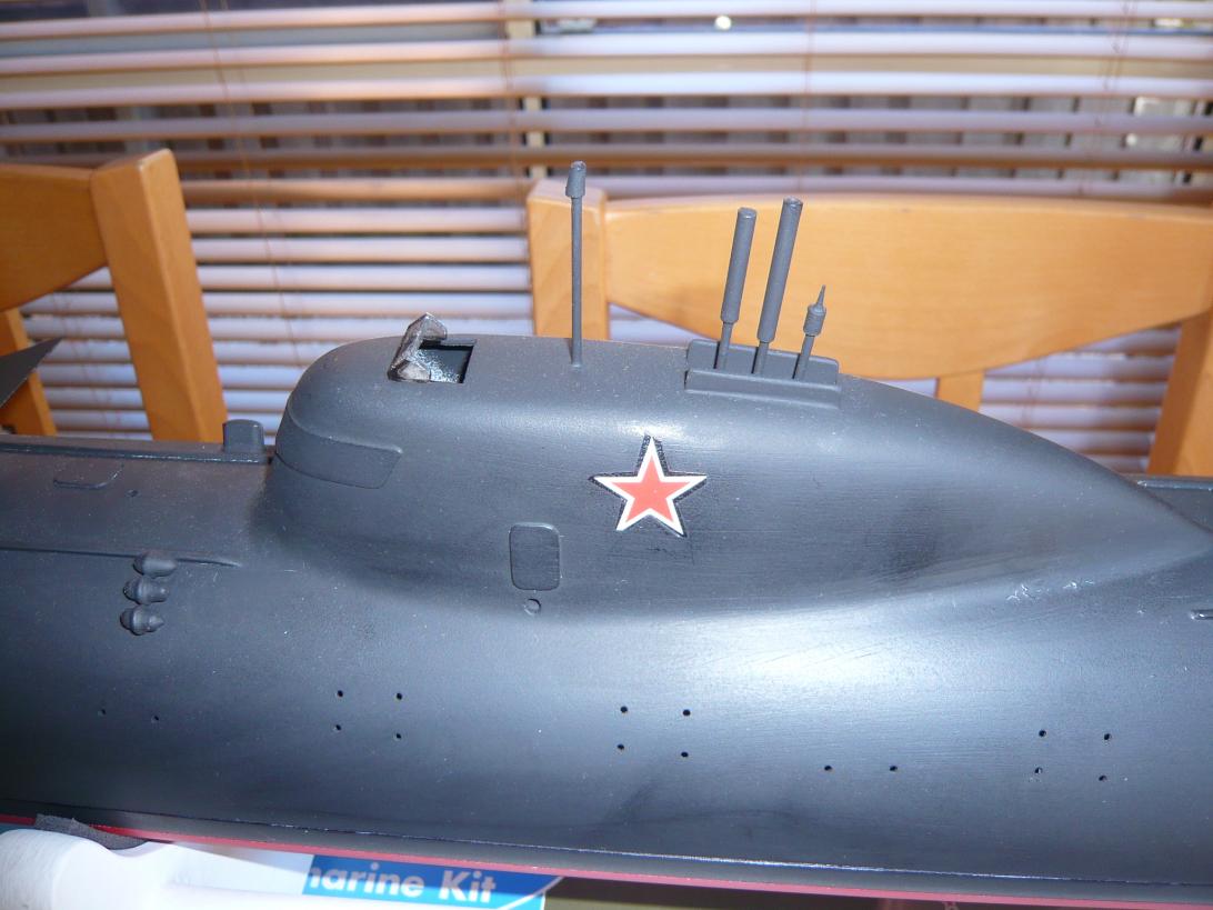

    Just some photos of my lastest project. Only additions, a set of Mr Merriman push rod seals, 4mm shaft, 6 blade raboesch prop. Added some detailing sourced from the net. What do you think.

    That clear watertight box lid is slick -- keeps the water out OK?
    Loose the propulsion shaft grease stuffing tube ... I don't care what AquaMex says! Put a proper seal around that propeller shaft.
    With those radical bends to the flimsy rudder and stern plane push rods, do you have any binding problems at the seals?
    Can't you make the stern plane bell-crank any bigger?

      Just followed the dumas instructions. Thought your push rod seals were way ahead of what the instructions said to construct. The bell cranks are all standard. I just cut the top of the hull off a bit shorter, so as to place the forward hydro planes in the bottom hull section, so to speak. I added a bell crank to the said hydroplanes so that a fourth channel can now operate them independly. As four push rods binding, it just took a little tweaking. This project was just to get me back in the model building game. I had all the parts in my cupboard. I had the sub kit for about 7 years. I am waiting for the 1/144 scale german u 212 wtc and fittings to be produced.

        Hey, if it works, it works. Has that thing been in the water yet?
        Like the little do-dads you stuck on the deck and sail, helps breath some life into the subject.
