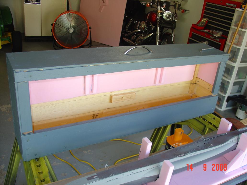

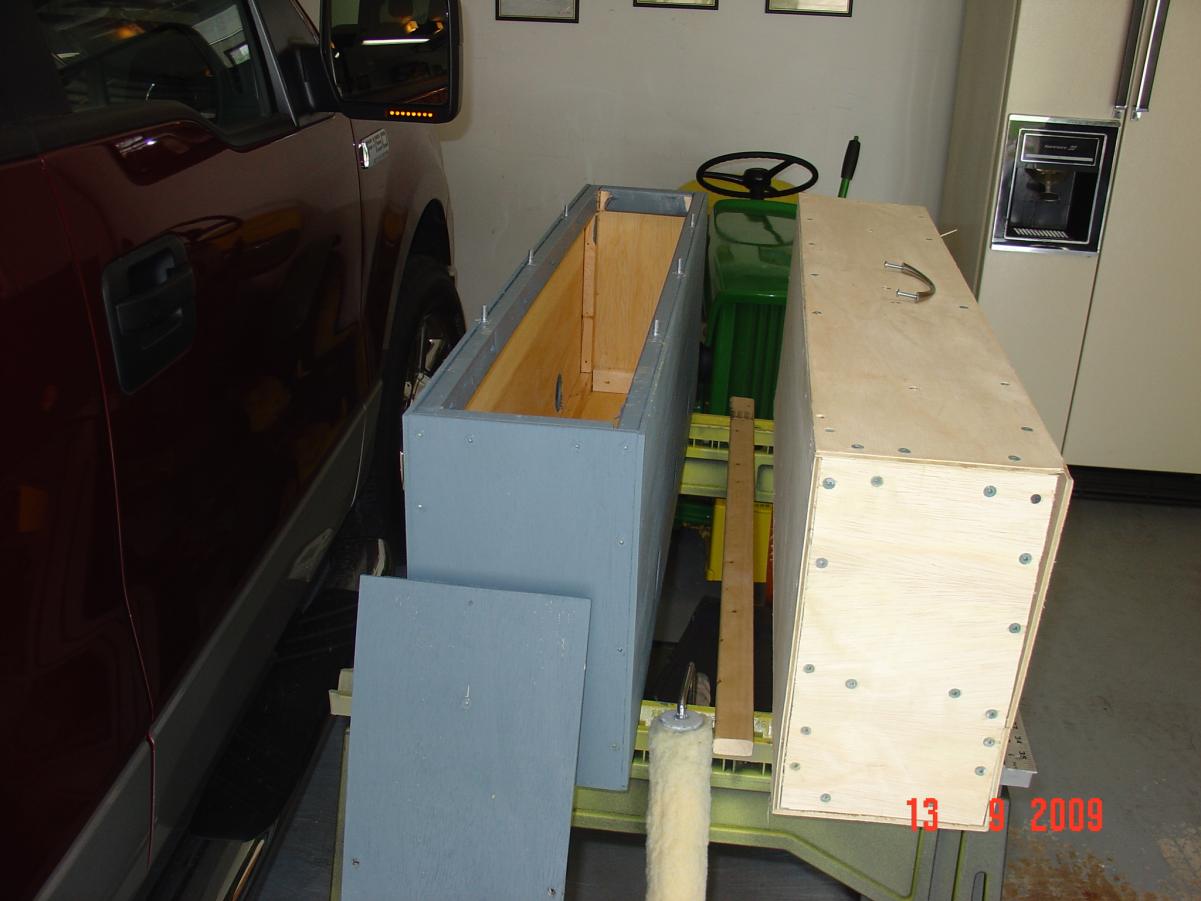

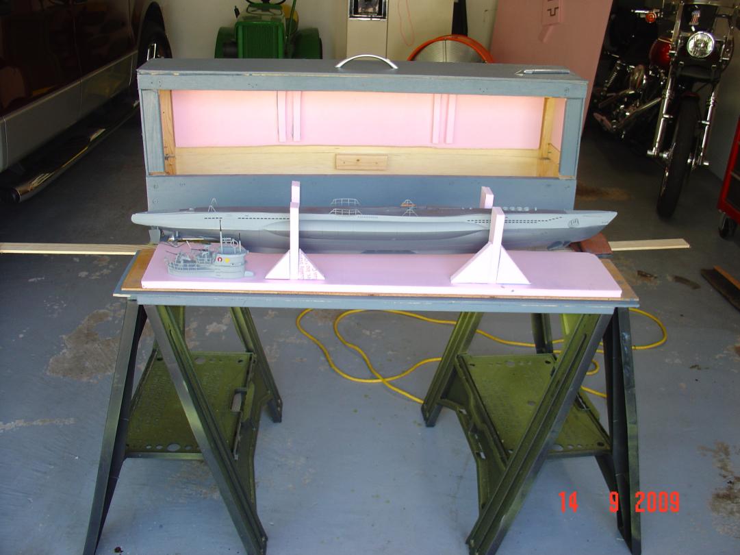

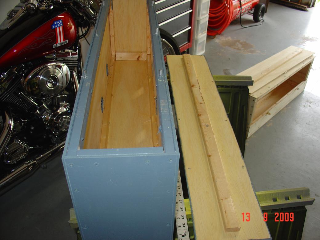

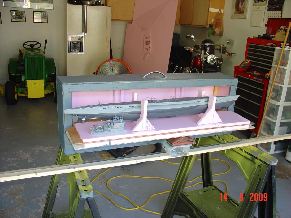

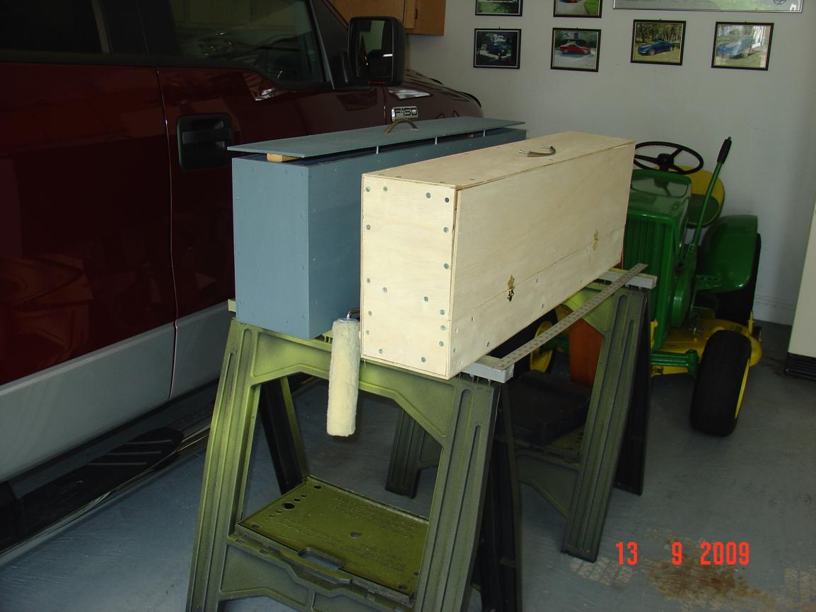

    The boxes are still under construction but I did post some pictures. The box with the sliding drawer I like the best. I can get two boxes out of a 4'x8' sheet of plywood. Also two 8' 1'' 1/2 for framework. I should use smaller framing stock. The box not painted is the slider. There will be pink foam completely around the boat. All sides and it will be in a foam cradle. Two small handles for pulling the slider out. You can see the area under the sliding board that will hold tools and stuff. I have brass plated hinges and stop locks. I will post additional pictures when completed. I still have to add little feet for the side that drops down to hold it level. A latch lock at the top and paint.
    I do put sealer inside the box because of water to seal it and keep it from warping. I having a senior moment, can't think of the stuff I use. Polly something. I hate being old.
    Box will be Gray and have the 6 " U-295 in white on sides. Also the Caswell inc. and D & E Miniatures powered like the old' U-552 box in white (see U-552 (My first sub)Album).
    I ran into a problem today. After getting the saddle made for the U-295 and placing the boat in the saddle putting the boat inside the box the hinges where in the way to pull the sliding tray out. Nuts. I became apparent the I needed to drop the hinged side a little lower so the hinges will clear the sliding tray. But you get the idea from the pictures. I need to make a trip to Home Depot for material tomorrow.

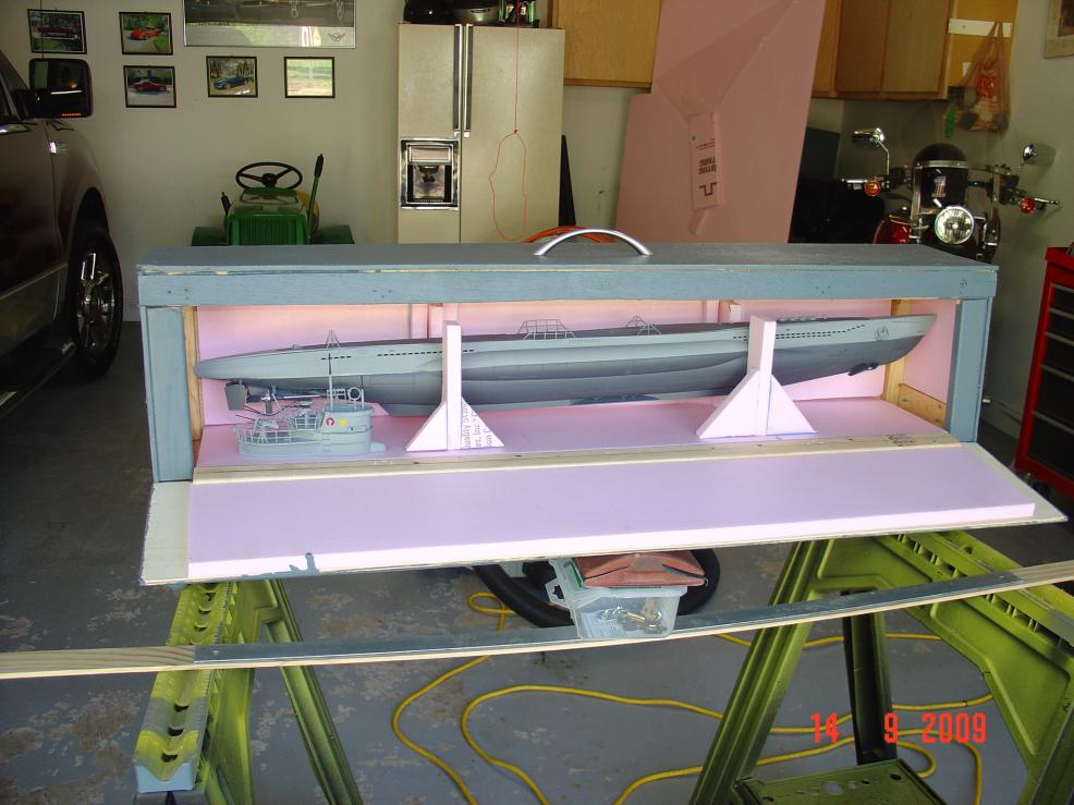

      I do put air holes in all my sub field boxes. I attached some pictures of the U-6 subs field box. The U-6 isn't even built yet but I thought I should plan ahead. It has a tray (tool tray) that hangs over the sub. It is also under construction. I Have to go to Home depot for more material tomorrow. Home Depot has a hell of a saw that can cut anything straight. They will not let you use it but they will cut anything for you. Insurance I'm sure.

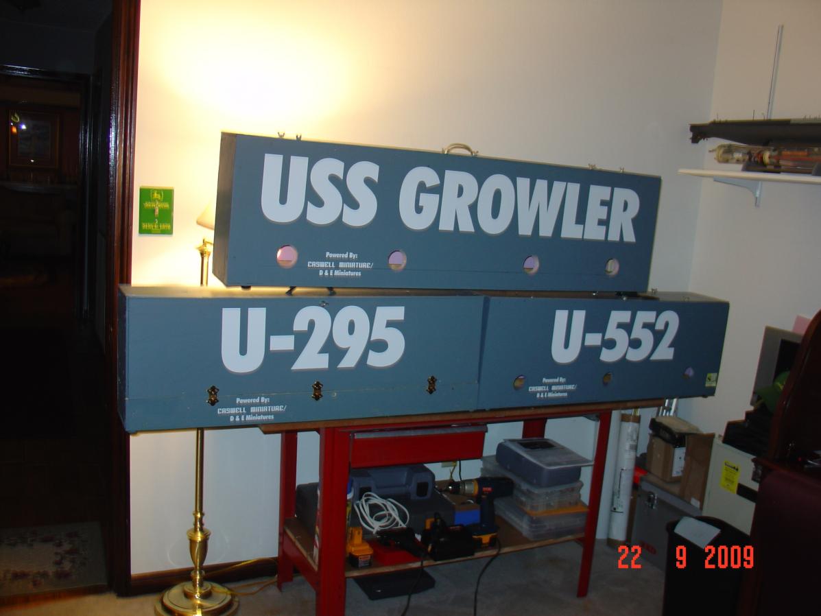

        I've completed three field boxes for the three subs I have. U-295 box has tool storage in the bottom. I still need to drill air holes in U-295.
