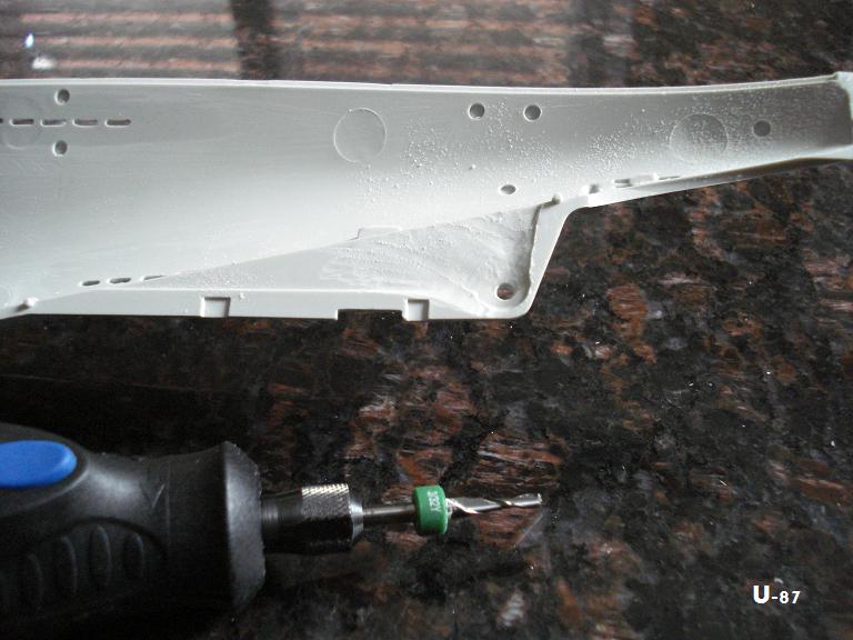

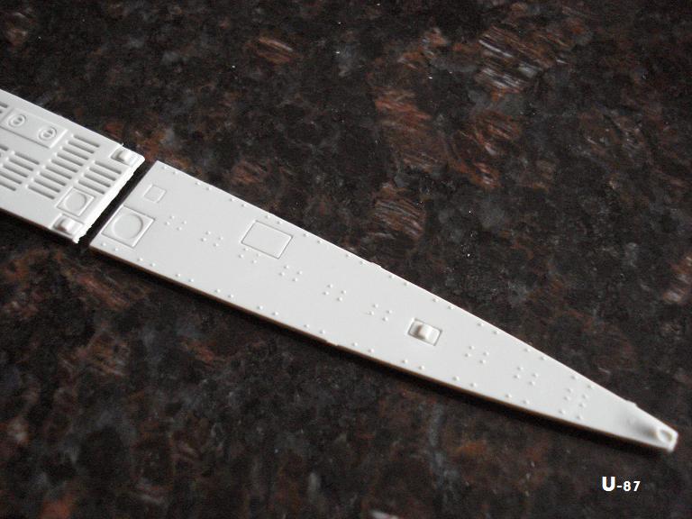

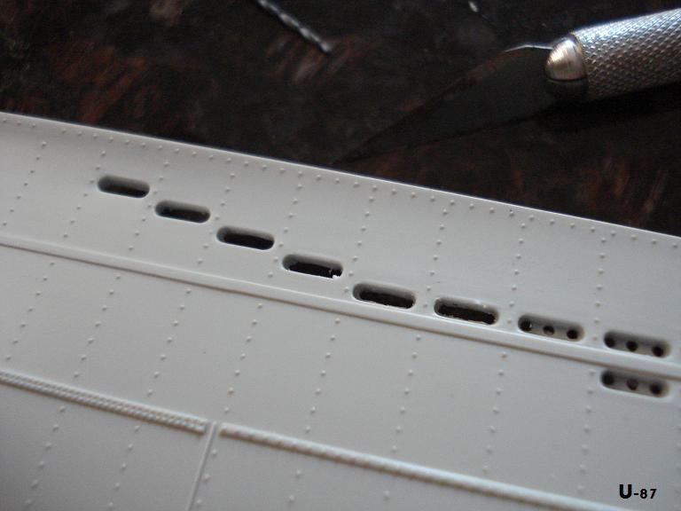

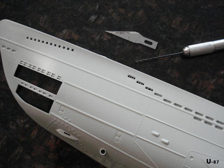

    Well my Revell VII-C kit arrived in the mail yesterday, and work has begun. I plan on taking pics through the entire process for all to enjoy !
  • red_noir
    • Jun 2009
    • 30

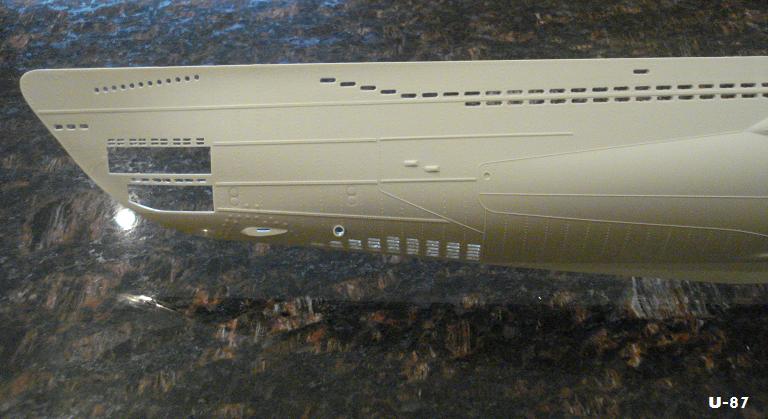

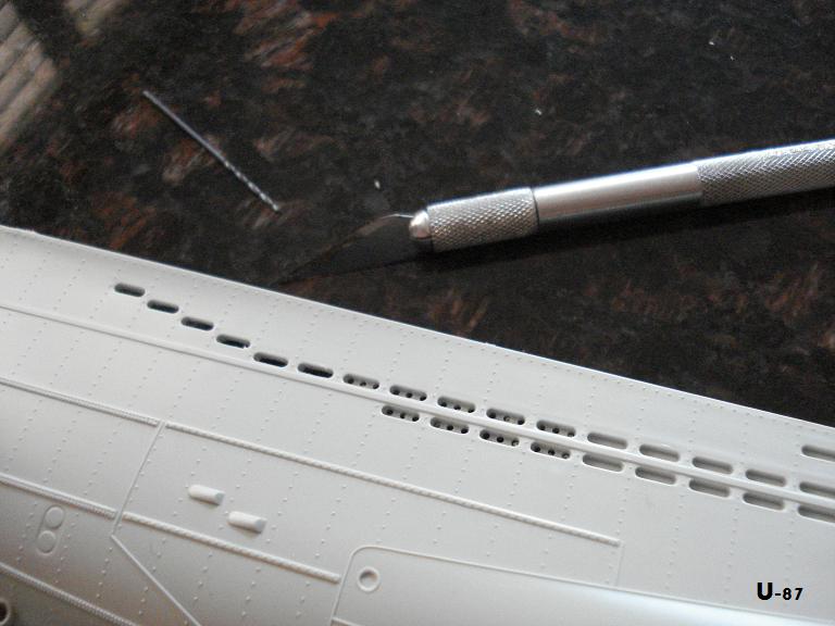

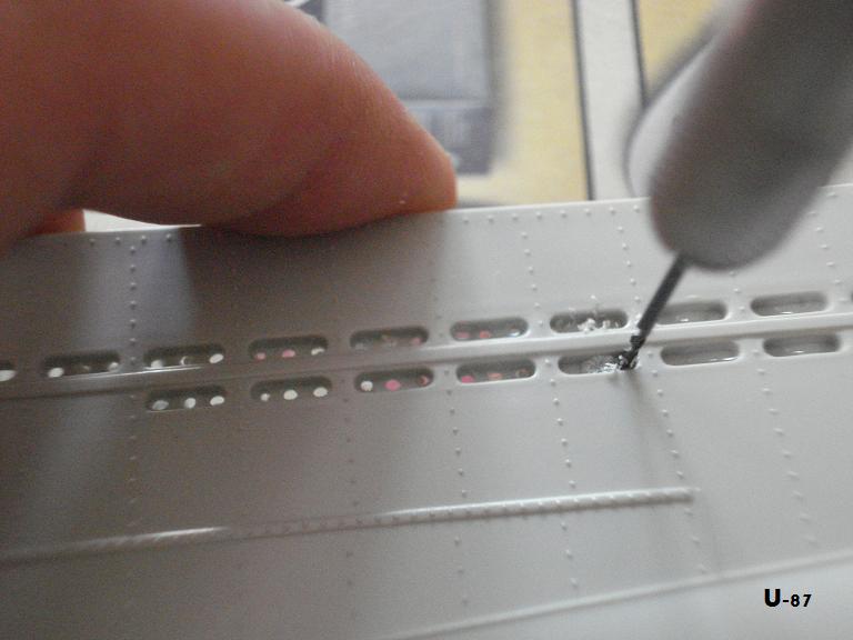

    more hole opening!
    • red_noir
      • Jun 2009
      • 30

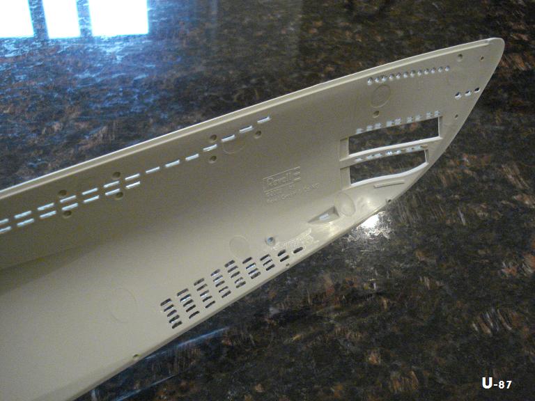

      ordered my fittings kit today ! and am waiting on a few other goodies for this model ! So far its been tedious opening up everything but it will be worth it in end I hope !

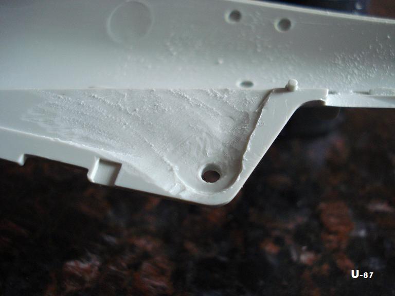

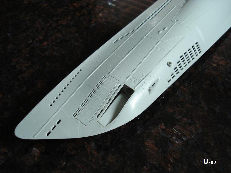

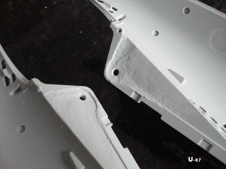

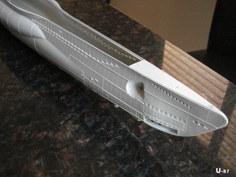

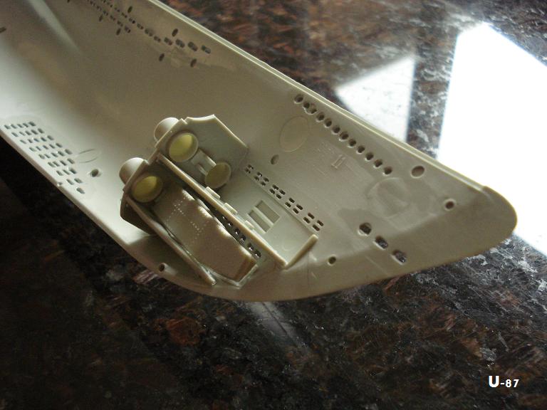

        Ok hull joined today ! the bow was slightly warped and after a bit of fiddling I got it all straight !
        Chuck
          Good job grinding out the inside of the skep to make room for the stern plane bell-crank. Keep those pictures coming in.

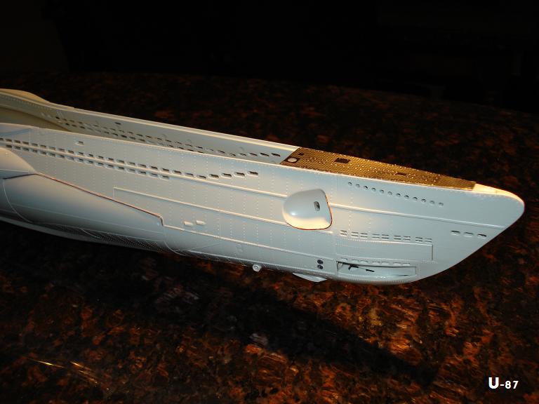

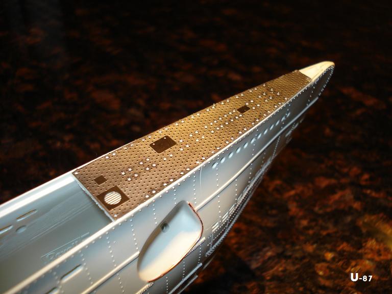

            more updates from today.

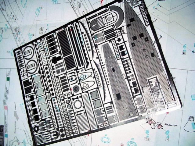

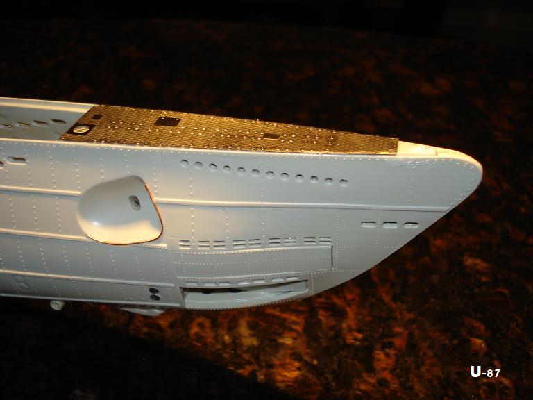

              Looking good! Who makes the deck Photoetch?
                I don't agree with Mike about gluing the forward deck piece in place -- just too much flexing of the hull is required during SubDriver installation/removal to prevent the glue bond between forward deck piece and hull from parting.
                I don't think it will work, but I could be wrong.

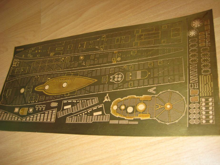

                      I don't know about that brass decking. For static display yea but me thinks that your boat will be top heavy if shes a working boat. I've always been told that you should keep it light above the water line. Maybe the sub gods will abvise you here but I think the brass is a bad idea for a working boat?
                      Jack
                        Typically .010" thick etched brass or stainless comes in at about the same weight as a .0625" thick polystyrene deck -- the problem is, the brass will displace much less than the thicker styrene, so additional foam has to be placed below the waterline to account for the higher specific gravity of the brass/stainless deck. But, not much.
                        And (very surprising to me) the pre-formed foam and fixed lead weights for this particular model go a long way in satisfying the total displacement-weight-metacentric height needs of the Revell 1/72 Type-7 model kit converted to r/c. So there is still a lot of room in the hull for additional weight and foam to correct the slight 'top heavy' condition presented by the brass.
                        Incidentally, the etched brass/stainless deck and detail parts are stunningly beautiful. However, keep in mind that an r/c submarine is subjected to quick temperature changes and that the different thermal expansion rates of polystyrene and metal will exert extreme stress on the union points (glue). Use a flexible type glue to adhere the brass/stainless to the styrene to account for this. And don't use the etched limber hole inserts -- they will evidence the union seam between the etched piece and hull the first time you plop the hot model into the water.
