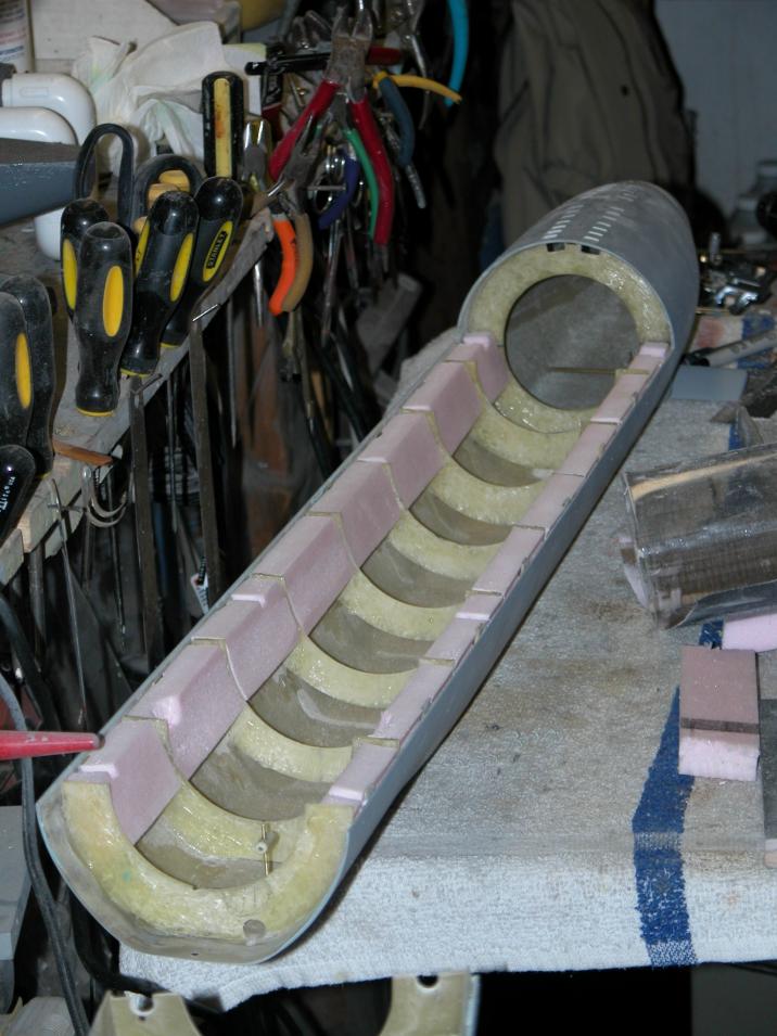

    Only construction point I would make, without further inquiry from you, is to maintain the OTW flanges on the two hull halves -- I removed them and the parts warped terribly. Took forever to fix with internal frames. Dumb move on my part. Leave the flanges on the hull halves!!!!!!

      All the frames necessitated when I foolishly removed the hull flanges. Lesson learned!

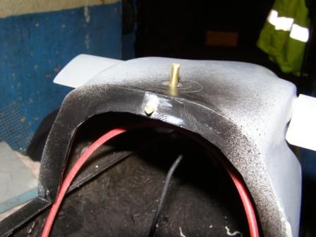

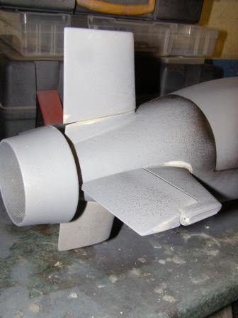

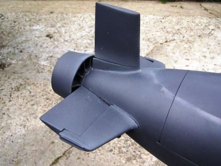

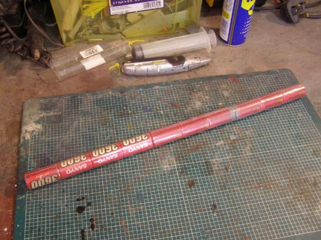

        So far I've built the WTC, fitted the original supplied rear planes, ripped them off & replaced them with the improved versions. Built & installed the motor box & Battery arrangement.

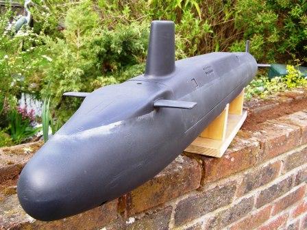

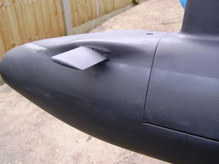

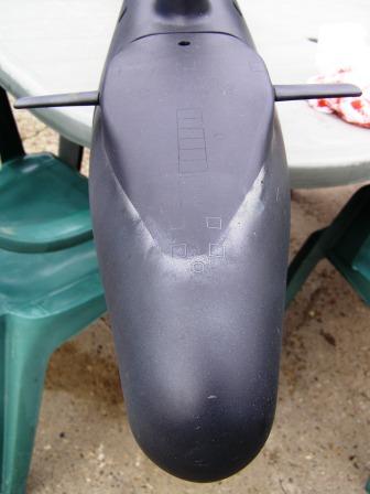

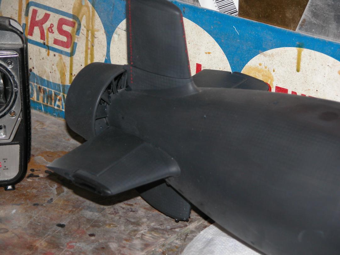

          Some of the outer details sorted now, also fitted the retaining studs in the flanges - left on! - Trash coats of Grey primer have been applied & she's ready for a final rub down before the initial coat of Black, this will be followed by dry brushing Charcoal paint & Pastels over it to pick out the details.
          Scum line, weathering etc can wait untill I got her running properly & had the usual chat with the pond wall that always seems to come with a new boat!

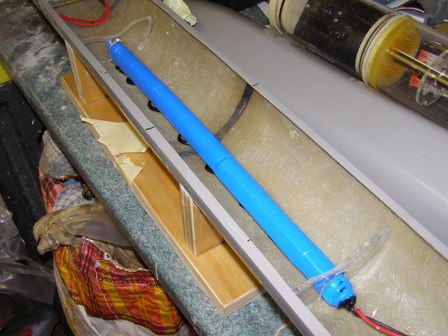

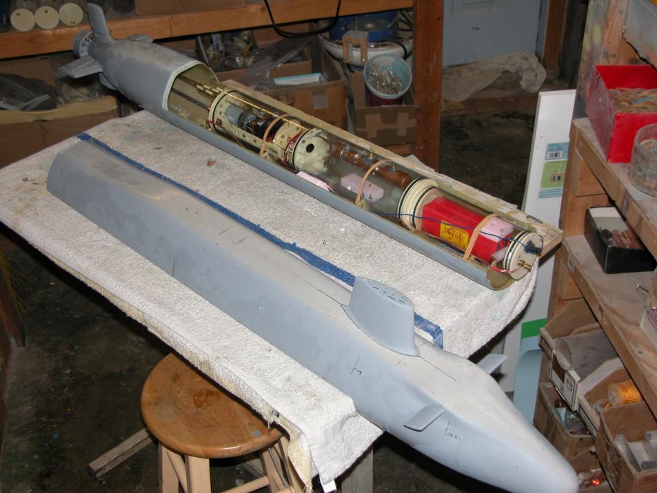

            I just noticed that in the picture of the SD used in Vanguad there are things Very-different about the Ballast-tank portion of it.
            There appears to be a small black tube, in center, connecting fore and aft WTCs, but what is the other thing doing, inside the outer tube?
            That inner thing is Vary strange looking with holes and bulkheads, all over it? :confused: Is it a Baffle? If so, why was it needed? Is it to prevent slosh-roll problems, for better stability?
            And I don't see any Vent/Blow valves in it??? :confused: Where did you Hide them?
            See Pic:

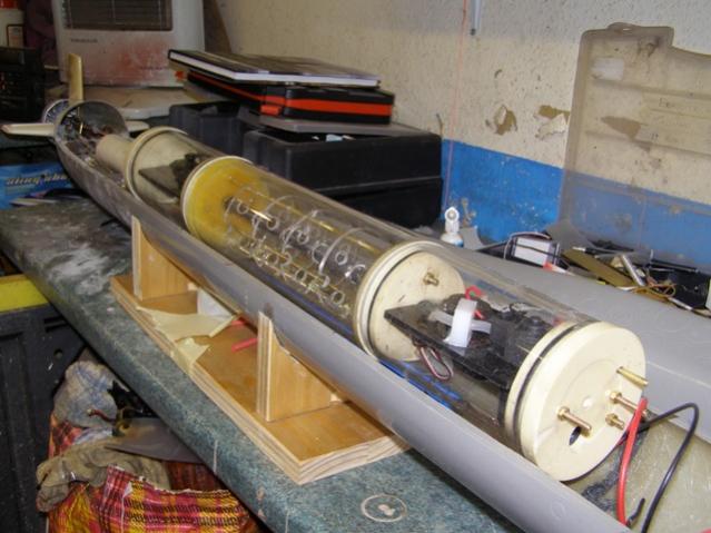

              The reason you cant see what you're looking for is because they aren't there. This is a water pump system I have put together myself - as I do all my WTCs, the pipe through the centre carries the wiring fwd - aft.

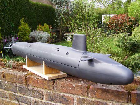

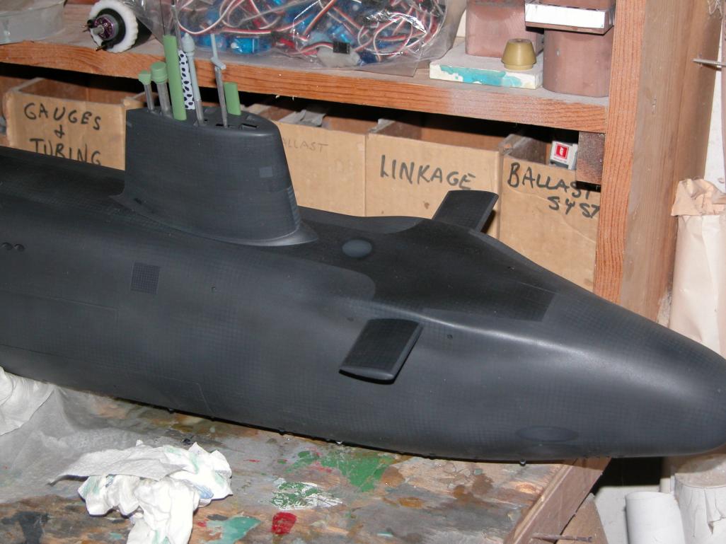

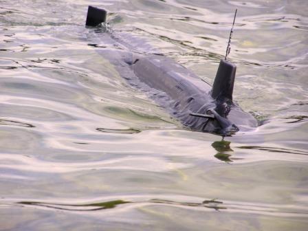

              Anyway, here's a couple of pic's of her painted up, hopefully get snother run & pictures underway next week - forgot the camera last week.
              She's very stable & with very little additional trim dived on a very even keel & almost achieved critical balance! The 540 motor gives plenty, possibly to much power.

                In this sytem the ballast tank is about 2/3 full when dived so you have free water surface, hence baffles help greatly.

                  I've fitted baffles to all my water pump boats & I'm convinced it helps, but as far as I'm aware, Sheerline still do not fit them & speaking from experience his boats are all pretty stable.

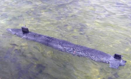

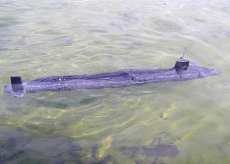

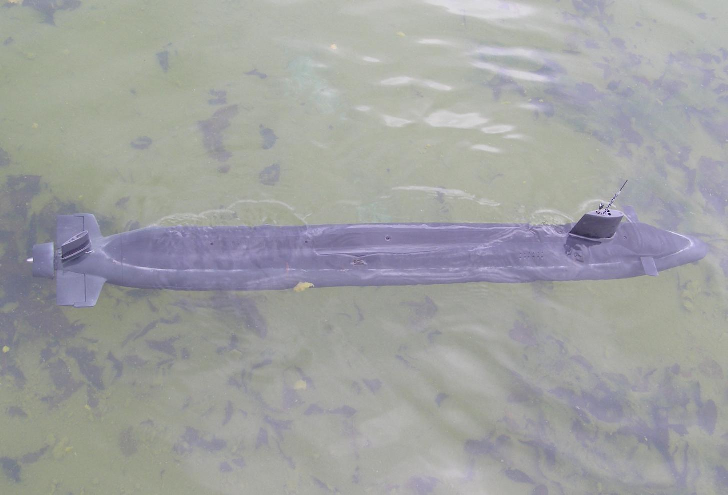

                    Had her on the water today, sails really well & is very stable even without a leveller.

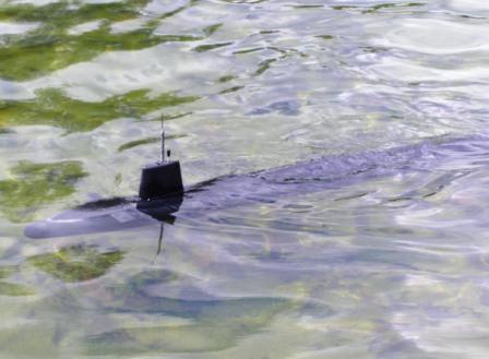

                          A couple more shots to show the scum line & weathering, the colours work better when she's wet.
