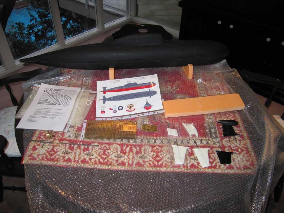

    I got home from work on Friday to discover that a very long package had arrived from Belarus.
    Woo! the 1:96 scaleships Akula II hull of the Vepr had arrived.
    Add this to a recently acquired mtroniks ESC and things are really moving along nicely for my first sub.
    The kit is well detailed and very thorough, I'm sure I've started this hobby the right way with this bad boy. All the scribing is crisp and clear, the drawings are great, and there are only a few locations which need some filler. (What filler do you gents personally recommend?)
    There is a bit of spring back in the halves, which will hopefully be taken care of by the plywood ribs that will hold the sub driver in place.

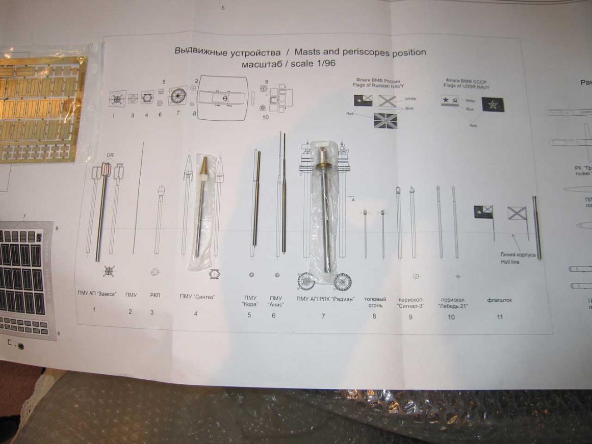

    The masts and periscopes deserve special mention. As I've said before, I'm new to all this, but the attention to detail and workmanship for the masts in my opinion is second to none.
    I seem to be missing the search and attack periscopes and I think the snorkel mast, but I've sent off an email to Vladimir so hopefully that will be cleared up soon.

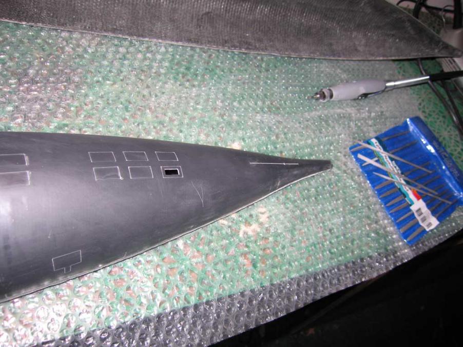

    I was really keen to get working on the hull so started out by removing most of the flash from the lower hull leaving a little lip to even out once I get the 2 halves trued up and mated together.
    The first hole was also made, opening up a limber hole in the bottom hull, ready for the attachment of the brass photoetch parts.
    As you can see, I got a little over zealous with the flat needle file and scratched the darn thing. Another candidate for some filler and 600 grit.
    So that's where I am up to, looking forward to some quality time opening up more limber holes tomorrow.

                Vladimir has already sorted out the missing periscopes (within 8 hours of sending the email!), so I'll have those in the next few weeks as well. Anyone who is considering buying a kit form him, I heartily recommend his service and the quality of his kit.

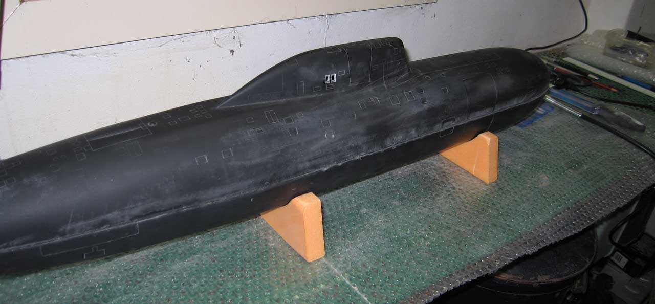

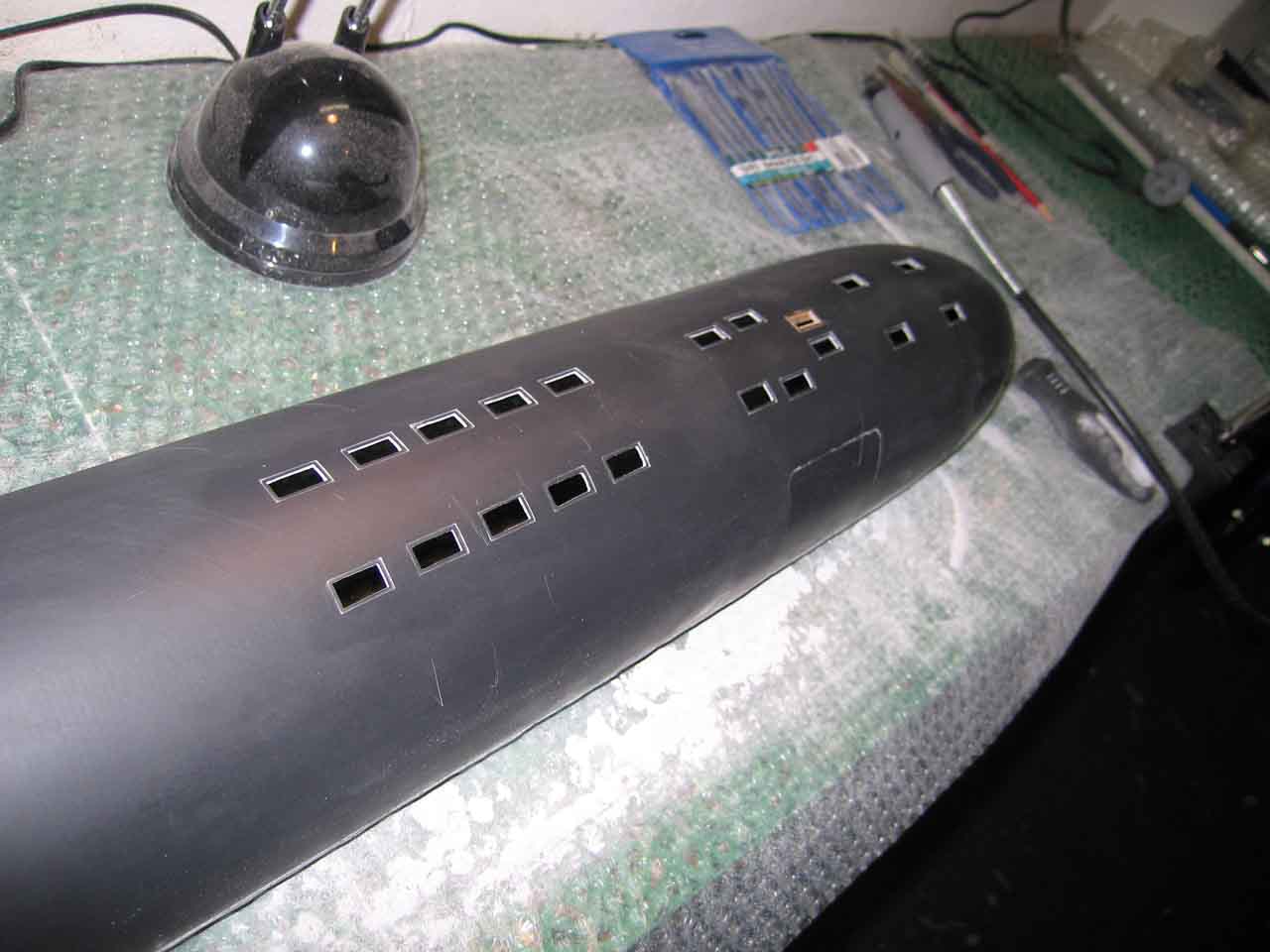

                    Had a great Sunday afternoon, drilling, dremeling and needle filing the rest of the limber holes in the bottom half of the hull.
                    I had completely forgotten how much fun you can have at a workbench.
                    As you can see from the scratches where I've been a little over zealous, more speed and less haste is required with the needle files. At least these scratches are superficial and will disappear under a bit of filler.
                    I've been using one of the photo etch limber doors as a guide for opening up the holes correctly. These brass parts really add a dimension of detail to the hull. They give nice, sharp lines.
                    Once I summon up the courage to crack open the zap-a-gap, I'll start adding the brass parts to the boat permanently.

                    I've also roughed out the small grille openings on the side of the sail (all the better to get air to the LBP.) But if I'm honest it's mainly, because they look dang cool.
                    Speaking of the sail, I wonder if it's feasible to razor saw the openings in the top of the sail? Or should I cut them out and replace with styrene sheet?
                    The resin is quite thick at the very top of the structure, so it might be a struggle to get nice looking hatches from it.
                    Any sage words of wisdom and experience in this situation?

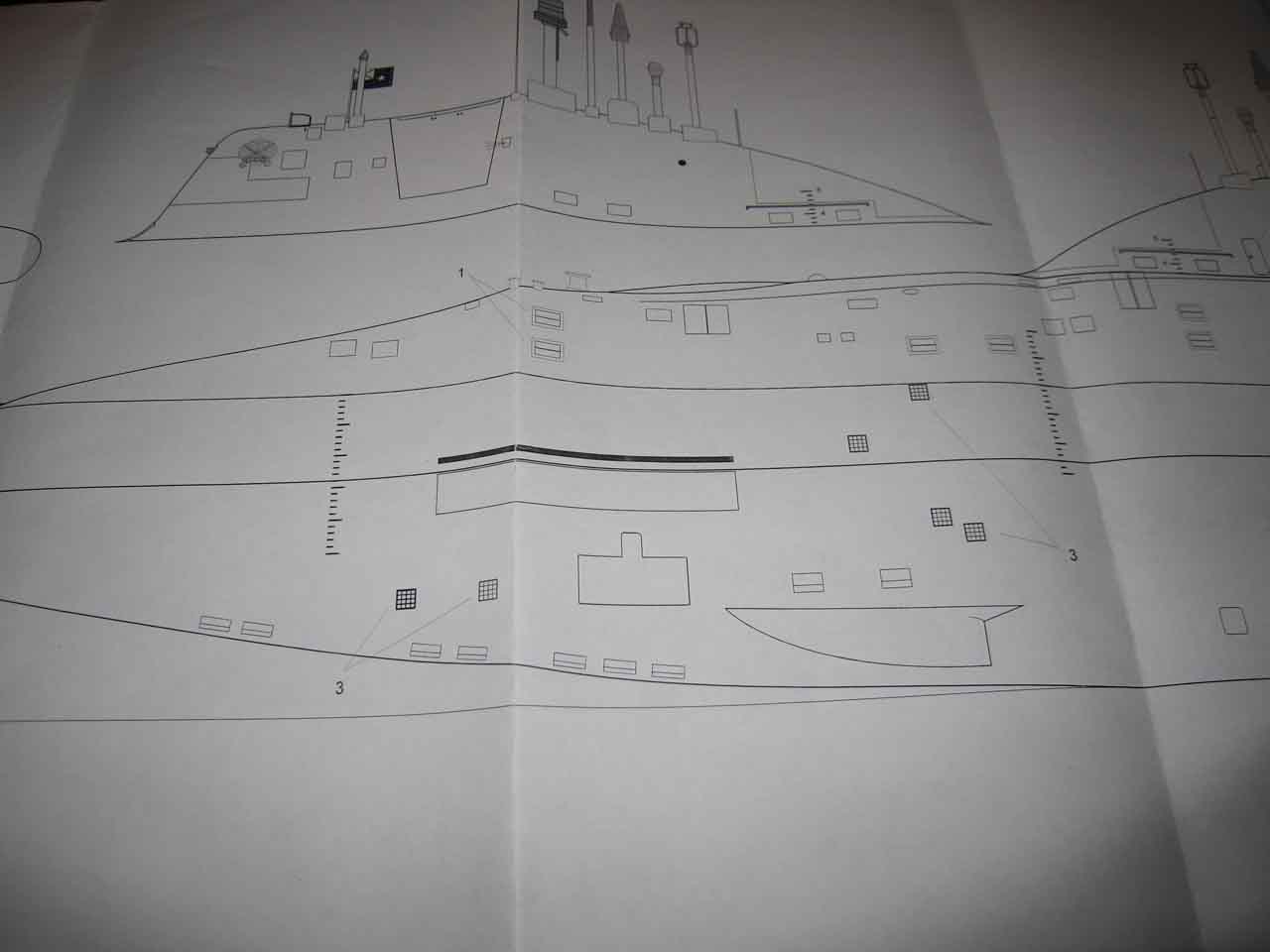

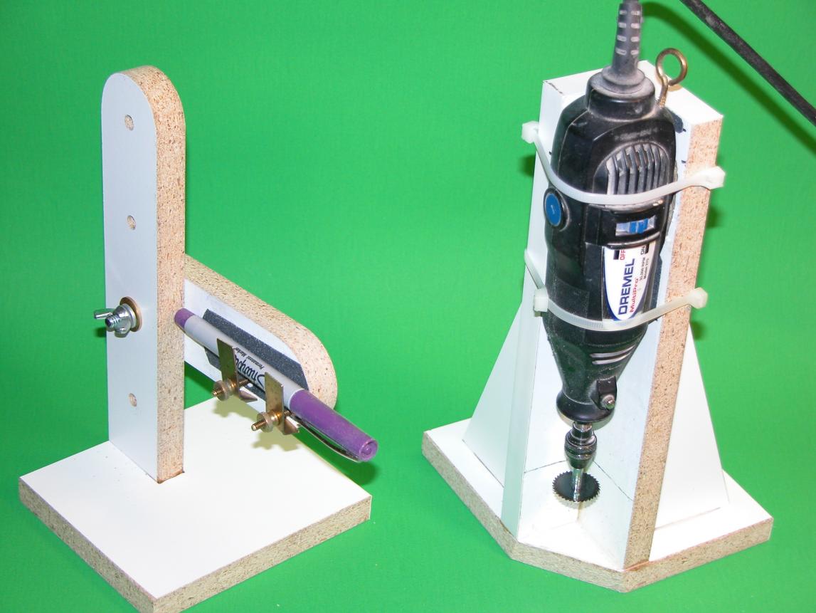

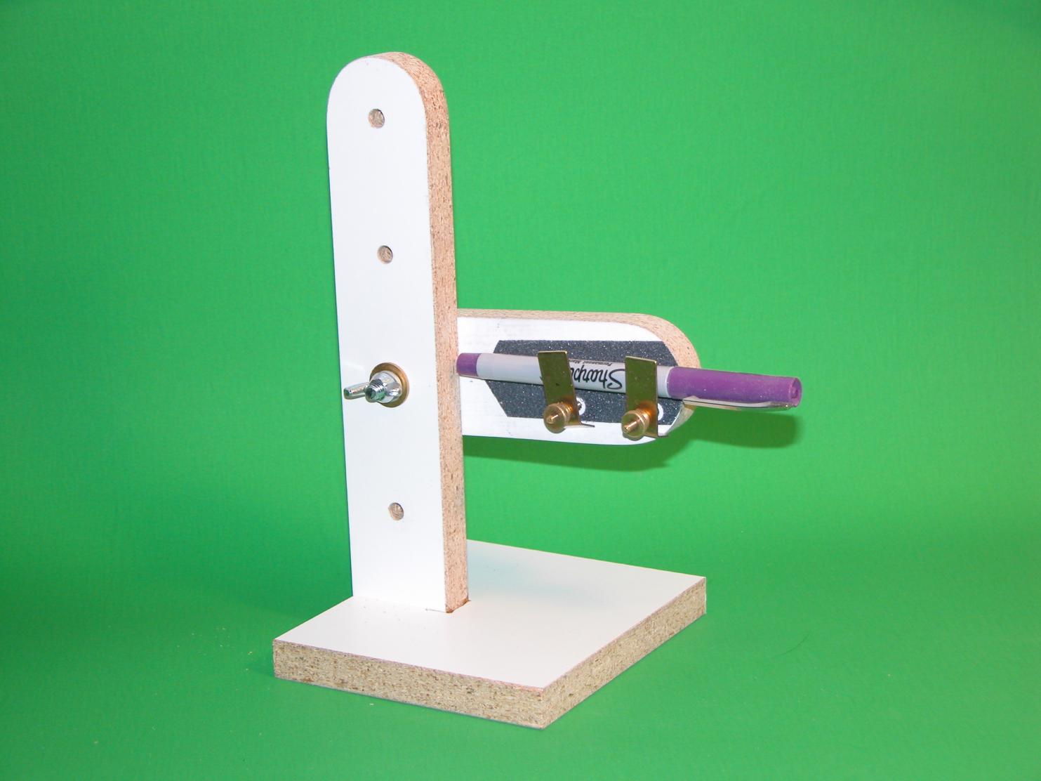

                    There are small square grilles, marked No. 3 in the above image, where there is no corresponding marking on the hull.

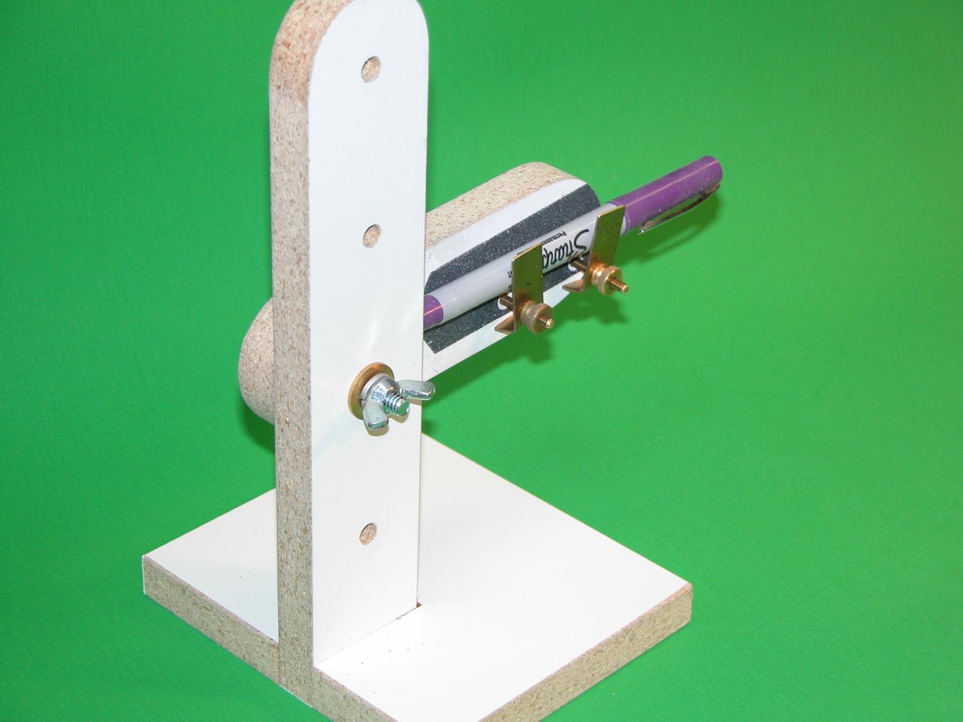

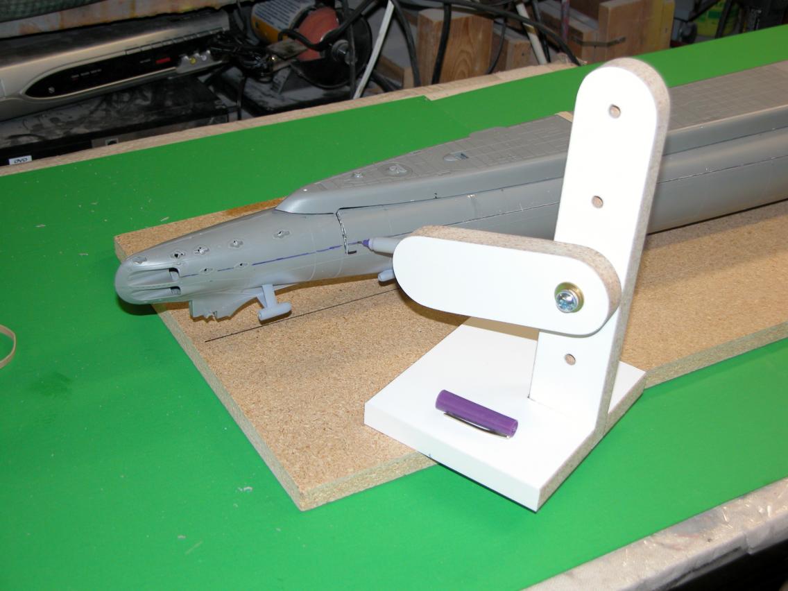

                    My plan, from reading the forums is to make up a surface gauge and pencil in the locations of the features and then open them up. Does anyone have a good recipe for a home-made surface gauge? Or an alternate method?
                    Anyway, wish me luck and patience in getting the topside limbers done without all the nasty scratches.
                    Thanks for reading along, and all the help.

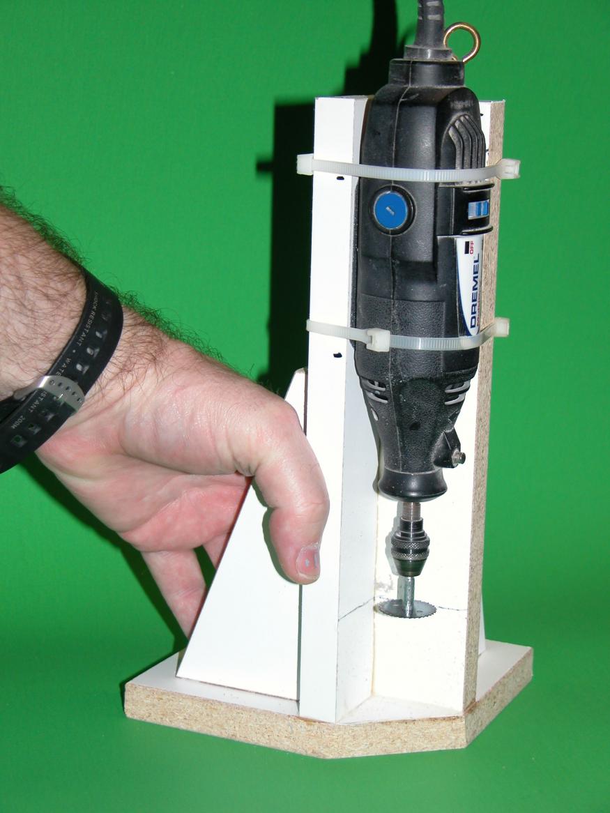

                      • 13998
                      Surface Gauge
                      Here, try this on for size:
                      • toppack
                        • Nov 2008
                        • 1124
                        I'm surprizer you haven't put a patent on that tool accessory. ;)

                          As for the those #3 details. Your going to have to measure to get them right. I just use a flexible ruler.

                            • 13998
                            Can't. I stole it.
                            • ConcreteTurtle
                              • Jan 2009
                              • 40
                              That's bang on Mr. Merriman, thank you!
                              I've got just the bit of chipboard for the job in the garage, and a nice glass sheet to move it all around on.
