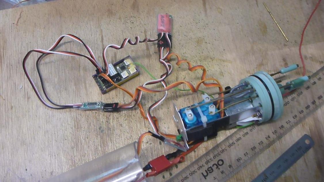

    I have a 2" sub-driver running an ADF-2 and a Lipo guard. I've just added an "X" tail mixer (high quality, un-named, unbranded, $10.00 at Hobbyking) and the system has gone nuts. When I remove the ADF-2 from the system everything works. With the ADF-2 plugged in, the ballast servo jitters at first, then pulses whilst the other servos jitter.
    I'm assuming that I have the world's crappiest 'X' tail, but I wonder if there is a simple fix or if anyone knows of a good quality mixer that won't send the ADF-2 nuts.

            If you can follow the spaghetti trail in this photograph it appears that I do, in fact, have it backwards.

                Thanks for posting the photo, that really helps. (Yes, I can follow your spaghetti trail.)
                First up is what David's already caught with respect to the order of signals in the ballast signal chain. (Thanks David!) You must have Rx ch 4 => LiPo Guard => ADF2 (failsafe) => Ballast servo.
                The next thing I see which confuses me is your ADF2 pitch side signal chain. It looks like you've connected Rx ch 2 => X-tail => ADF2 (pitch) => Pitch servo. If you've got an X-tail boat you ought to be using Rx ch 2 => ADF2 (pitch) => X-tail => X-tail servo.
                Now to jump back to what you've observed with the failsafe: Shutting down the radio doesn't trigger the ADF2's failsafe. I don't think you've fried anything, I think your receiver is activating its built-in failsafe; When you turn off your transmitter the receiver's failsafe instantly kicks in preventing the ADF2 from ever seeing a missing signal. This doesn't mean that you don't need the ADF2's failsafe in the chain as it's still needed for proper operation of the LiPo Guard when it detects that your batteries are flat, but ADF2 won't react to a lost transmitter signal because it will never see one. Can you turn the receiver failsafe off? (Or test the theory with a different receiver?) ADF2's failsafe gives you much more control over what your servos do when the signal is lost and it almost certainly waits for longer than your Rx before doing anything. All the receiver-based failsafes I've seen trip off after about a second of signal loss where ADF2 will hold for about 5 seconds before moving to the 1st failsafe position. If you're still running gas ballast this can make a big difference.
                Last thought for now: Pay careful attention to the indicator LEDs on the ADF2 at power-up as they tell you everything about how the ADF2 is operating and what it thinks it's supposed to be doing. When you first power up the green and red LEDs should both come on for about a second, then you'll get either a 2- or 3-blink flash pattern. Check the manual for the codes and make sure the flashes are consistent with the connections you've got. For your setup you should be seeing G+R then either G-R-G or G-G-R. If you disconnect only the failsafe line the pattern should change to G+R, G-G. (The ADF2 is telling you that when it configured at startup there was only a pitch signal, no ballast signal.)

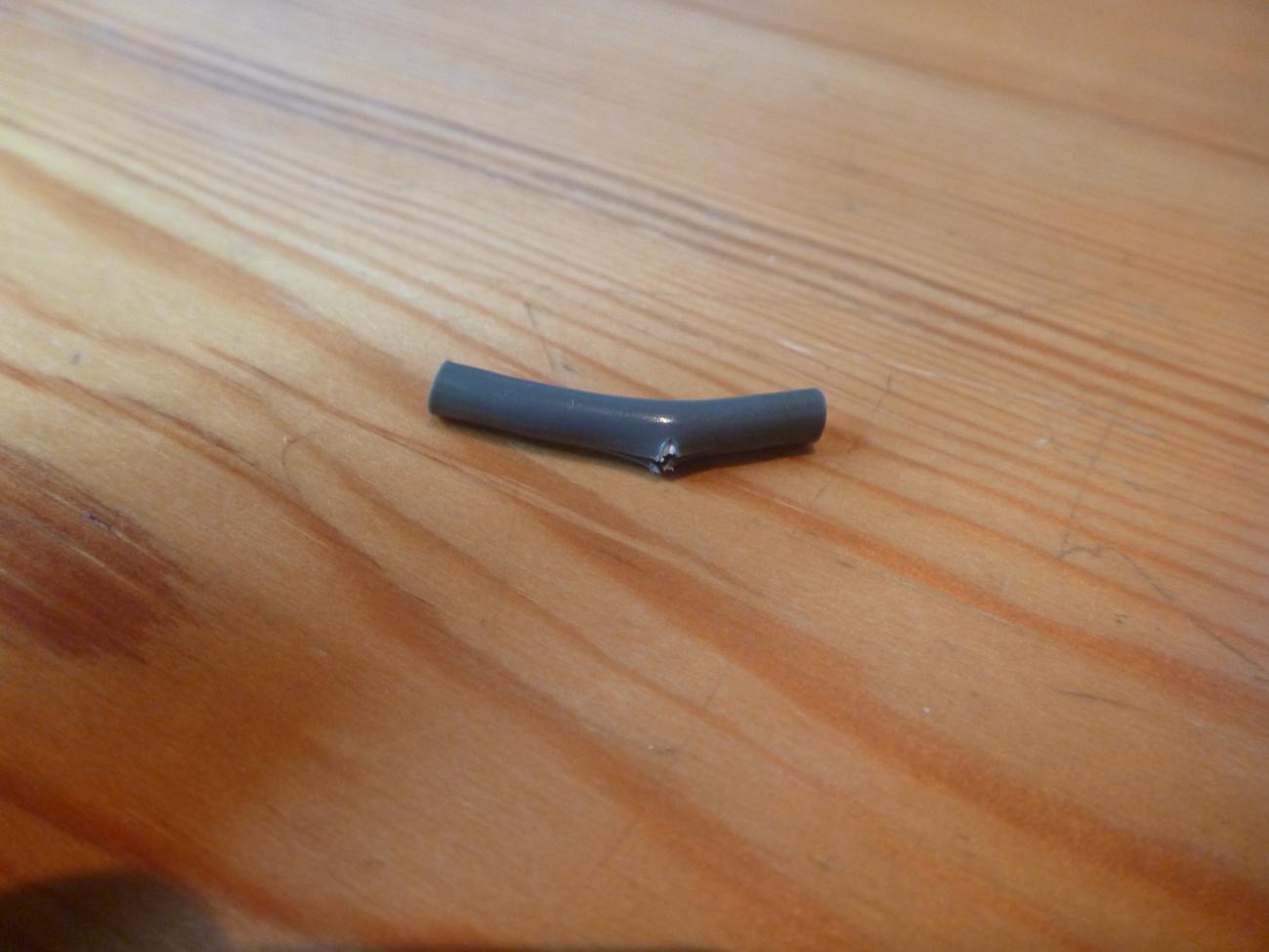

                    I was almost at the stage of putting the boat in the water when there was a small farting noise and this happened.
                    This is the small tube between the restrictor and the valve in the gas system. The tube came of the fitting once before and it looks like it might have been damaged when I slid it back on. There is a small abrasion at the centre of the rupture which might have been the reason for the failure. There is a replacement in the 212 kit so I've fitted that this afternoon and I'm about to back to the water.
