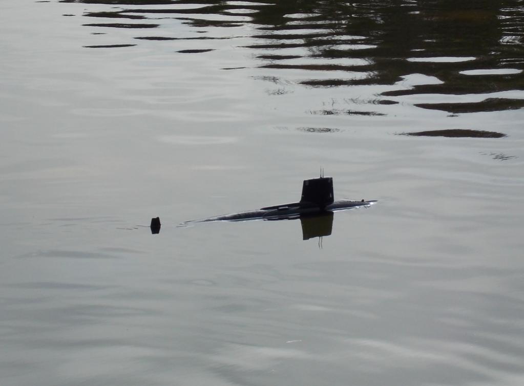

    Bruce, Sub looks absolutely great in the surface shots, shame about the rudder. I had the propulsor fall off the Trafalgar once, still to this day I am amazed that I managed to recover it, very,very strong loctite holding it on now !
    Peter
    Thx Peter,
    the matt black auto paint came up really well (its the type used for GT stripes)
    unfortunately the pond we run at has a large duck population and consquently 2" layer of muck on the bottom, after the council does their once a year clean out it is clean for a short time before returning to its regular condition....

    Shark had first proper pond test today it was a mixed bag....on one hand no water in SD and ran well on surface, on the other hand couldn't achieve PD (pond must be denser water than the bath and I forgot to bring spare ballast!) was bow up when tank fully blown, but the worst thing was when I got home and was cleaning boat noticed bottom rudder is GONE!! must of detached during second run just before I packed up (grub screw was as tight as possible without stripping too.....grrrrr) going back to pond later (hopefully wind will shift around so the layer of scum obscuring surface will move to other side of pond!!
    But I didn't have the worst day at the Pond !! Clubmate Jim's Daring class HMAS Vampire and Brenton's River class HMAS Parramatta had an "Incident" resulting in Vampire being rolled over on her side and Vince wading out for recovery!! SEE PIX!!

    Shark on surface test run...
