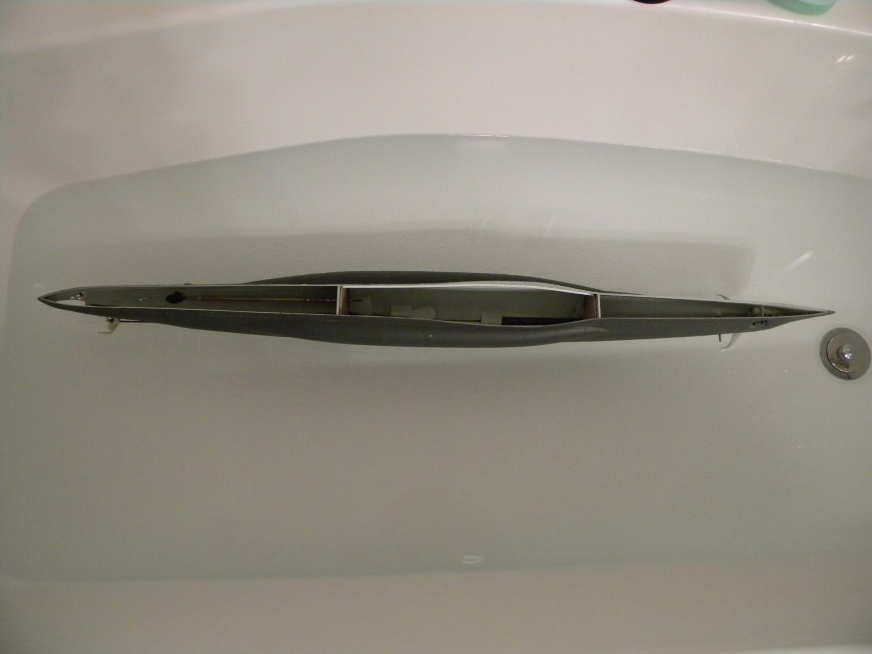

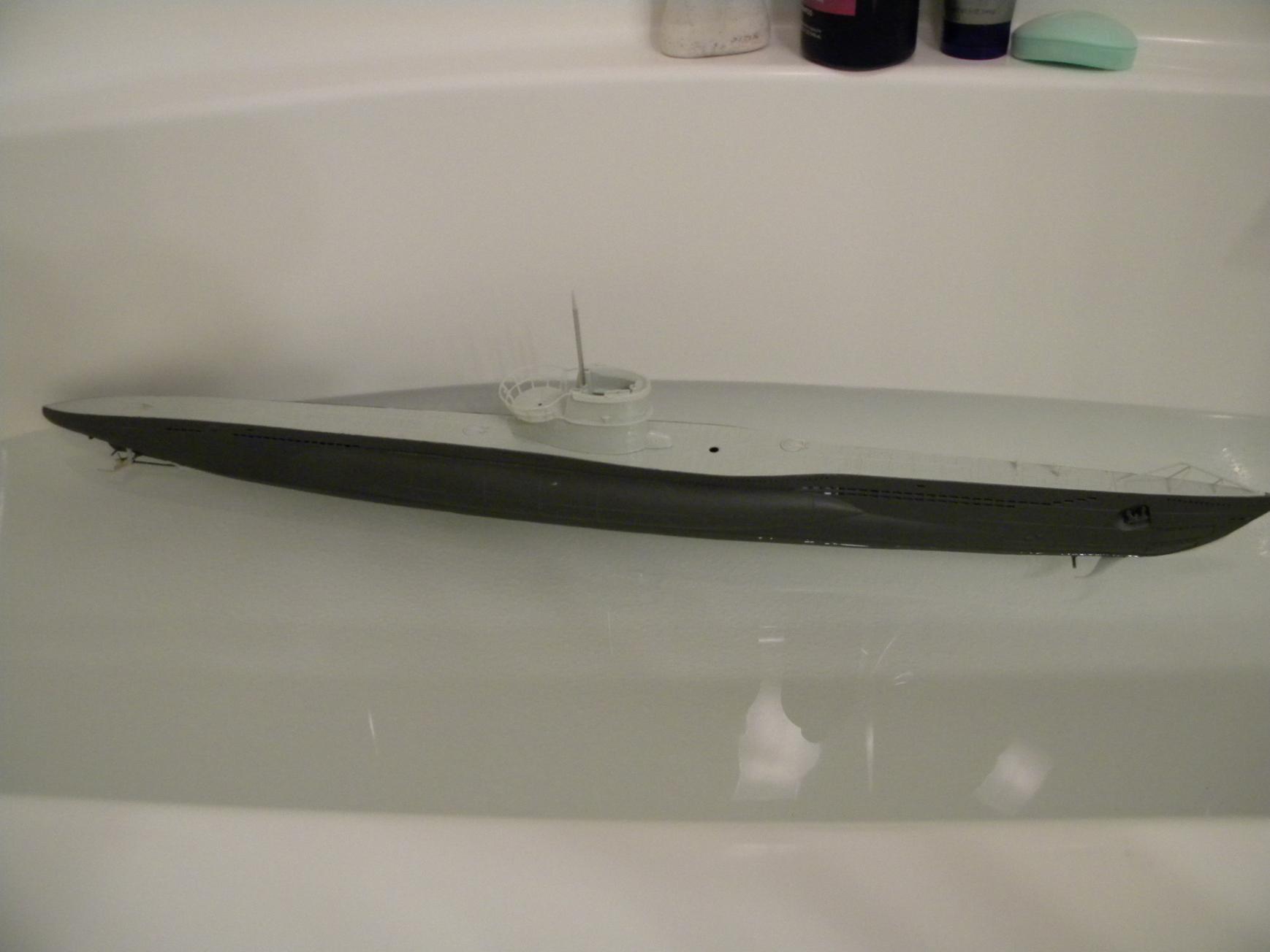

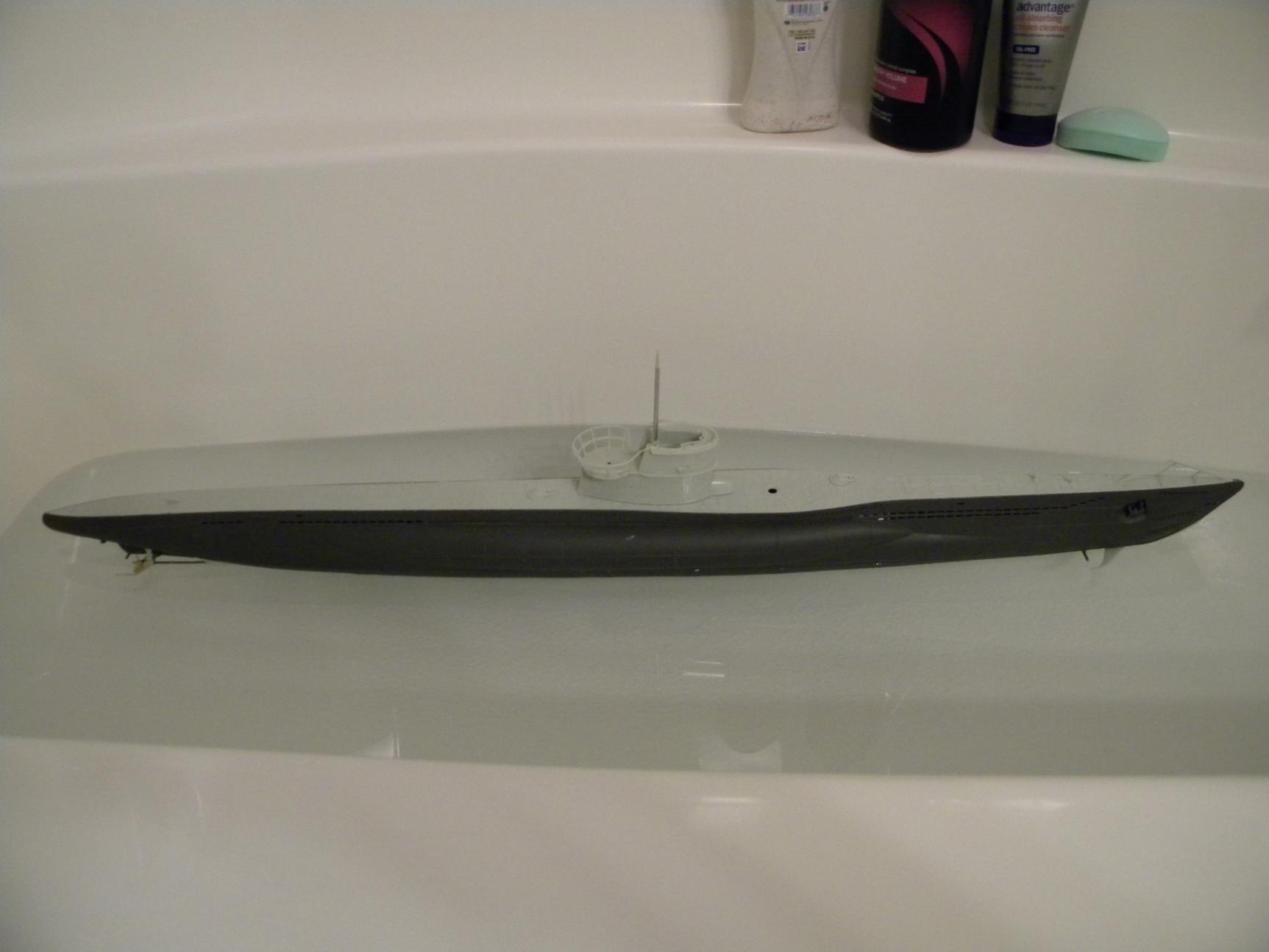

    revell 1/72 VIIc test
    will be running one of these and the IXc. stock deck. what did you all do for holes??
    • 13971
    All the circles up on deck that indicated retracted bollards, I opened up. Open up all the limber holes on the bottom and that will take care of your flood-drain task.
