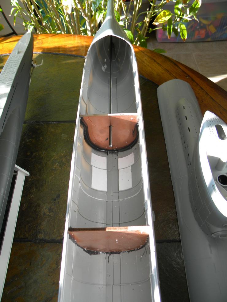

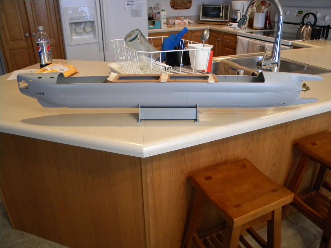

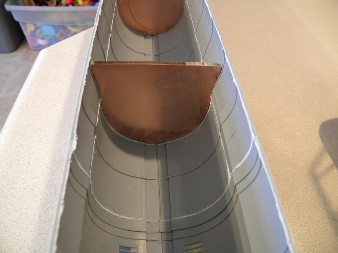

    I ordered rcsubworkshops wtc for this kit. it is not good. but spent the money so I am reworking it. I cut new bulkheads, which now fit very nice. small gaps which the glue will fill. I shortened the wtc since I want to go dynamic on this one. I also centered it. I may be way off or pretty close?? we shall see. any input from the SUB GOD would be welcomed!!!

    Please keep us informed of the "rework"! If not too terribly costly, may well work out for those of us with limited funds, but with all the desire needed to become sub sailors!
    Best of luck!
    BTW: Your new bulkheads are looking pretty well done to me, but then again, I'm still a "sub-grasshopper"!!

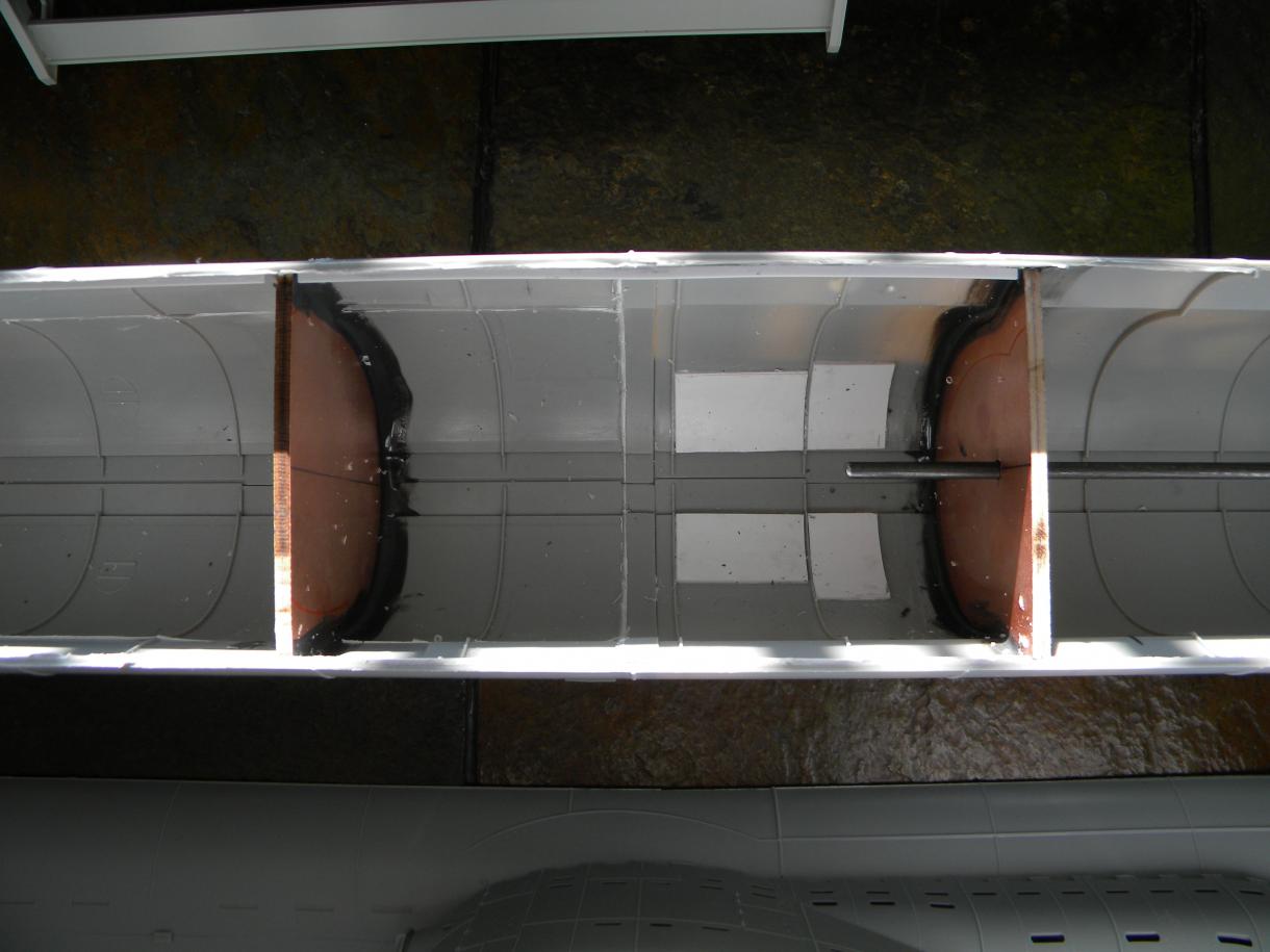

      Nice work. I believe the expansion rates of acrylic and styrene are about the same, so that won't be an issue -- just make sure you adhere the bulkheads with an RTV silicon (Permatex gasket-maker, blue), to allow for the slight shift between the two materials with quick temperature changes (dunking a hot model that has been sitting in July sun into much cooler water).
      You were too kind as to your description of this WTC 'kit'. I'll say what you won't: it's a pile of warmed over **** in a pizza-box!
      You're making a silk purse from a pigs ear. Good solid work. Keep at it, pal.

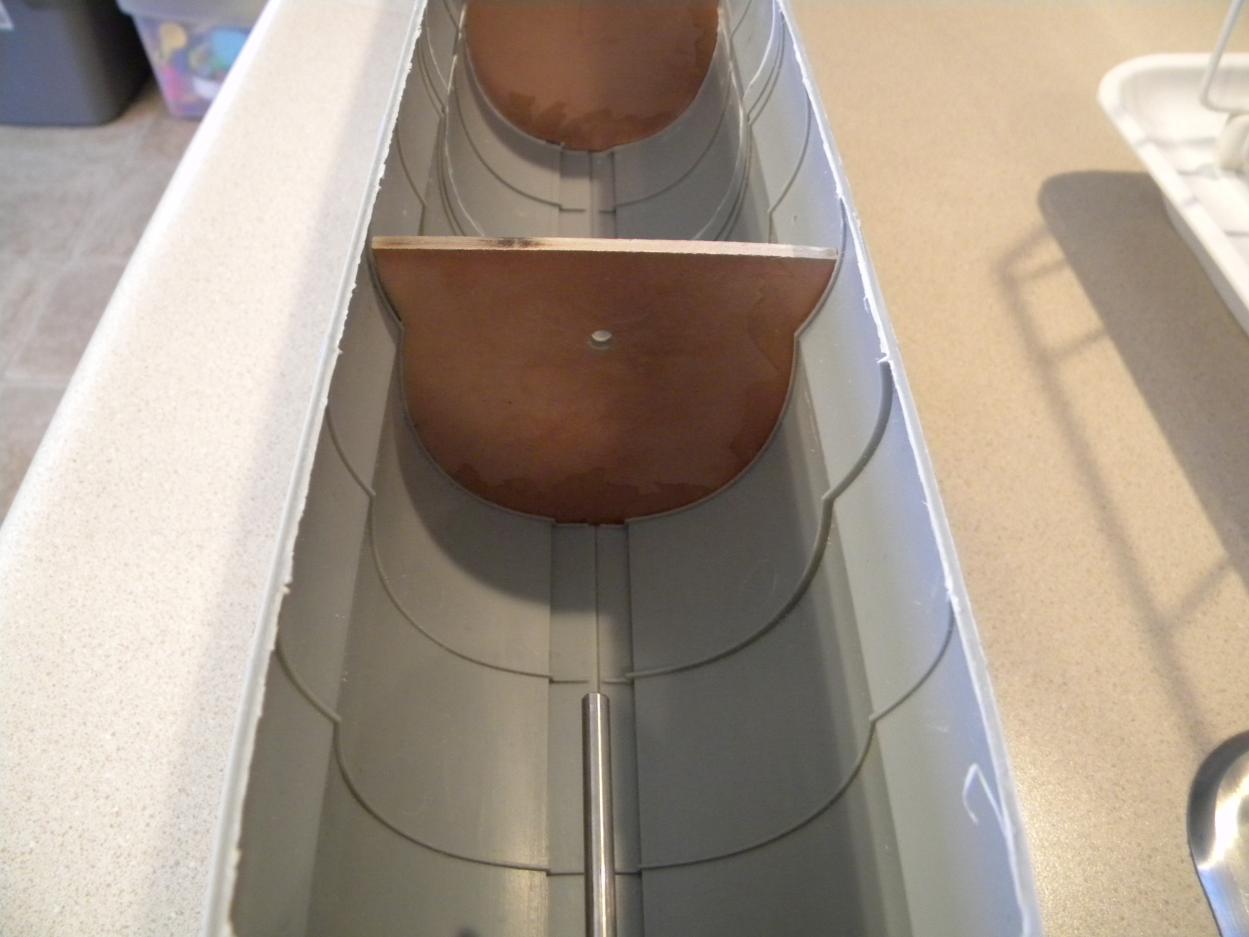

        Thanks Dave. I am having a blast. lets see how it turns out???? to scary Shaggy:))))) so just RTV. I was going to jb weld the frame in then rtv around both sides.

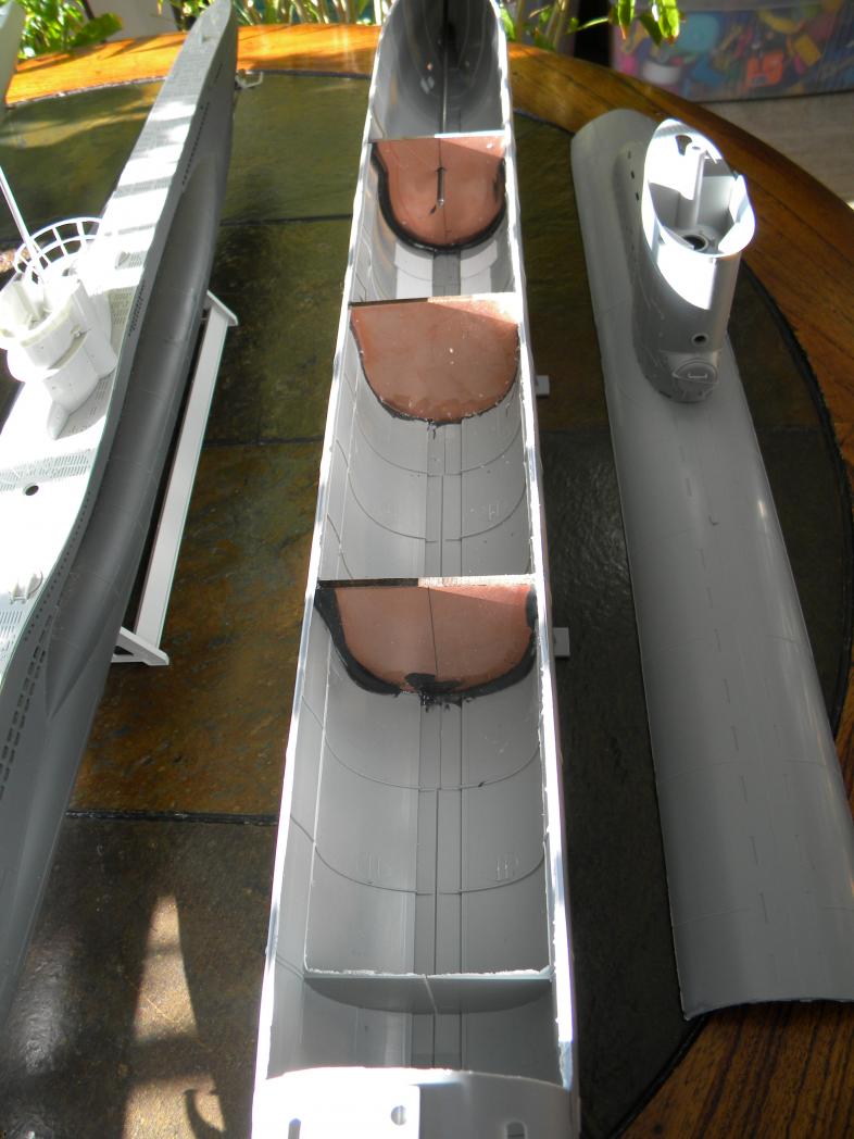

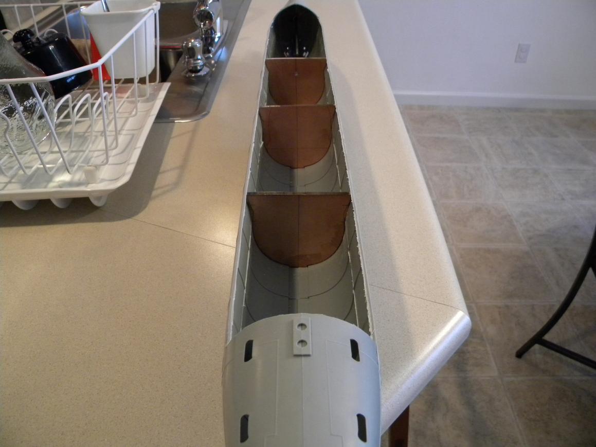

              glued in the frames set my shaft. looks really good. I will rtv all the seams once the lips I installed dry. this way when I mount the top I can squish the silicone and fill the seam. hope all this works like I picture it in my head??? these are very cool.
                Excellent work. I am jealous of your hull long cut. It looks well done.
                The linkage for the rudder, are you going to open a hatch back there?

                  yes. I am working on one thing at a time. and trying to control the urge to hurry. it needs to be water tight. as for my cut. not perfect. the end cuts are ugly. but I will fix that. never be afraid to make a mistake. this is about having fun. as long as it runs. who cares. just do your best. there is only one SUB GOD!!:)))

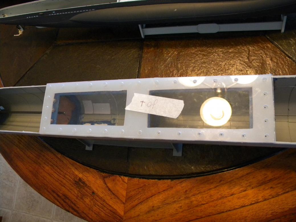

                    Looks nice. What are those white rectangular pieces in the bottom?
                    • cconeill
                      • Dec 2010
                      • 102
                      vent plugs. I will rtv over them.

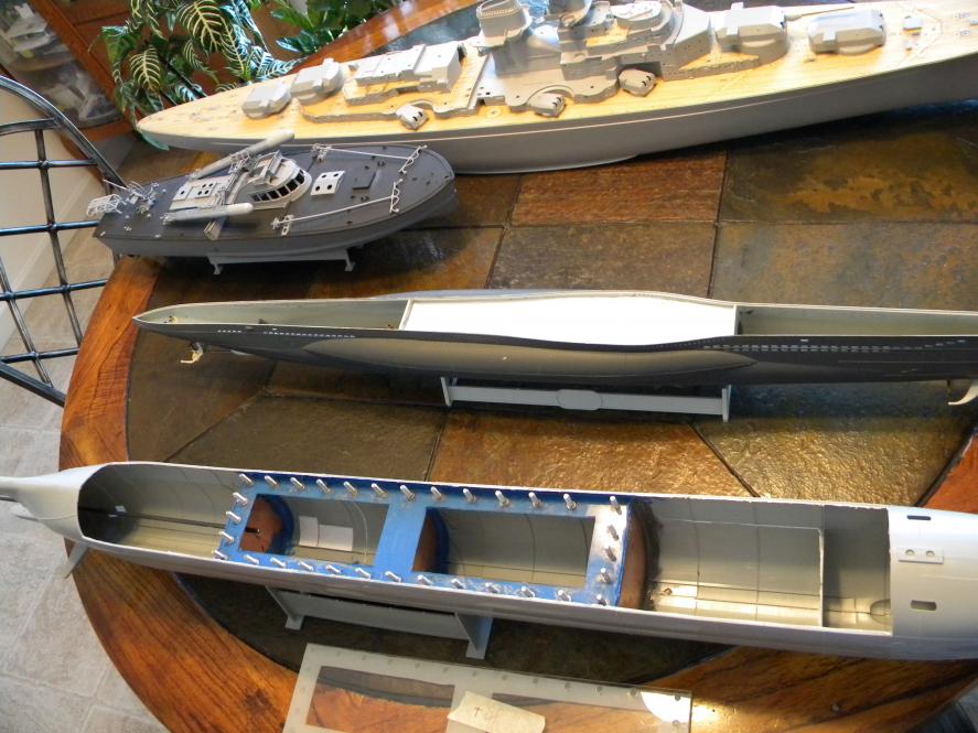

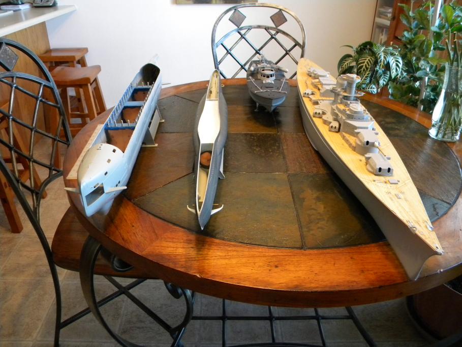

                        here is what I have done for now. working on my xcat. will be wild.
                          Looks like the Bismark, and a type 7 and the 23. Couldnt tell you about the Foreign looking PT boat. Since your going to have a lot of nuts to take off that WTC, you might think about getting a Li-ion screwdriver and hex adapter to make it quicker.
                          • cconeill
                            • Dec 2010
                            • 102
                            trumpeter Bismark, revell VIIc, italeri M.A.S. pt. that screwdriver will be a must have. this is old school. but it works. I hope??????
                              Should work if you ballast the hull low enough in the water and your motor/prop have enough push. I ran the Albacore that way for a month back when I first got started. Worked great in the pool.
