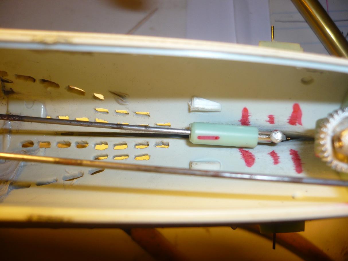

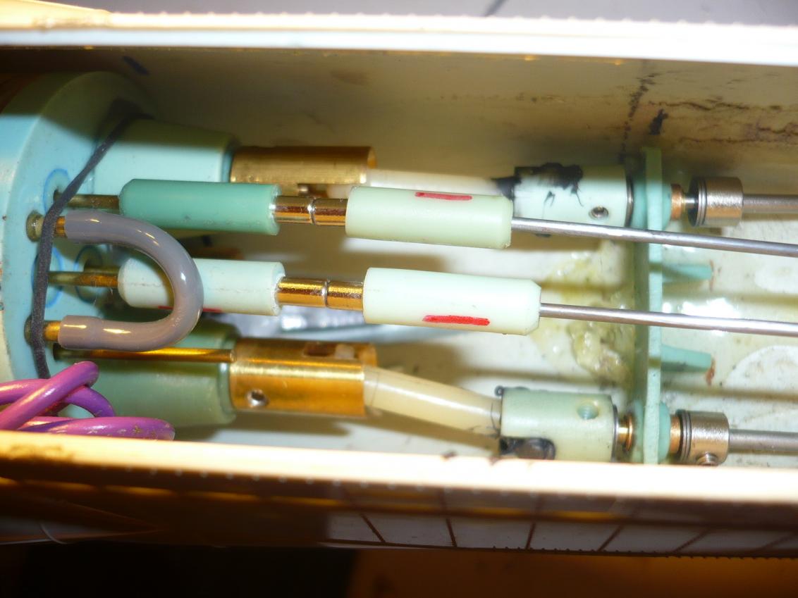

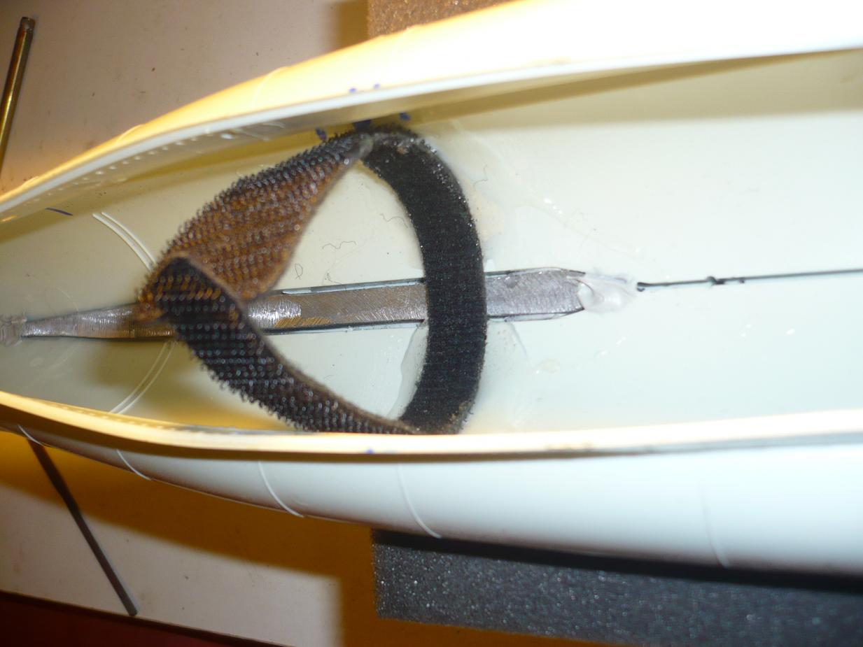

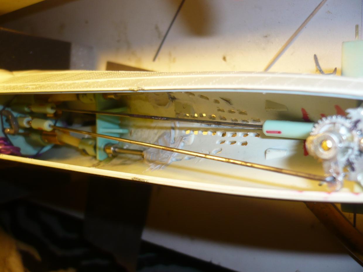

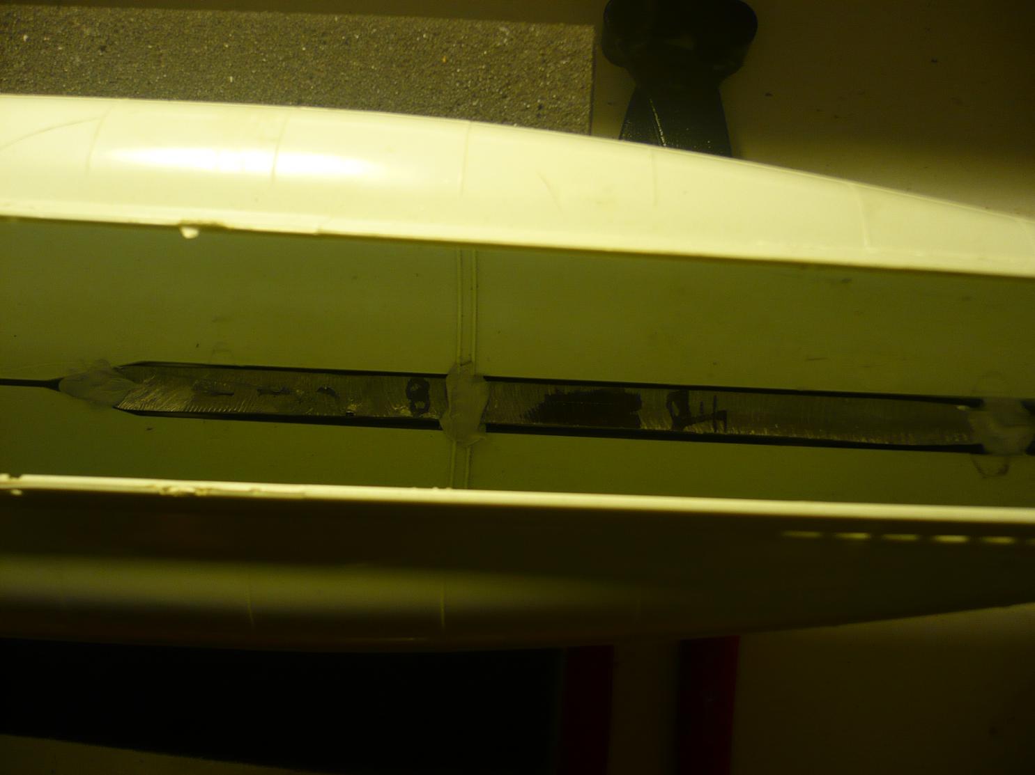

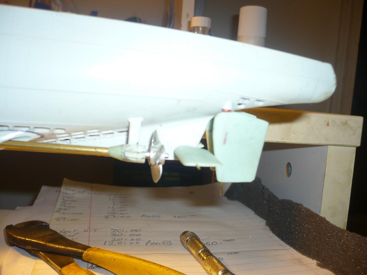

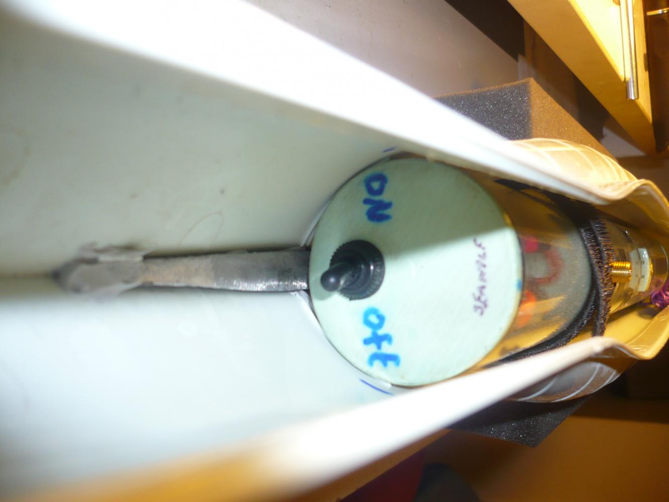

    So I got my keel weights cast and fitted at 8.3 oz total (rear 4.4 g, ft 3.9) and have .2 oz pellets to move forward to get the 9 oz total you need for the VIIc.
    Drive train is in, hold down strap and index pin in, rudder and rear planes fabbed to length... [Query]????
    Do you use epoxy or RTV to fit the klicons to the rod???? and most especialy the s/d push rods?
    I'm guessing RTV or loctite red for the s/d push rods??????
    Also other than the quick glimpses of your VIIC youtube video, [are] there any pics of the bends for the bow plane rod? When I get it bent, I [will] post a pic and you tell me your opinion (please) as i want to do this right the 1st time...
    Also as a side note, I am going to purchace a new charger for lipo. Other than the 50w or higher rating, do you have a recomendation for a good charger that comes with the power supply cords???

          I have no problem epoxying the kilcons to the linkage rods.. what I wanted to know is if I should use rtv to hold the klicons to the servo pushrod ends so the moter/bulkhead can still be serviced fo the seals later if needed.. as far as the charger I was hopeing someone would have a favorite.. I hve been considering this one Thunder Power TP610C 1-6 Cell LiPo AC/DC Charger ....
          • Slats
            • 1776
            I wouldn't use RTV - I think you'll find after a while the RTV will expand a bit as you asking it to be the glue in a moving part. It will eventually slip off.
            I find kilcons are best adhered to the push rod with a tiny drop of CA - not expoxy. If you need service the inner motor tray I simply unscrew and remove the servo horn with the push rod attached from the servo. Too easy.

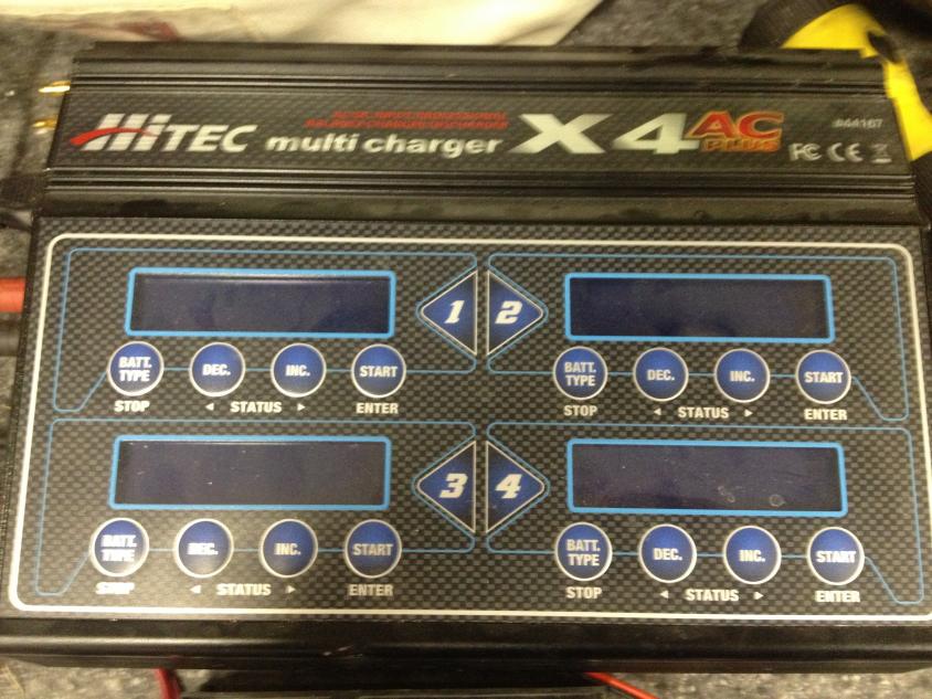

ID:	81208 This is my favorite charger. It came with all the plugs I could ever want and balancing adaptors in three styles. If your balancing lead is long enough, you don't even need to use the adaptors and plug right in the side. Nothing like charging four batteries at the same time. Every battery in the house is charged on it. No failures or complaints yet.

                im afraid to ask buelman1 but how much???????? and dave thoughts on work done so far??????am i on the right track?????
                  That charger will set you back about $210 (good investment), there is also a single charger for $63 http://www3.towerhobbies.com/cgi-bin...?&I=LXBJBY&P=7
                  I cannot recommend mine.... it is fair at best, but I do not get consistent charges on it and it is funny on things like LiFe. It is a Sigma II EQ.
                  • Buellman1
                    • 93
                    Yes the charger is a bit expensive, but in my house its worth every penny. Not only do we have a pond, but a full off road course that the we all race on. Went from 8 hrs of charging after races to 2 hours. I charge all my batterys at a rate to fill in one hour.
