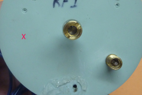

          proposed location for antenna lug
          As you can see, I've removed the existing antenna lug from the bulkhead. I felt it was too close to the motor can for connecting an antenna lead to it. I know it could be done but I figured I'd kill two birds with one stone: a) give myself more room to connect a spade lug to the inside post to connect the antenna and b) physically move the antenna a little farther away from the motor itself.
          I would like to create a new antenna lug at the spot indicated by the red "X" (see attached picture...Click image for larger version
Name:	proposed location for antenna lug.jpg
ID:	77067) but thought I would check with you first to make sure that if I drill a hole at that spot I wouldn't be drilling into the internal gear drive in the bulkhead. If I install it there, I'll still be able to use the antenna wire and strain relief mounting that is already there.
          I know you used brass #4-40 hardware for the antenna lug. I'll probably use brass #6 hardware as it's easier to handle with my aging fingers.
          Please advise,
          Dan
            • 14010
            Remove the motor-bulkhead back-plate to be sure you don't drill into the nylon bevel gear. If you're clear, drill away. Sure, a 6-36 stud is fine.
            • roedj
              • Sep 2008
              • 564
              I removed the motor back-plate (nice design BTW) and I should be OK to drill and mount another antenna lug at the spot indicated in the photo.
              Sorry to butcher your handiwork but I just didn't feel confident in attaching an antenna wire so close to the motor can inside the WTC. There was literally less than a millimeter between the lug and the motor can. To me it was a short waiting to happen. I realize I could've put some electrical tape in there to shield against this possibility but, as I said, if I move the antenna lug out to the red "X" I get the antenna away from the motor both electromagnetically and physically.
              Thanks for your help,
              Dan
