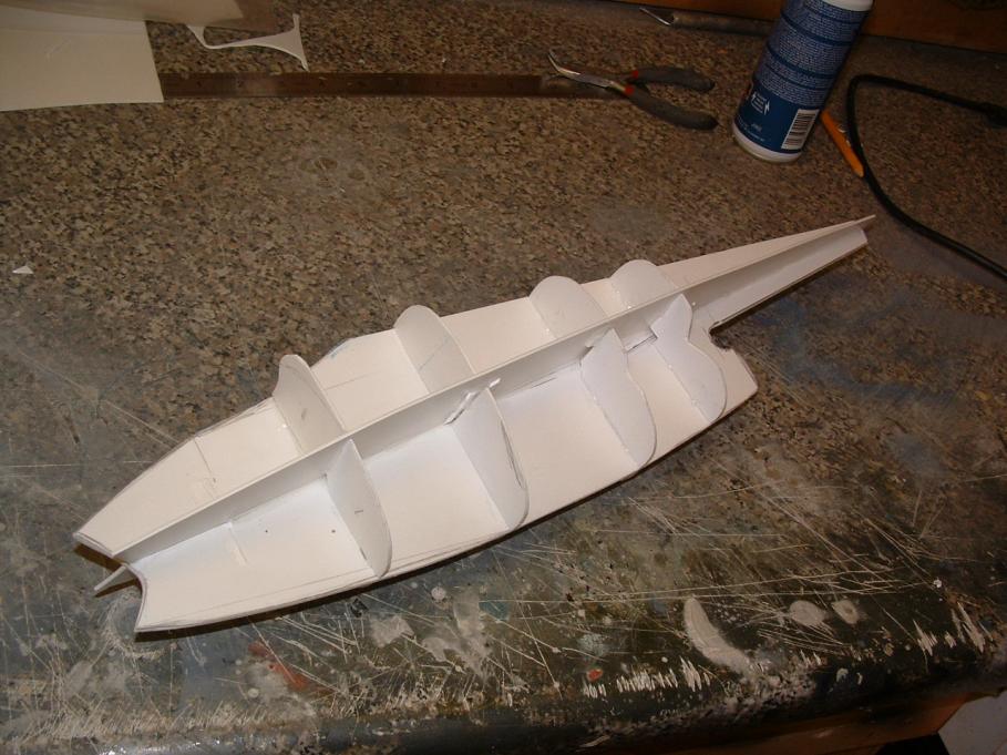

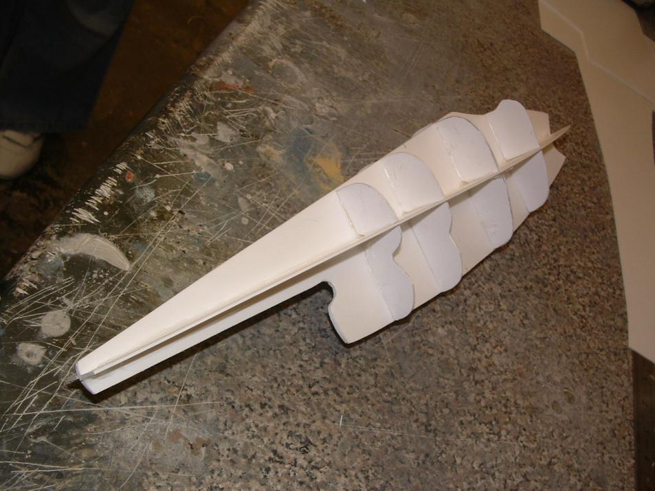

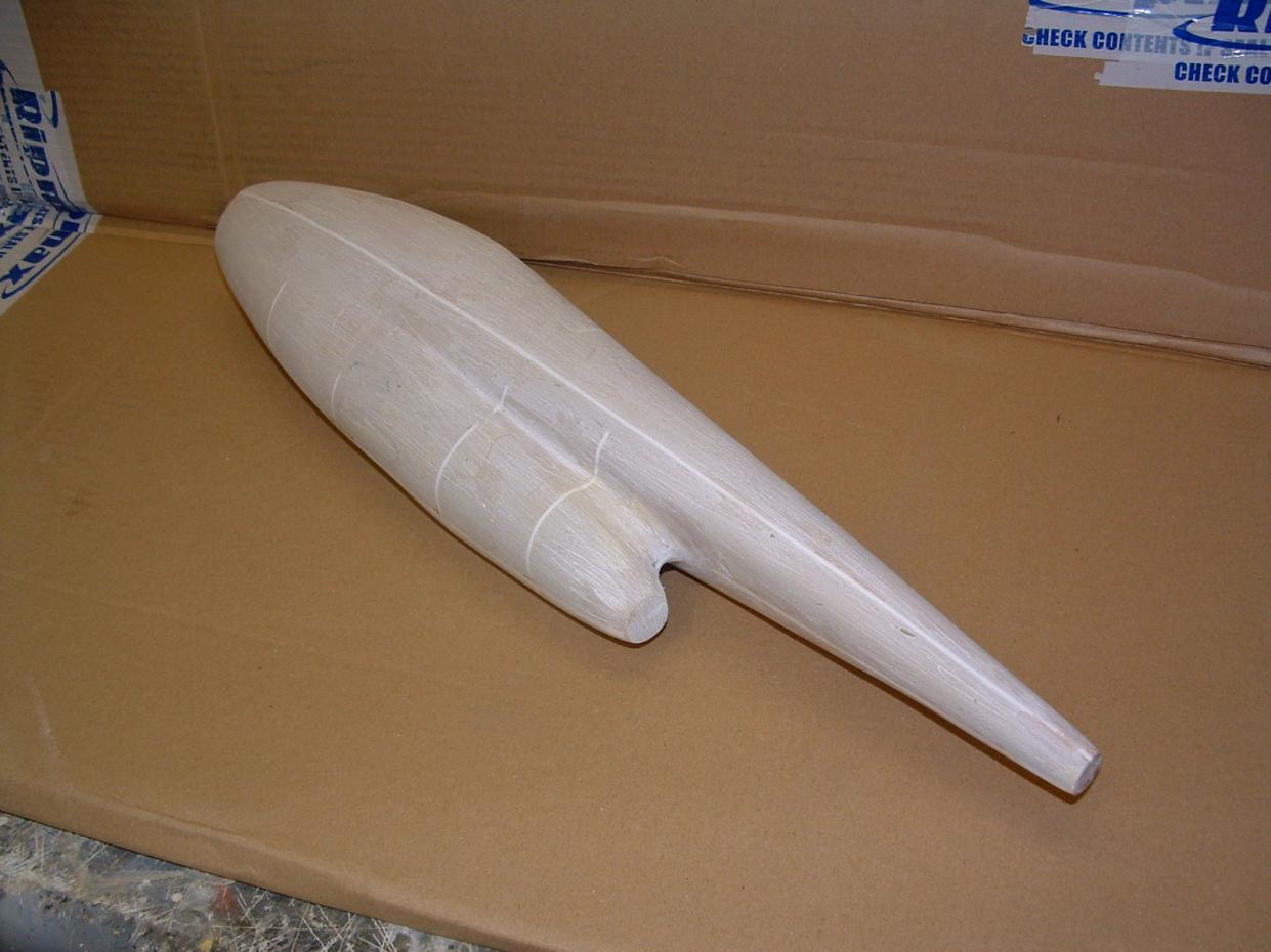

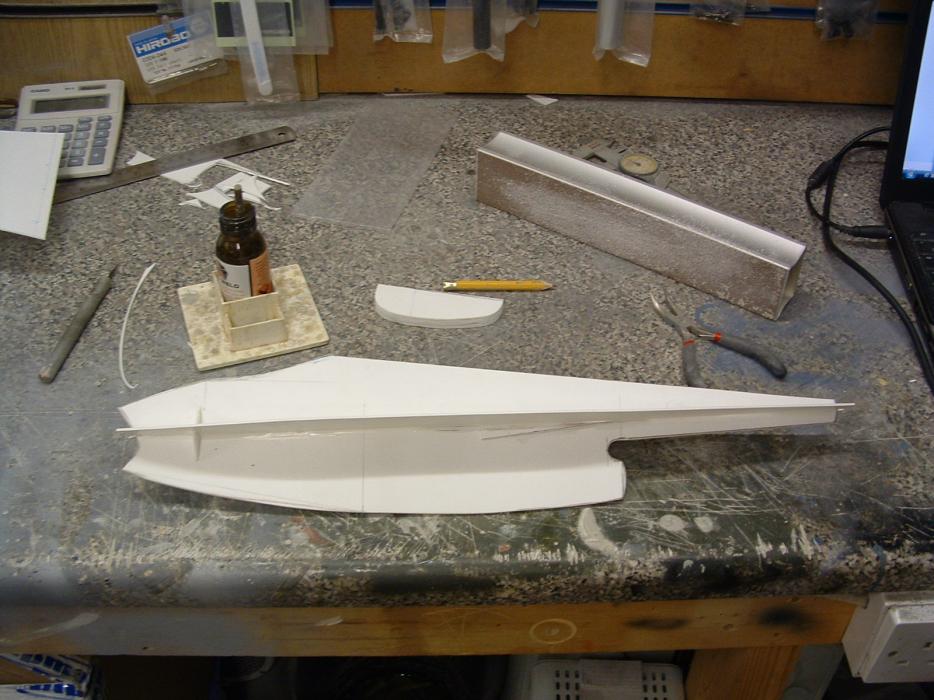

    Hello everybody, I am the significant other of RCnut, lol. I've started this build log to show you what I'm building, Bit obvious that lol. I am doing the Sub that Agent X20 used in several episodes. The method used to construct the Master is the same RC used on the stingray. The size will compliment the Stingray and the terrorfish. Below are a couple of pictures of progress so far. It wont be as quick a build as RCs as I dont have as much time to devote as he does.

      The keel and bulkheads, what material?

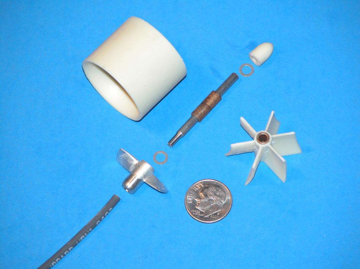

      A simple pump-jet for this X-5 looking fish.

        No sorry not done yet lol. The material I'm using is plasticard (styrene sheet). Afterwards I'll use filler in the gaps. As for powering it RC has got some ideas floating round already.

          Well, as soon as I discharge my STINGRAY obligations let me know what I can do in the way of pump-jet, Sub-Driver or anything else I can do to help with X-20's ride. The gal in the shop is my counter-part, Ellie. Not much of a model builder, but one hell of a shop drone -- great at production work.
          If I can't adapt one of my PJ's for the fish, then I can certainly manufacture a unit to do the job.

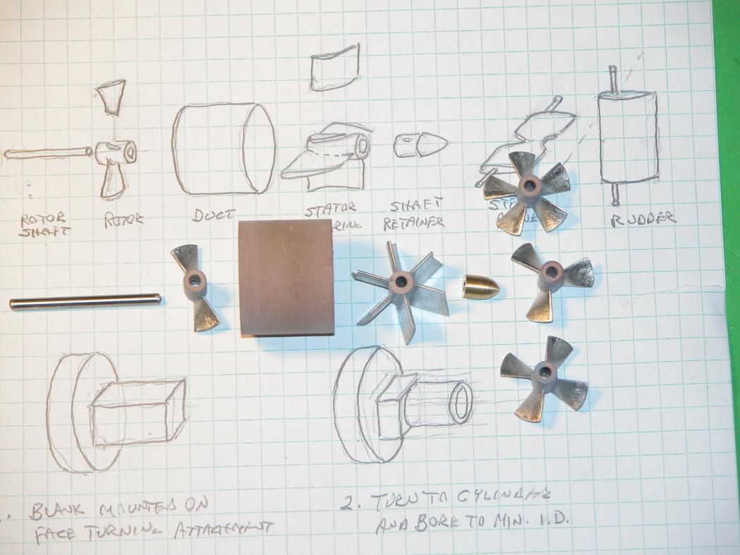

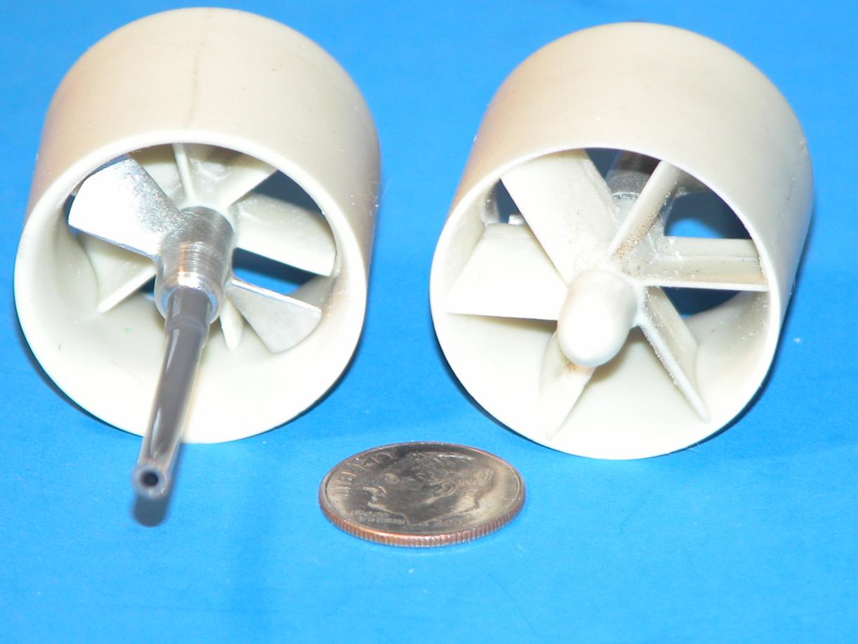

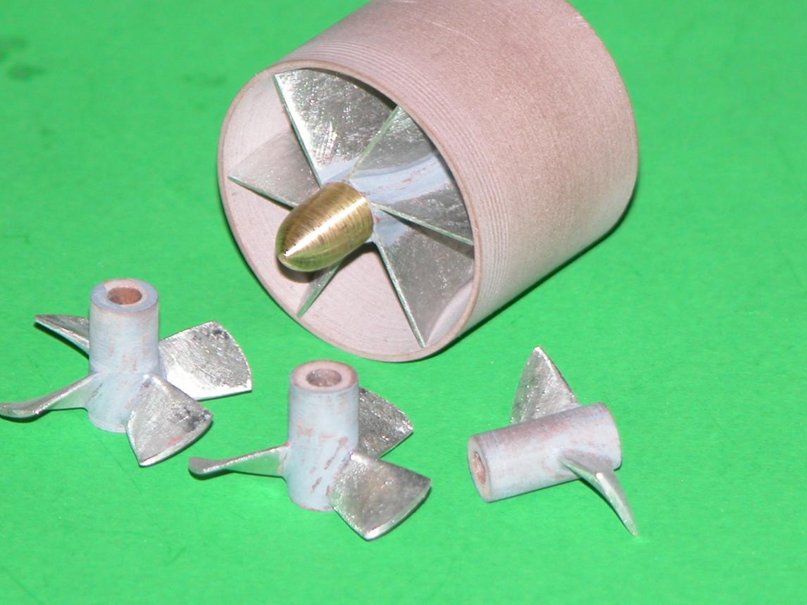

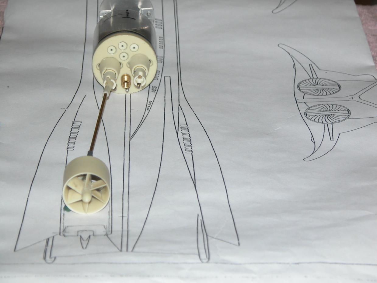

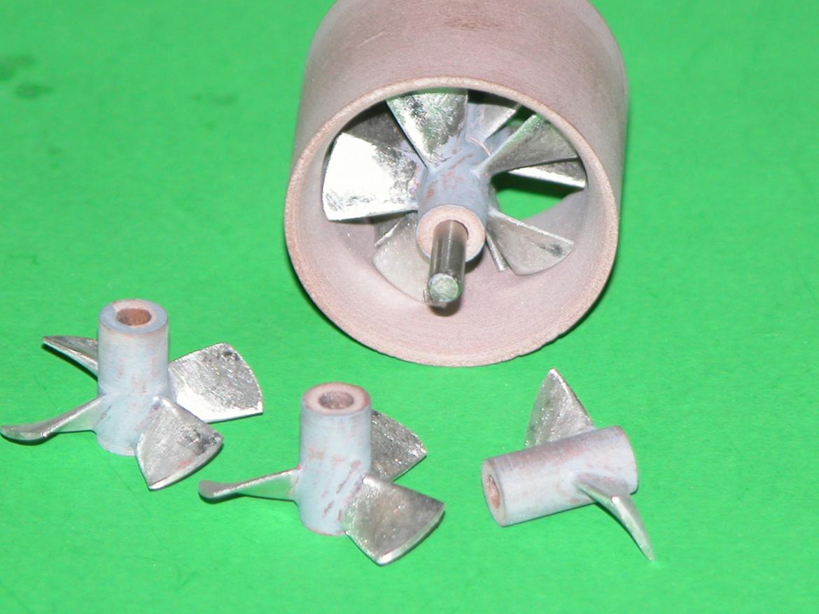

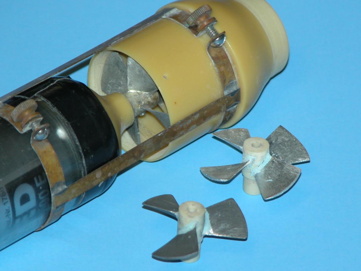

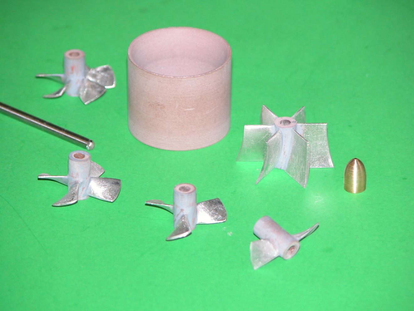

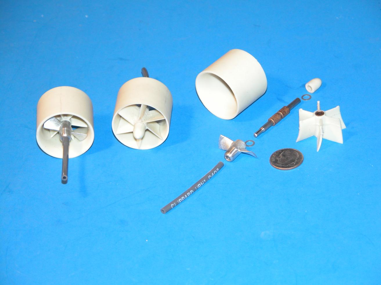

                  I think we'll be best served by adapting the Moebius SEAVIEW axial-flow PJ for the X20 submarine -- taking advantage of the intake and nozzels axial orientation to one another. Using the bottom-of-the-boat intake like the commercial units employed on your STINGRAY and big SKY-DIVER is fine, but wasted effort within the straight-flow-path of the X20 submarines propulsion duct. What is the mean diameter of the propulsion duct aboard your model, Linda?
                  Here's the proposed pump-jet (that's Ellie, my partner-in-crime in the first shot):

ID:	73349Click image for larger version
ID:	73350Click image for larger version
ID:	73351Click image for larger version
ID:	73352Click image for larger version
ID:	73353Click image for larger version
ID:	73354Click image for larger version

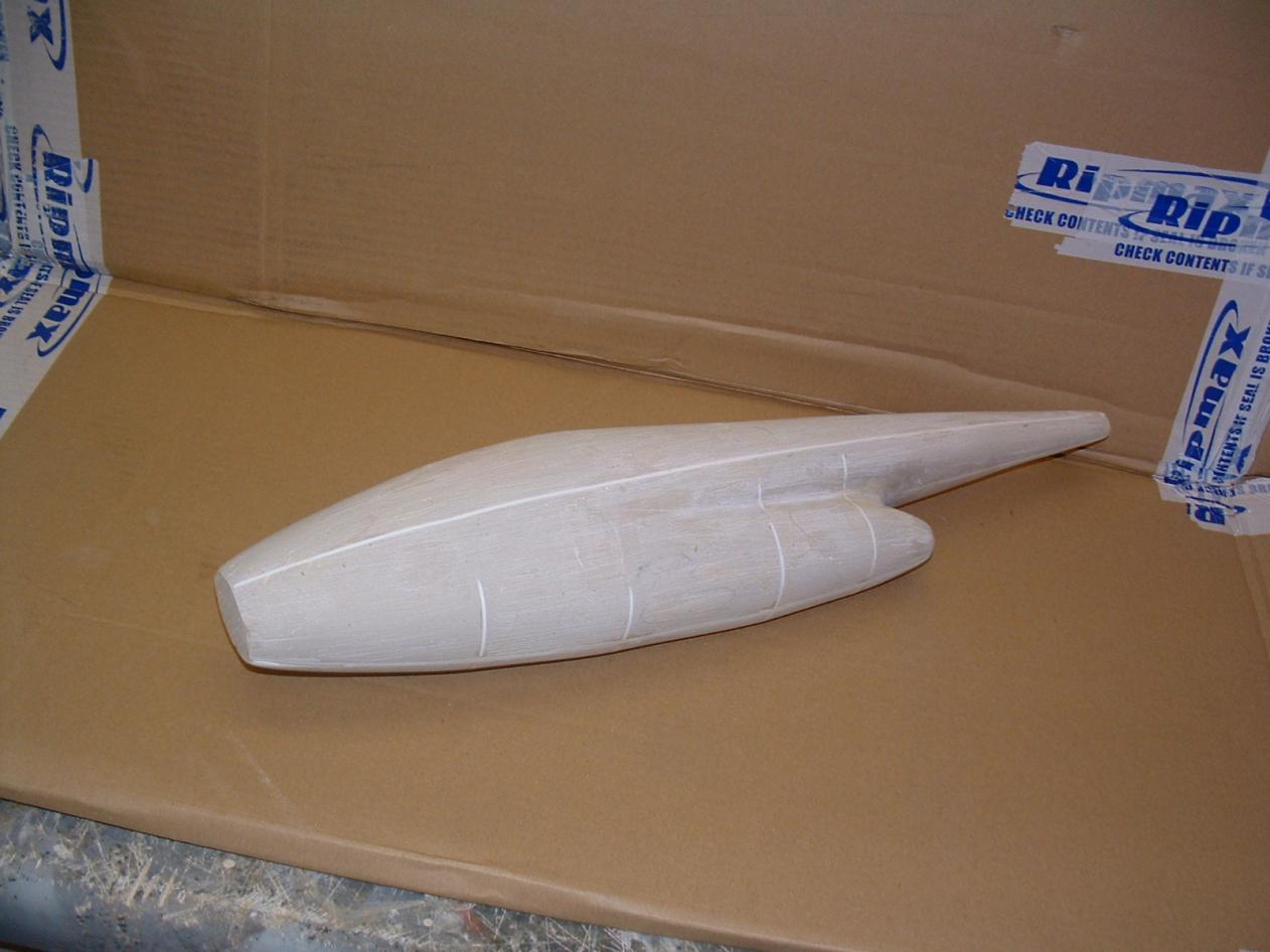

                              Hi guys, Haven't been on here for a while but managed to do a bit yesterday and here are the results
