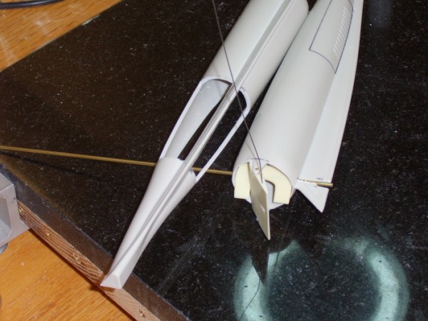

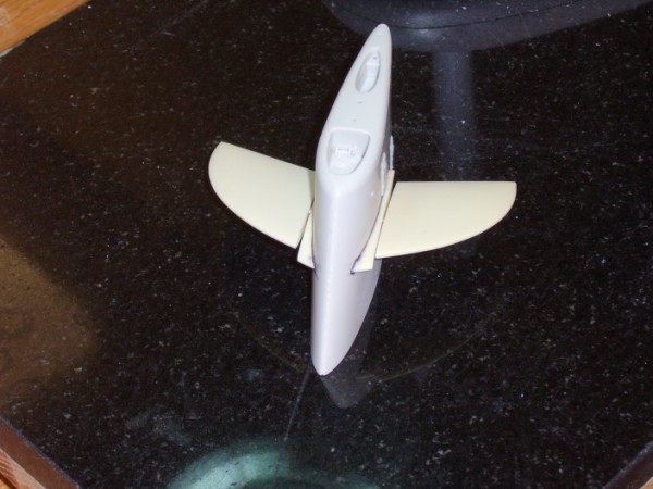

                My build is going slowly but I am making some progress. To drill that hole I got a 1/32" half round drill bit, then I carefully clamped each rudder perpendicular in the table vise of my drill press and then SLOWLY and CAREFULLY peck drilled the hole. I decided not to drill the hole all the way through, just down to the rectangular hole and about 1/8" farther. Putting a pin in from the top should work fine.
                I'm including some pictures of what little progress I have made so far.

                  Nice pictures and great work. Thanks for sharing.
                  What is that line coming from the rudder?
                  • mickelsen
                    • 94
                    Thanks for the compliment. That line is a piece of piano wire I stuck into the 1/32" hole drilled in the rudder to show where it is.
                    You might be able to see where the hole in the horizontal stern plane broke out when I was drilling it. I think that one of my biggest challenges is going to be patching, filling, sanding, and painting that stern plane so that it looks untouched.

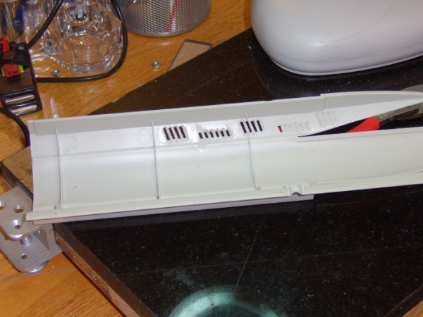

                          I made a mistake and tried to finish off some of the limber holes by using a brush in a mototool to smooth the edges. Now I have to fill in the gouges I made. I've included some pictures of the damage including one where I've highlighted the damage in blue.
                          It's going to be difficult to fill in the damage and preserve the edges of the limber holes. I really don't know how to do it and I would appreciate some suggestions and instruction as to how to proceed. I know that some of you guys could fill this in, sand it and paint it and make it look as if nothing ever happened, and any help would be appreciated.

                            • 14009
                            (in the heroic voice of the off-stage announcer)
                            This is a job for CA, baking soda, and a flat Jeweler's file!
                            Go get 'em Tiger! Now you know why high speed tools and polystyrene don't mix.
