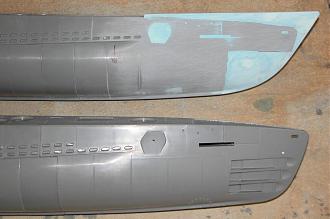

      When blanking off holes, slots etc in injection plastic kits, I use bits of plasticard or sprue, and solvent weld them in, and leave them slightly proud of the surface. Once dry, I sand that back to the correct contour, and there you have a repair that's as strong as the rest of hull.
      We seem to be on the same page here, except I'm suggesting a two part soft filler (and easy to sand) to bring it up to contour.
      "I would have welded the styrene sheets to the inside with Solvent Weld, as this would be a much better bond, then filled the shallow hole with a polyester filler like Evercoat Easy Sand."
      Single pack, solvent drying glaze, used as an adhesive to hold the styrene in place is doomed to failure, as it has poor adhesive strength and shrinks on cure. It should only be applied in thin layers, and allowed to thoroughly dry between coats.

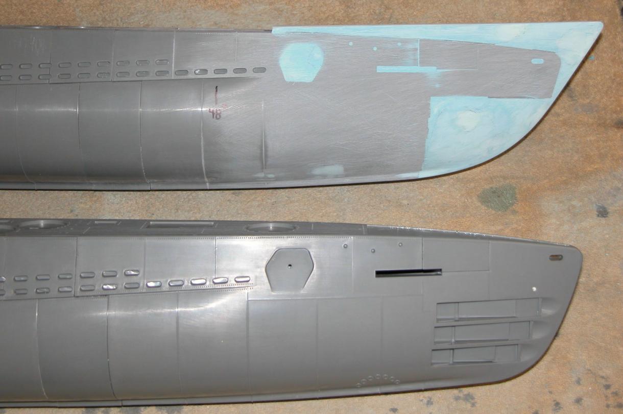

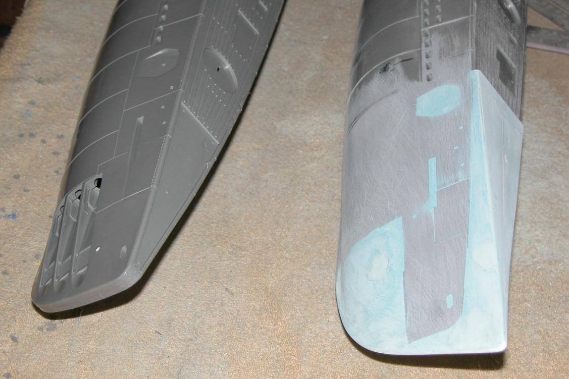

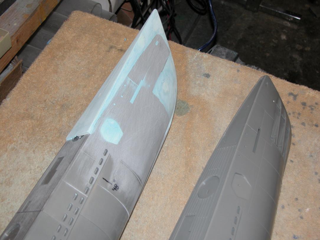

        Filling the holes went fine. "Putty, sand and repeat" did the job. Sure. Your way might have been easier. But I have to work with what I have available. I live out in the country where, as my wife says, "There are more cows than people."
        Made enough progress to button up the hull today.

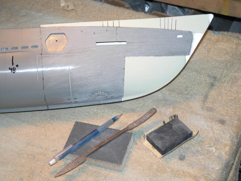

        Here are the axes for the control surfaces installed. I used 1/8 inch K&S brass rods and sleeves for this. I roughed up the surfaces that will have to bind with the rudders and planes.

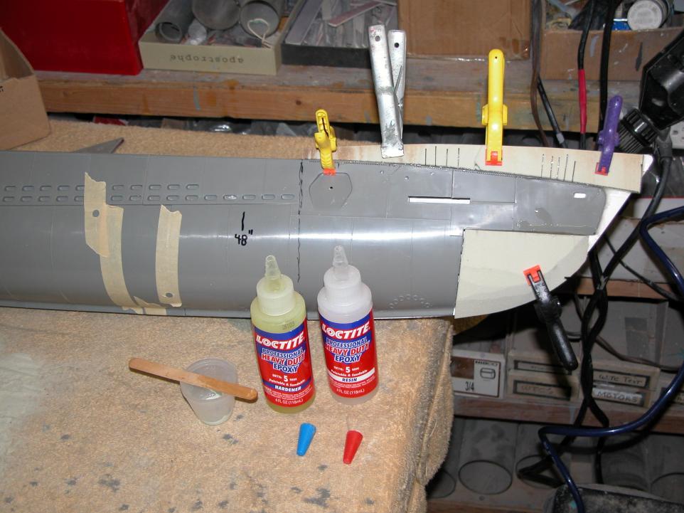

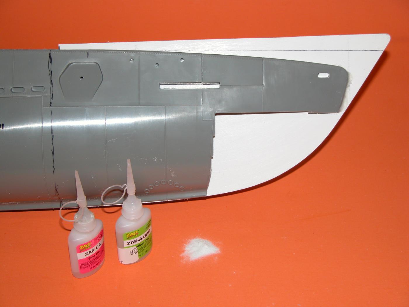

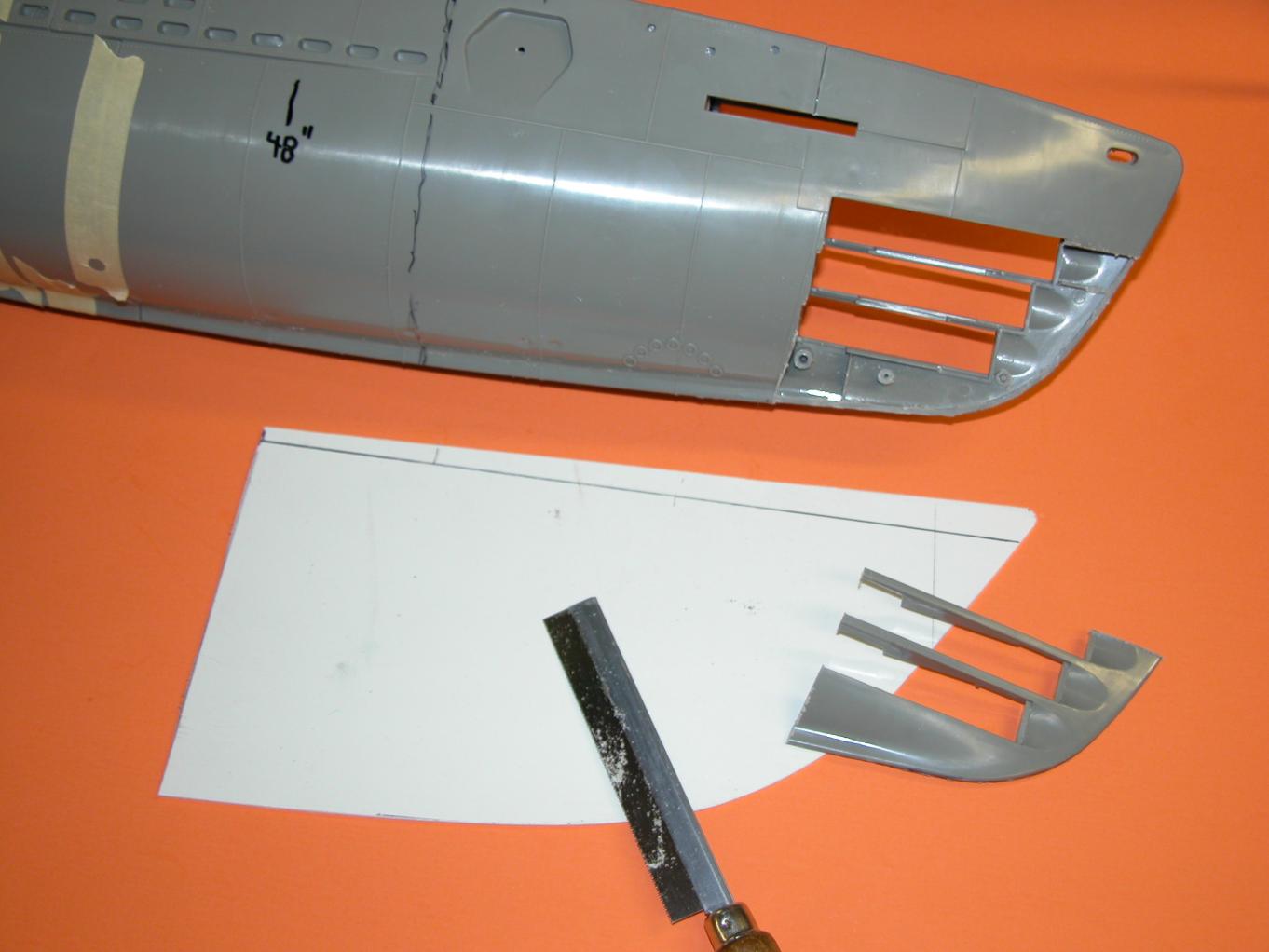

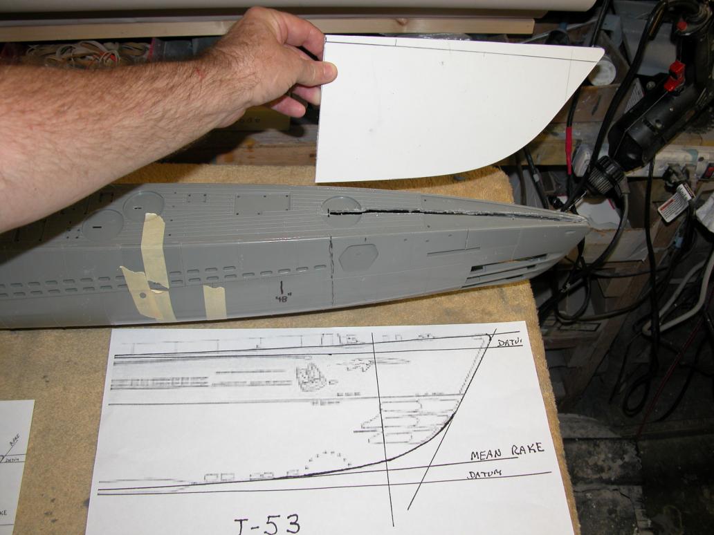

        And I have put in the silhouette for the nose-job. I will build up the bow using more plastic sheet --- and two-part putty since Chris suggested it might need to be a bit more robust than if it was just skinned with card.

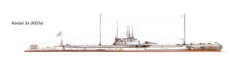

                Killing time looking at references.
                The aft section of this conning tower looks like the one in the kit.
                I just finished reading : There seem to be two subs called IJN I-53 in the book.
                This one which the book says is a KD type with the designation I-153 though the tower is clearly painted I-53:
Name:	I 53 maybe 01.jpg
                And then there is the sub I thought I am building, the C3 type boat, I-53:
                Which is it? Are there any more references out there? There was a great thread here once that had loads of references for the IJN boats but I can't find it today.

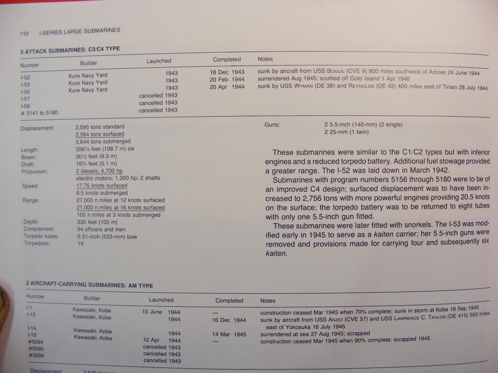

                    #39

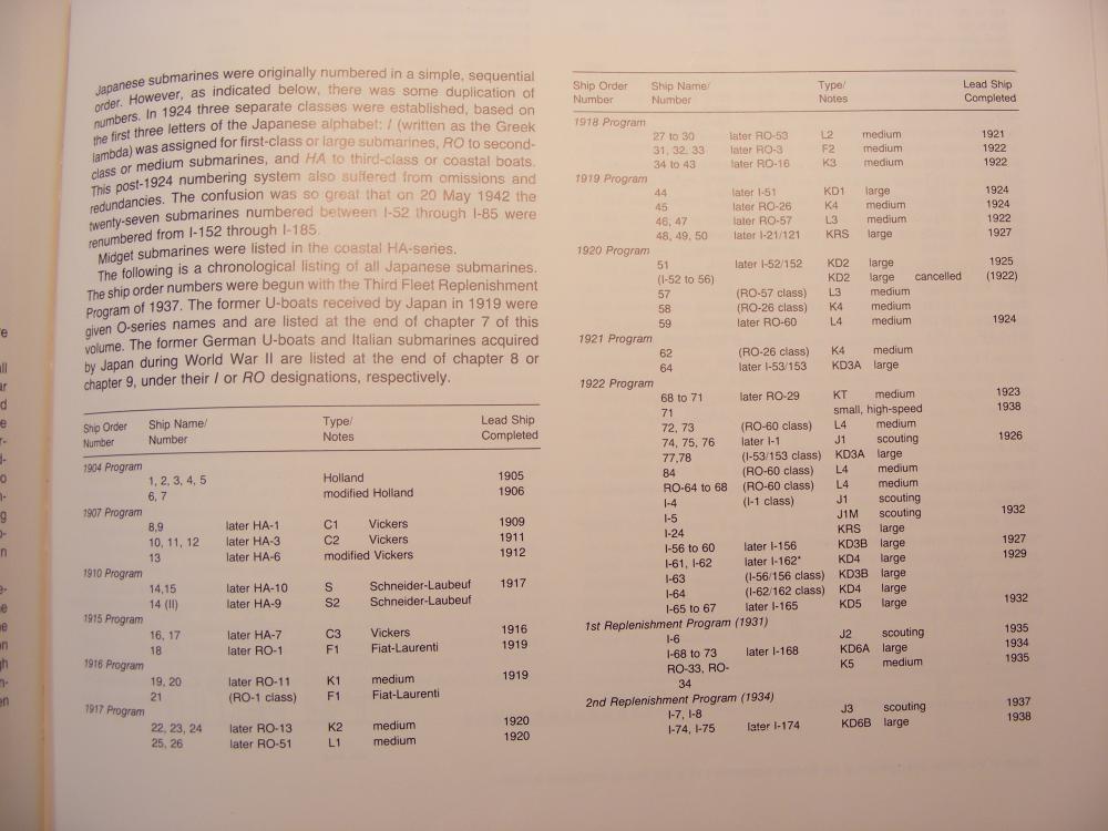

                    modelnut, I just caught on to this thread. Sorry, I dont get out much. According to this book called the "Submarines of the Imperial Japanese Navy,"http://www.amazon.com/Submarines-Imp...6597657&sr=1-1, the numbering system was a problem. Ill take a picture of the text giving the explanation to your I-53...I-153 problem. Cheers!

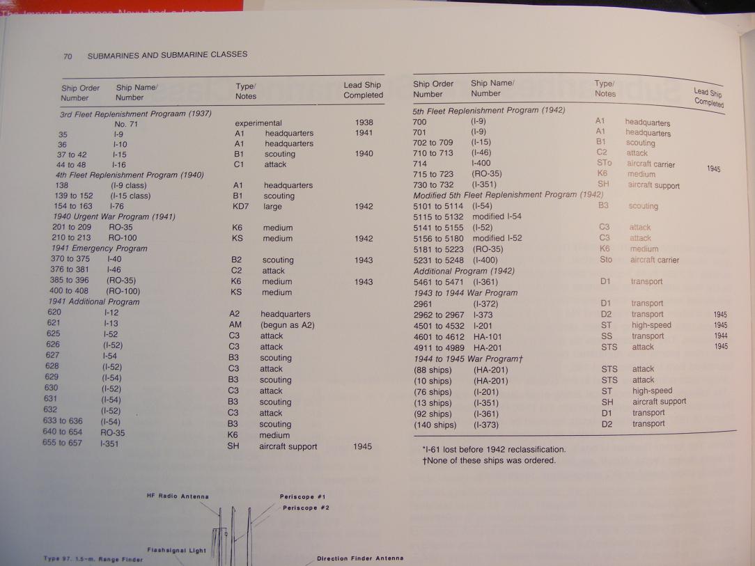

                      Tell you what, while Im at it Ill photograph these two charts that give a complete listing of all Japanese submarine classes.
ID:	67403Click image for larger version

                          Sorry to be such a pest but I thought you might like to see the page on the I-53.

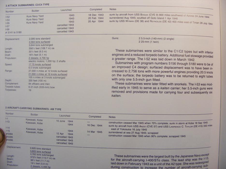

                            #43
                            Dang it! I cut off the words on the right side of the page! Try this one.
