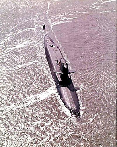

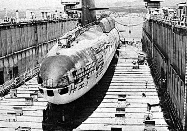

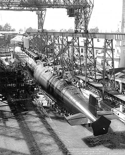

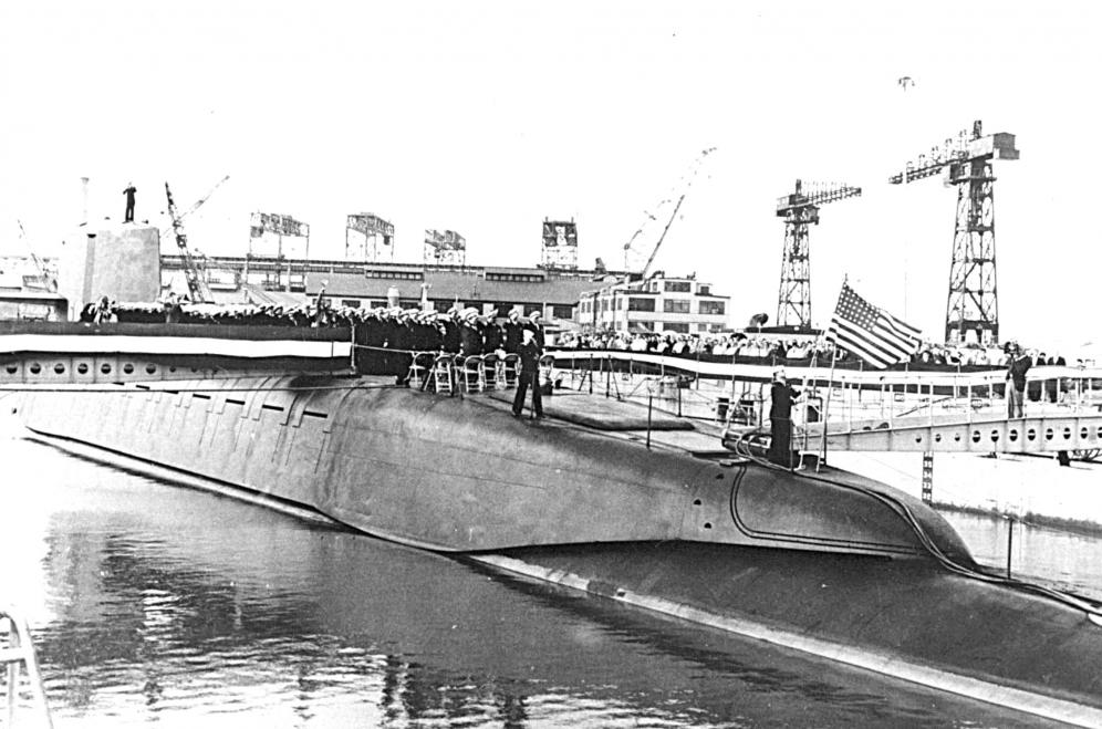

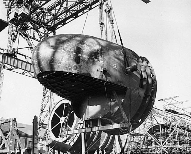

          • 950
          QUOTE=He Who Shall Not Be Named;n193502]
          Jim Christley and Adam Carelson have done excellent orthographic drawings of the beast. Work from those.[/QUOTE]
          A complete NEW 3d printed George Washington SSBN class would be a revelation. A modern do over of the Engels components with a new accurate hull. . There should be tons of research on these boats now. I was a kid and my incle once we drove by Mare Island NSY at night watching from across the river and saw Mare Islandin Vallejo all lit up ,all the building ways covered and busy working 3 shifts cranking out nuclear subs.
          They were cranking out these boats at a wartime pace in the late 1950's early 60s with simultaneous hulls being built at Groton EB Virginia NPNSB, New Hampshire Portsmouth NSY California Mare Island NSY.
