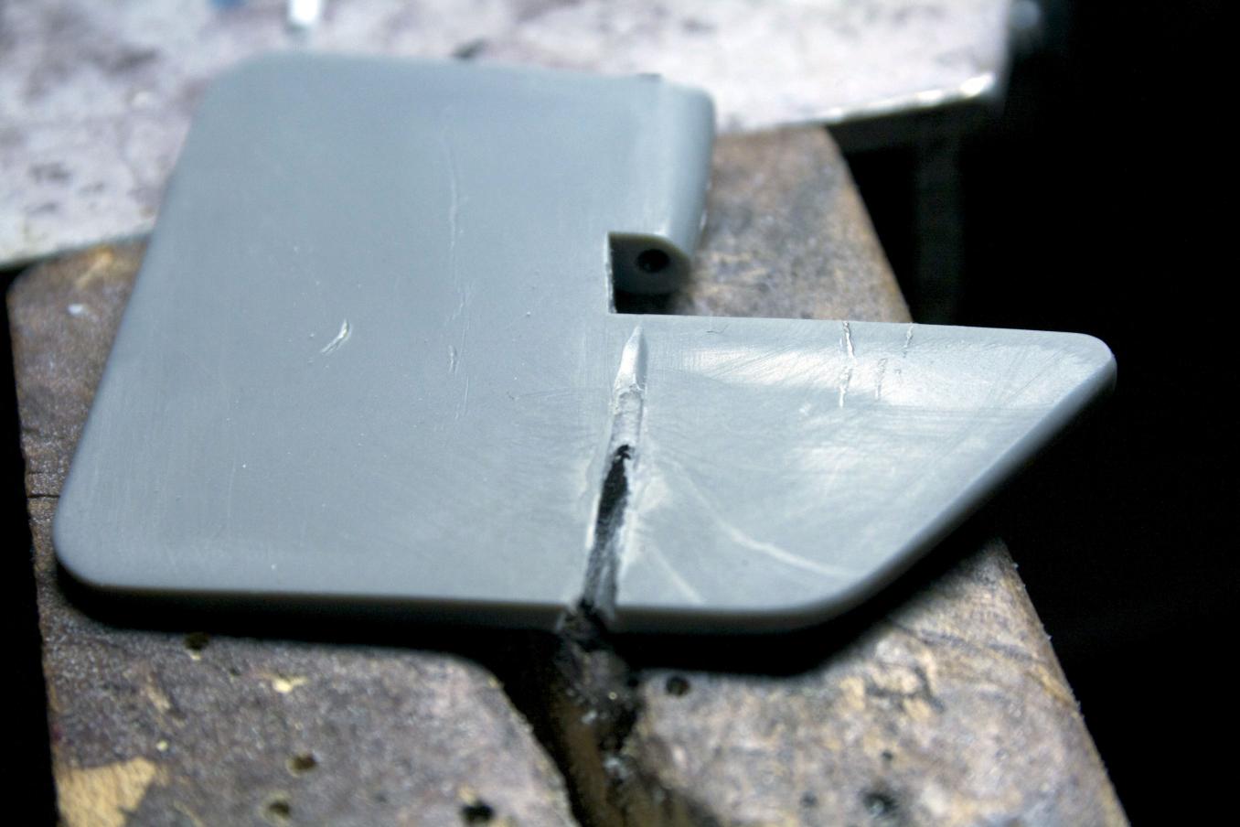

            I tried drilling the rudder last night and blew out the side at the bottom. I can probably patch it up. It does fit nice with the bearings I made and turns freely
              • 3768
              Yep it can be fixed - here is a shame photo of my rudder. Click image for larger version
