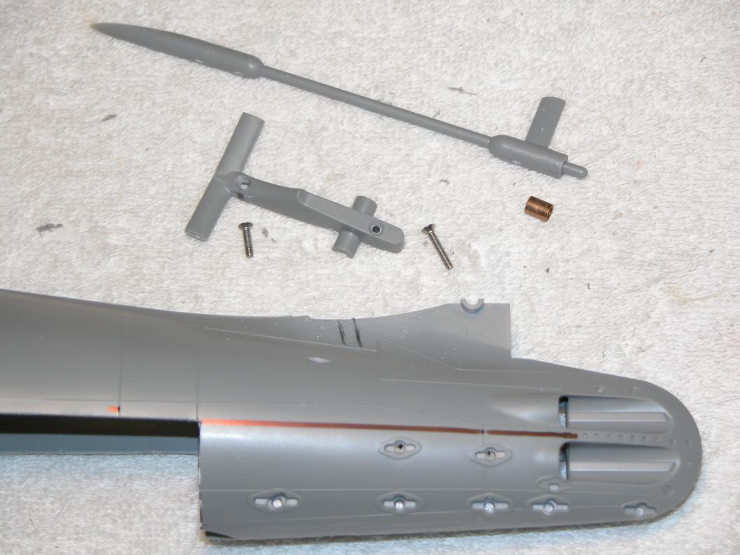

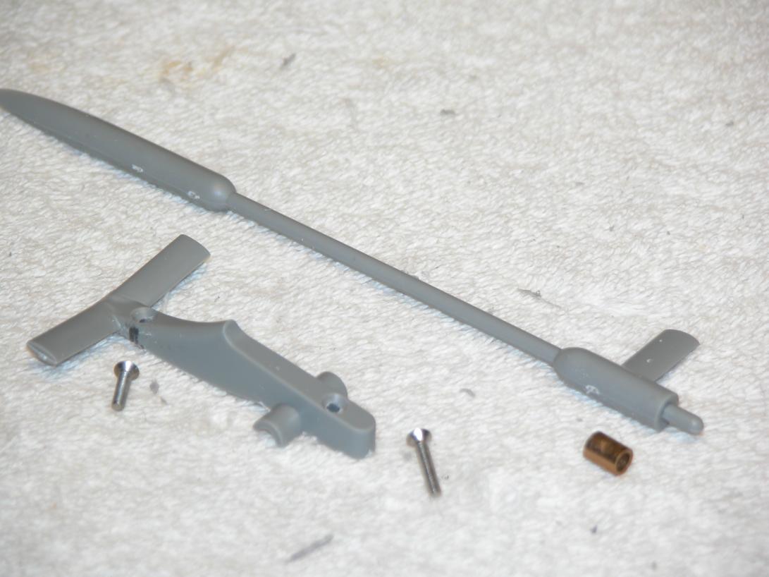

    I used on one model a single 2-56 flat head. On another model I used two. Both are holding up just fine.

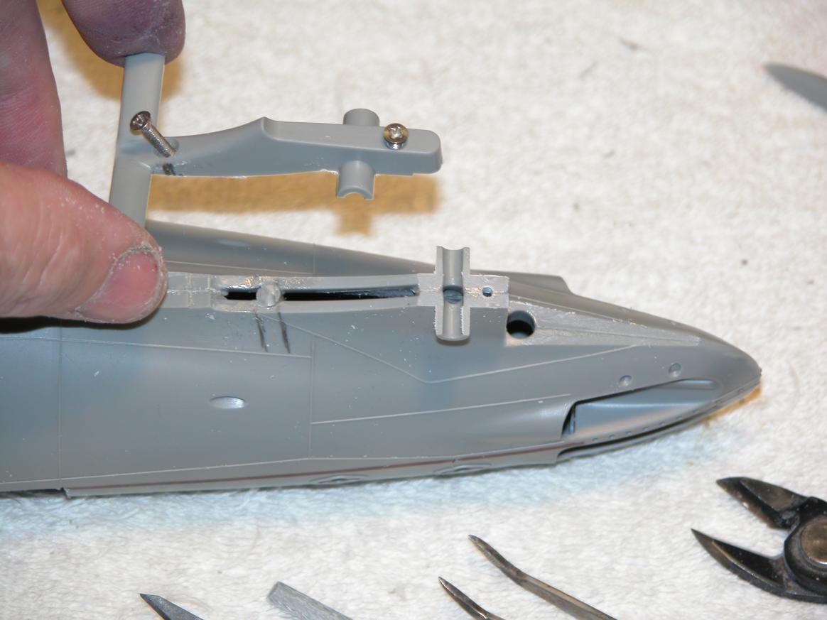

    A potential source of confusion is that I initially make the entire strut A-frame-stern plane lower bearing piece removable -- later making a vertical cut to separate the A-frame portion, that is eventually permanently bonded to the skeg with cohesive cement, from the stern plane lower bearing portion of the part. That removable portion (secured with either a single or two 2-56 flat head screws) permits removal/installation of both the rudder and stern plane assembly. You'll see what I'm talking about through examination of the below photos.
    It's best to drill a .0625" hole (1/16") through both the stern plane lower bearing portion of the part and skeg while the two are held together in alignment. Take 'em apart, then cut thread into the skeg bore with a 2-56 tap. Then enlarge the hole in the stern plane lower bearing part to 3/32", and bevel the top of that hole to accept the head of the screw(s).
    If you screw up the skeg hole, or are not confident you have enough meat there to get adequate thread, dab in some CA and baking soda, then drill and tap into that mess. Rotsa Ruck!

    This is the hard-way! Today I recommend you cut a vertical break between the strut a-frame portion of this part and the after stern plane lower bearing portion. Then straight-away gluing the A-frame to the bottom of the skeg.

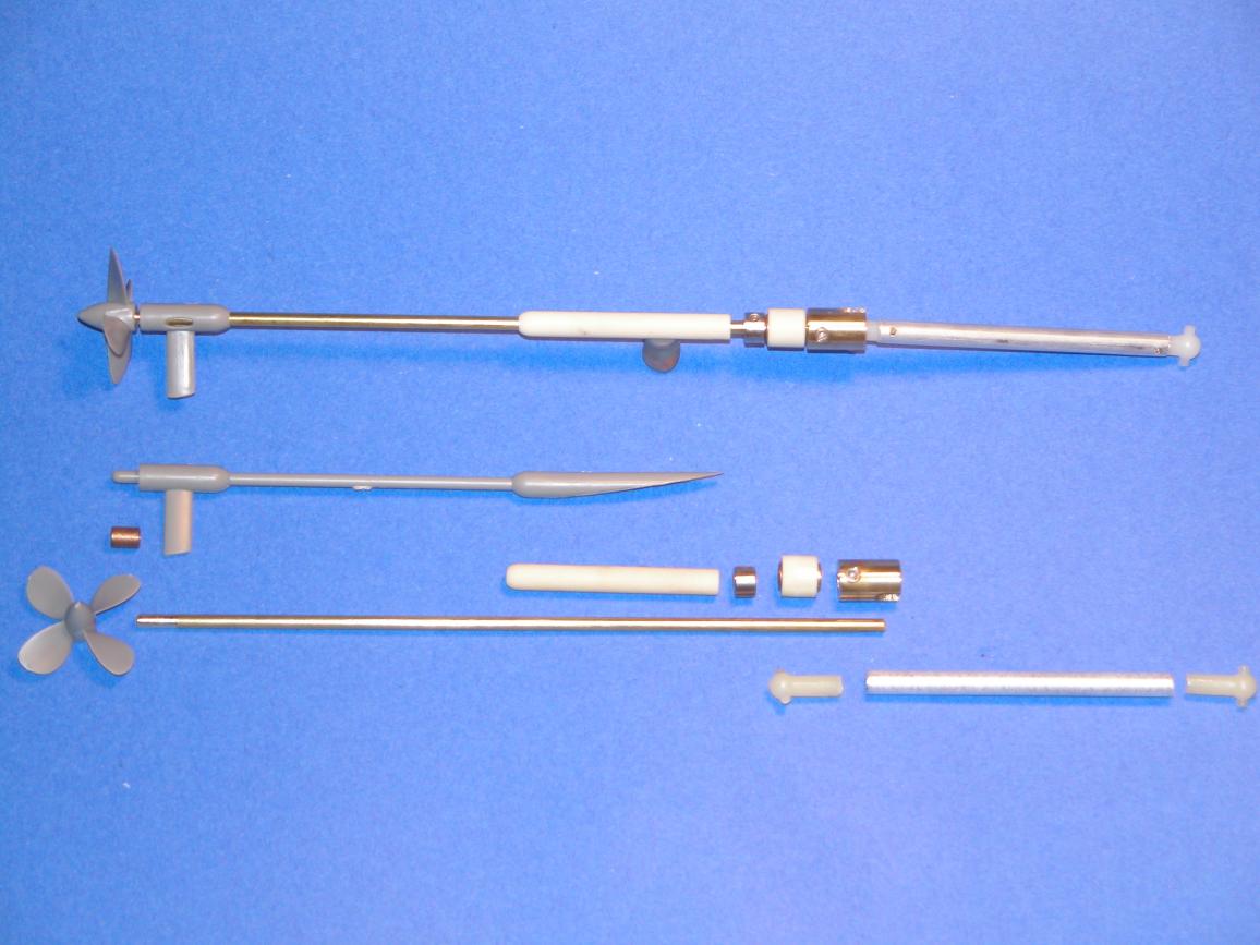

    If you elect to go with the kit provided strut bearing, ream out its ass-end to fit a flangless Oilite bearing possessing a 1/8" bore. Or you can go with the metal strut bearings provided in the fittings kit.

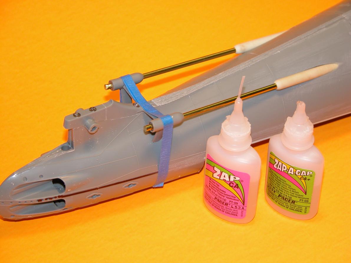

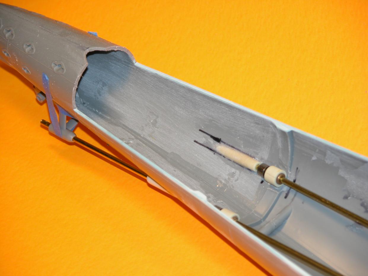

    The stern tubes are not secured to the hull till you have the strut bearings in place, a shaft (or shaft 'stand-in') in place, and everything checked for symmetry. And DON'T GET SLOPPY WITH THE ADHESIVE!!!!
