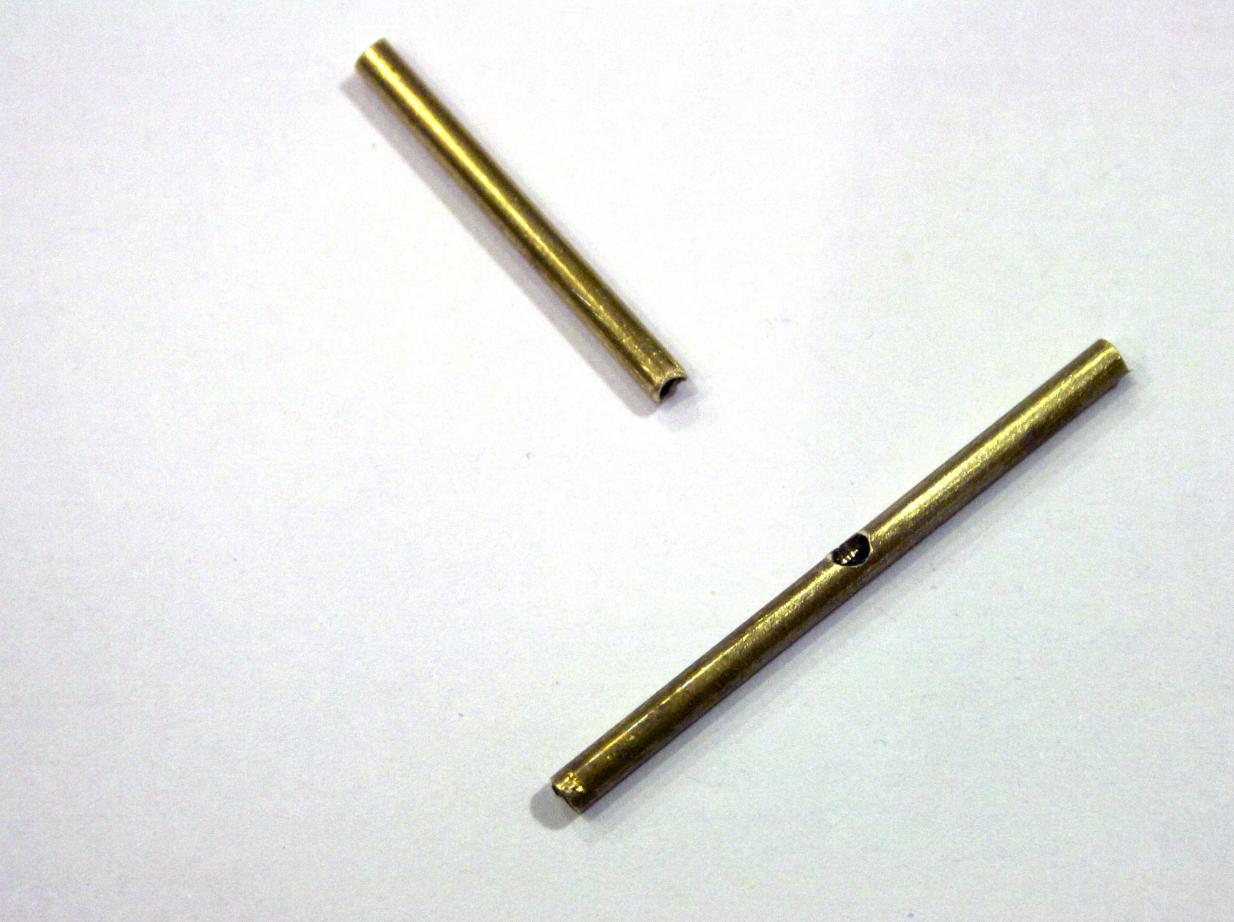

    I somehow thought I could drill a 1/8” hole through rear periscope shaft to add a brass riser to it (I went with brass although an excellent suggestion for using an antenna was offered - I do not have any spare or old ones around).
    So carefully and in tiny bits I was able to complete the drilling.
    The joys in small accomplishments. The brass tube did not slide in nice and easy. I had to take a 1/8" brass tube and file/cut teeth into the end and I roughed up the outside with 120 grit sandpaper. Then spinning the rod as it went through helped bore out the path and open it up enough to allow the inserting of the tube.

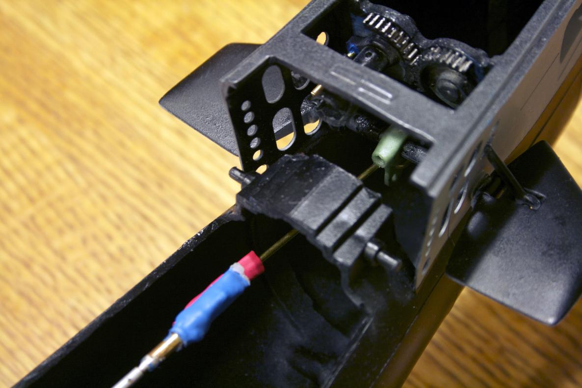

    The forward dive planes would not move to the full extent, the push rod would bow. The issue I found was that the ball and nylon socket caused issues and the throw was not enough. The ball and socket seemed to add to the friction and also not allow a straight transfer of power. The first thing I did was remove the ball and socket connector and replace it with a Z bend pushrod. I also drilled a 1/16” hole closer to the dive plane shafts. (if you look carefully you might see the Z bend installed above the original hole. This one change removed most of the loss of power to the dive planes. I still have some magnet shifting and will create a holder to help prevent that (crayon drawing in prior post).
    I got the dive plane to open and retract. Moving the retract rocker arm up and slightly back helped get it close. I also used a longer arm on the servo and that seemed to make the difference. No photos of that yet...it is ugly. I used the slotted disk to hold the bar in place.
    The rudder issue is solved. I made the flat area on the shaft even more flat and deeper so the set screw on the bell crank can get a firm hold. Reinstalled and tightened it up. Solved.
