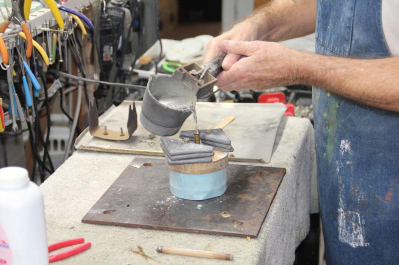

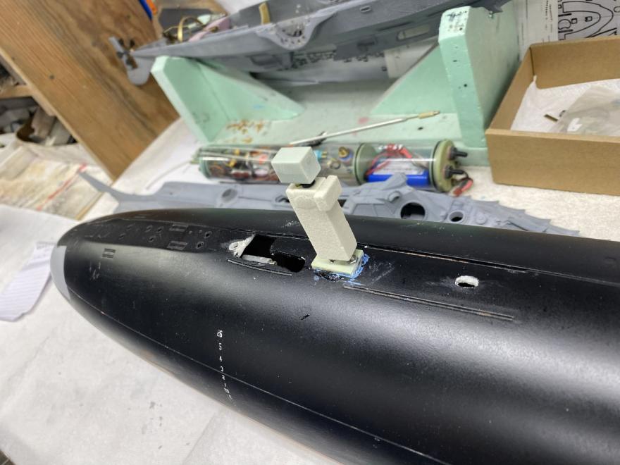

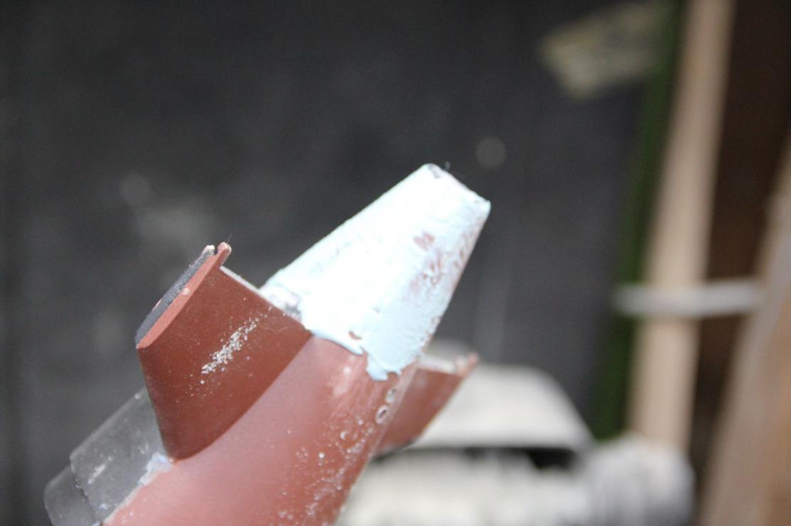

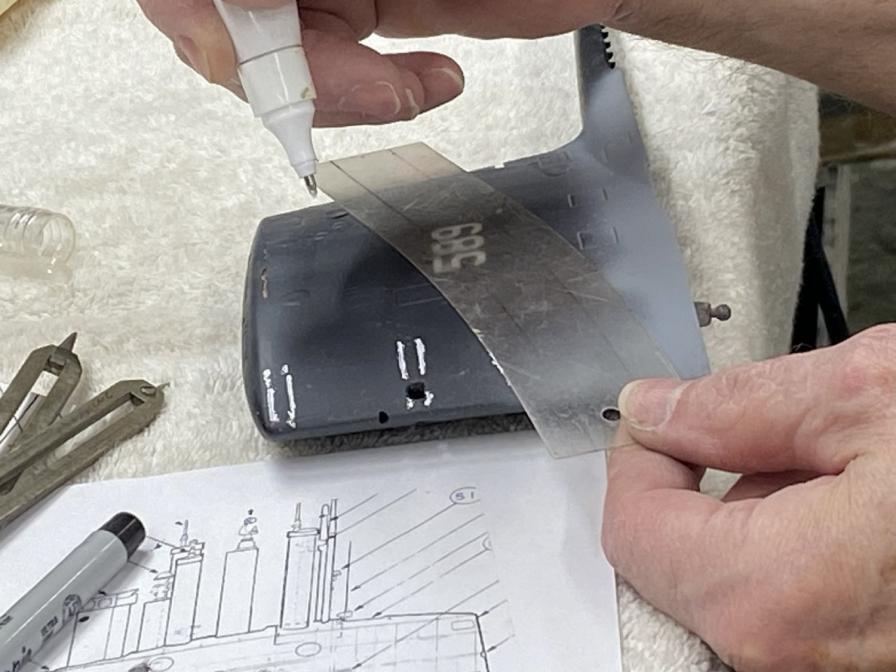

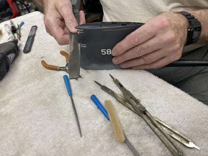

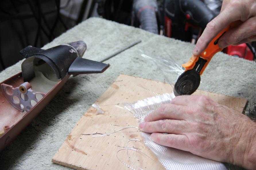

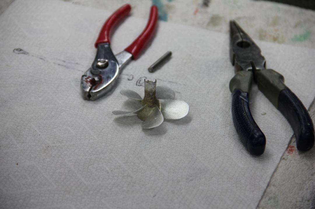

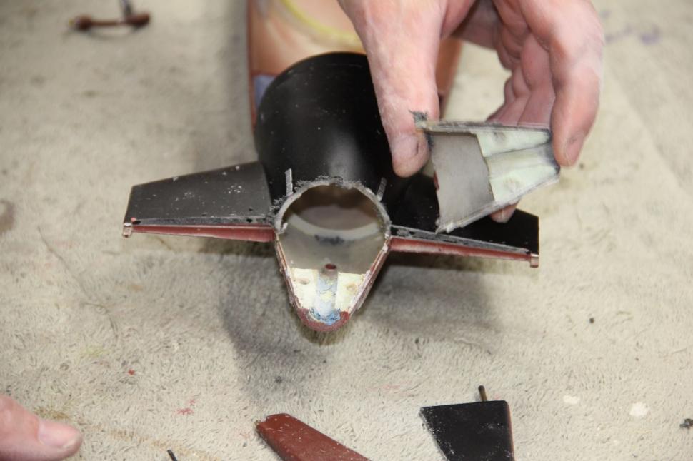

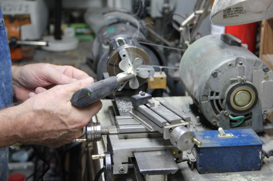

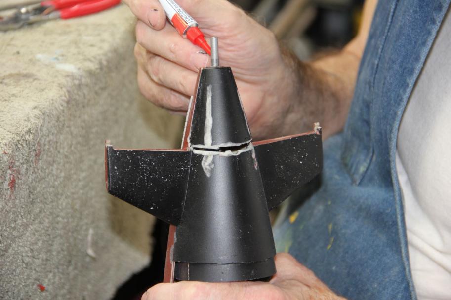

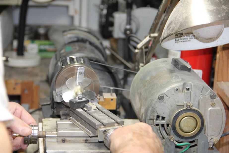

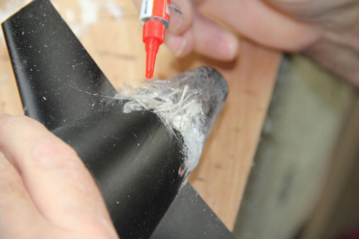

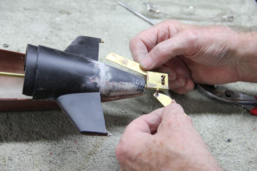

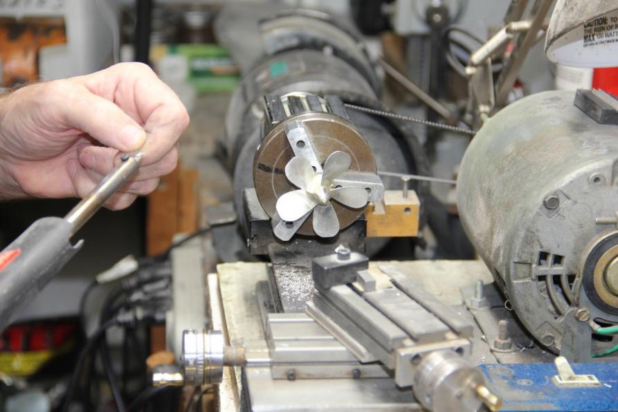

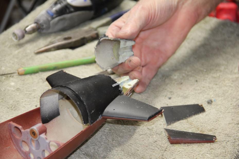

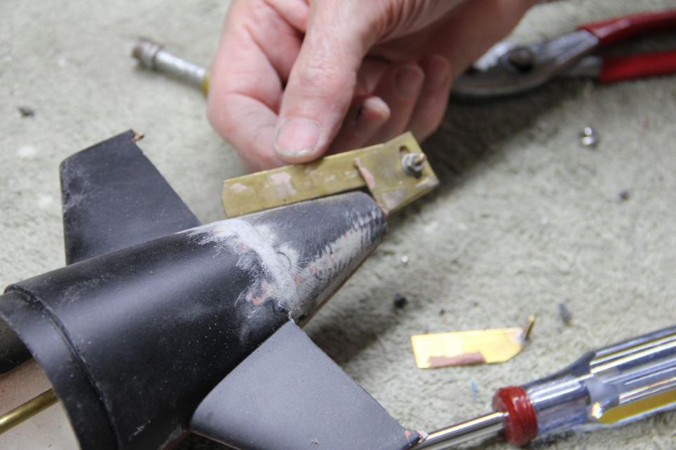

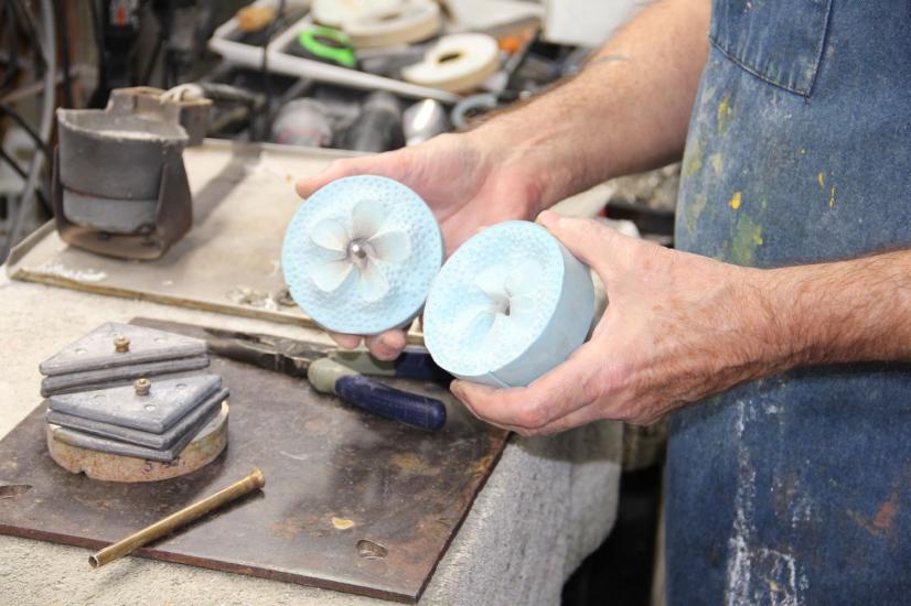

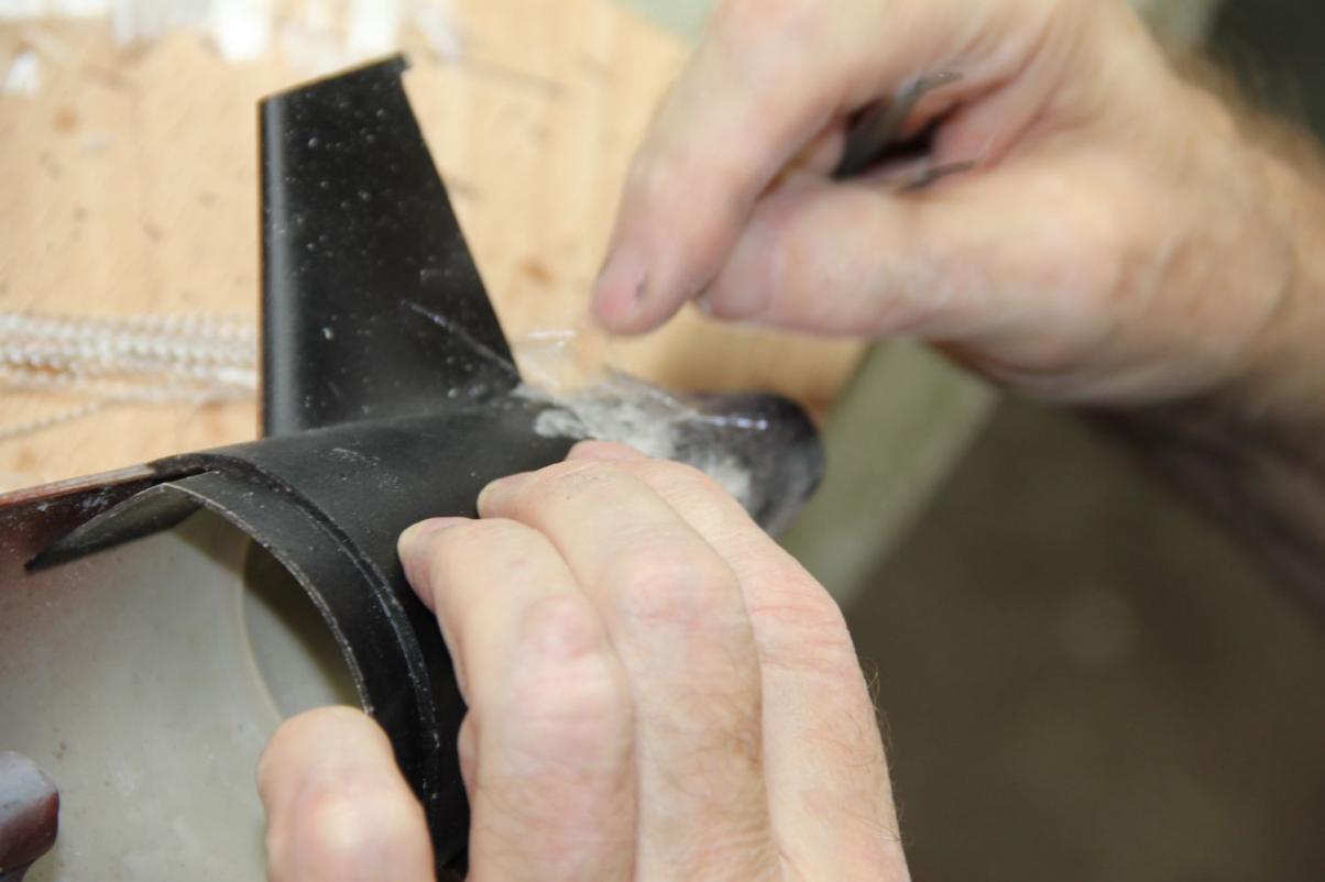

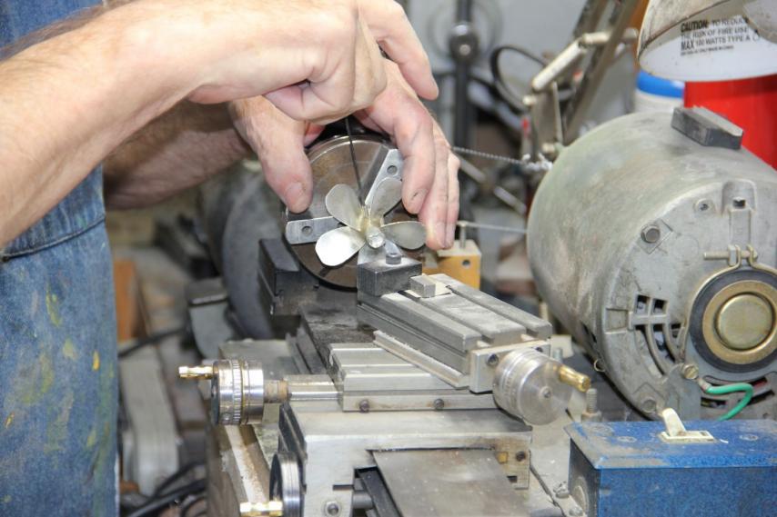

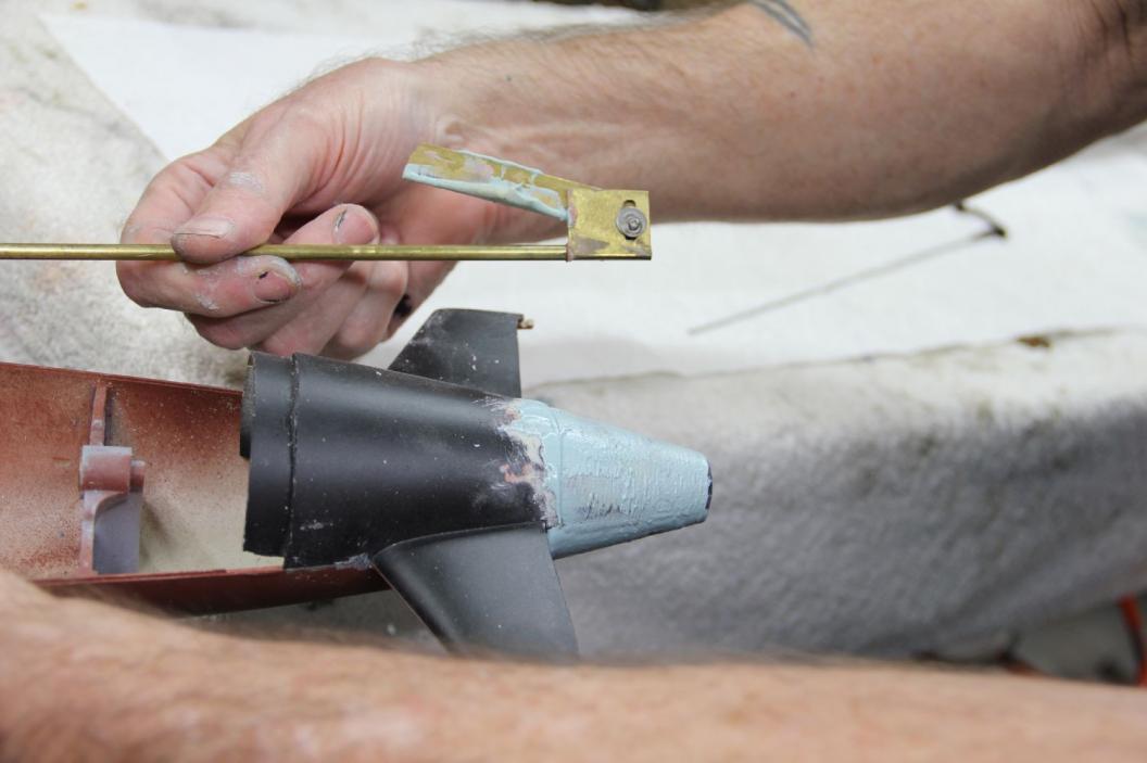

    I love driving my 1/96 Shark, but driving Merriman's 1/72 Skipjack is that much more, especially in larger body of water, so I had to get one. Picked up a partially completed hull. This week I've had my hands on four different subs. The working the damage to the Shark is completed, and it's ready for the next event. The Type IXC U-boat is going to get another flat coat, but all the details are completed except the cabling. So picked up a 1/96 Type XXI that I've started grinding/ filing the ports in, but that's a longer, side project. The main focus will be on the Scorpion. Brought it over to Dave's today and he made up some correct screws for it. When trying to fit it, the tailcone needed re-work, and the shaft hardware updated, so here are some photos of that. We looked over what direction to take it.

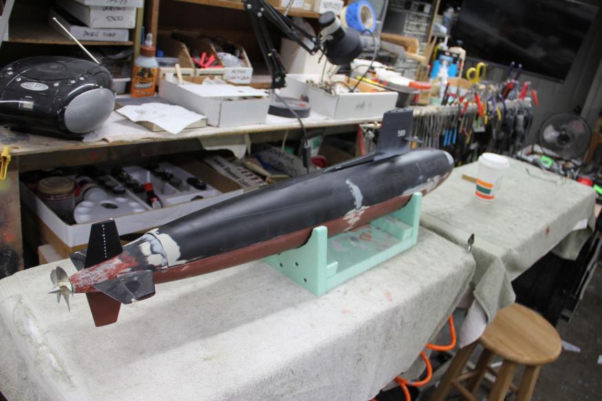

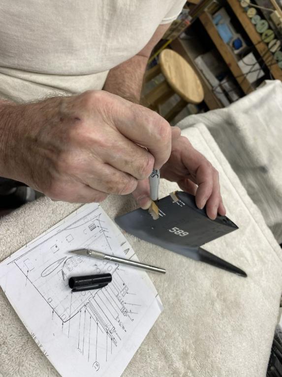

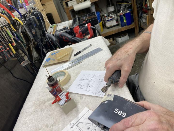

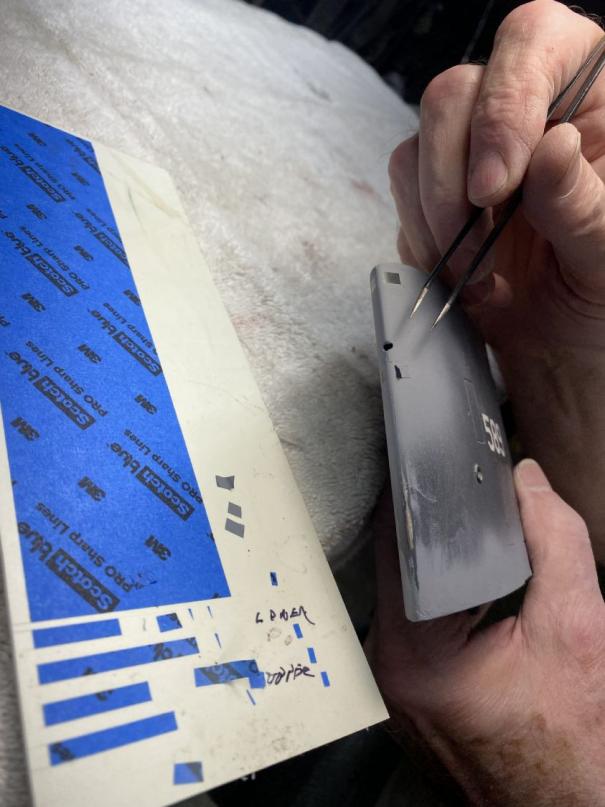

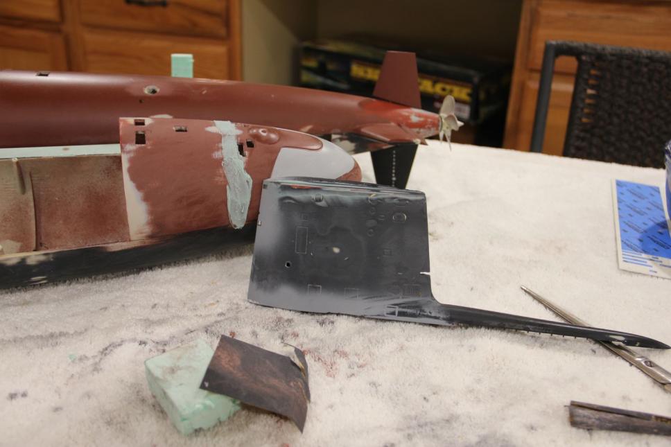

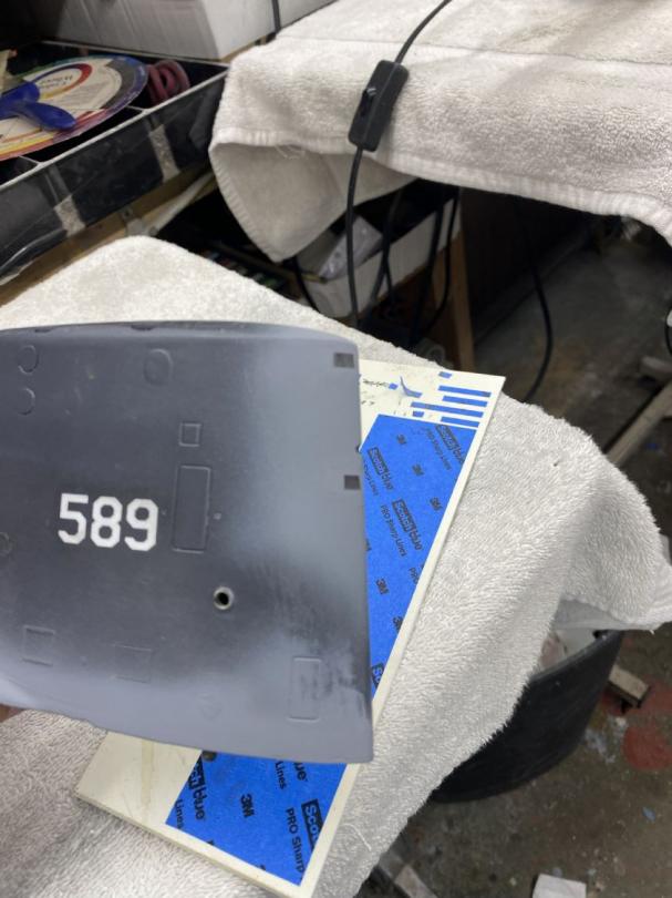

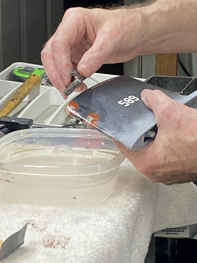

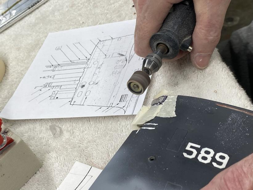

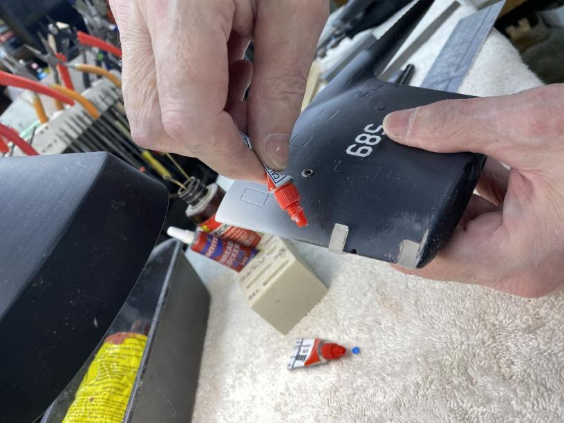

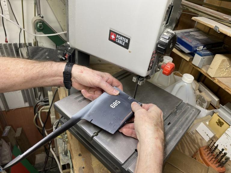

      Been doing a lot of work on this hull off and on with Merriman doing the lion's share of it. Got everything working, including the WTC, now it's time to clean up the hull, which I'm doing in my workshop later this weekend, so I can get some primer down. The WTC operates great...except we have one of the FrSky stabilized receivers in it. Steve M. has helped out a lot in this as he has one working. I can't get mine to work yet. When I select the channel for the stern planes, it locks it up. I had used Bob's set up for the radio and receiver like I did with the 'un-stabilized' receiver which doesn't go through the same set up initially, as the FrSky video on Youtube, one thing it does on Youtube is assign a channel for switching stabliziation on/ off. I tried doing this, but to no effect. I think I'm just going to delete it and start over. I have two subs operating with the 'un-stabilized' receivers and really like them, so this is just a hurdle. Anyway, these are photos from the latest work. I asked Dave to make some of the acrylic windows for the sail, and sorry but the photos are out of order, but it's all there. Dave did the entire work in just over 3 hours. Looks great!!
        Jake, I don’t know which part of Scorpions run your configuration is, but I started her at near the end. At that point, she only had one set of dead lights on the sail, which is why I decided to delete the top ones. Here are some photos. The closeup is what I used on the sail you received from me. You’re doing great job. Can’t wait to see her operational.

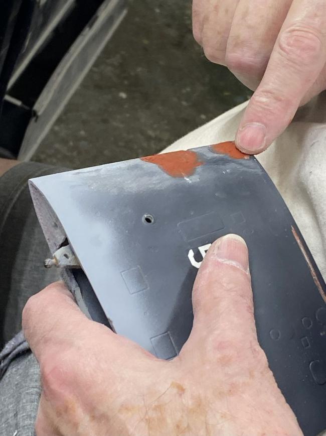

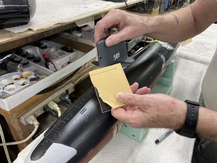

          Merriman asked me beforehand if I had a print, and I told him, 'It's not a tank, so of course not.' The print he had showed it with the two. Thanks for pointing this out, I'll just paint over the upper ones. The timeframe for the boat for me is towards the end. It's going to have the haze grey sail and rudder, but it will have the white hull markings and name. Found a photo of it with it, so it must have had a change of command to have those on the sail. Today, I'm scouring the hull and fixing imperfections prior to painting. I'm not getting back to the WTC for a bit as I have a trip coming up.

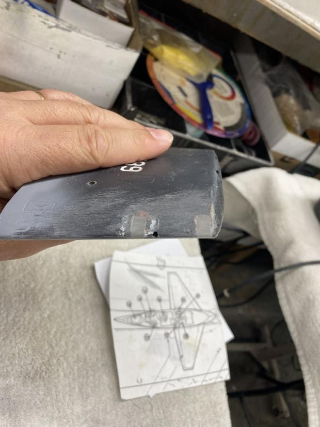

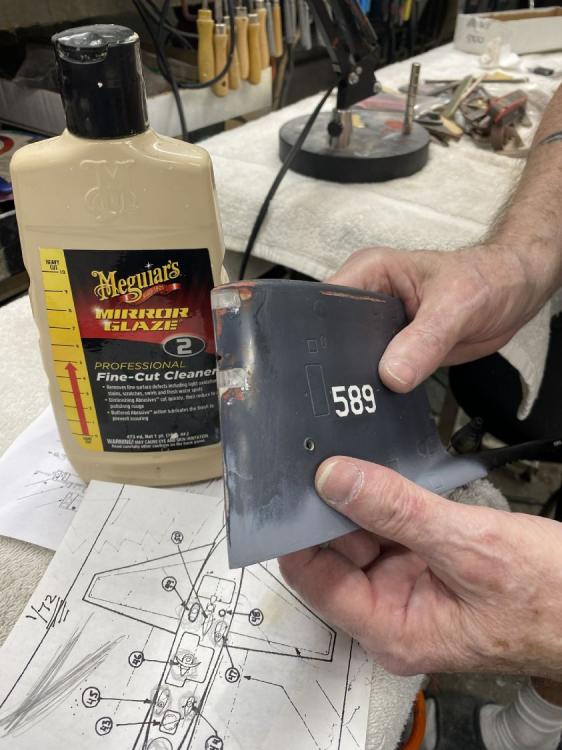

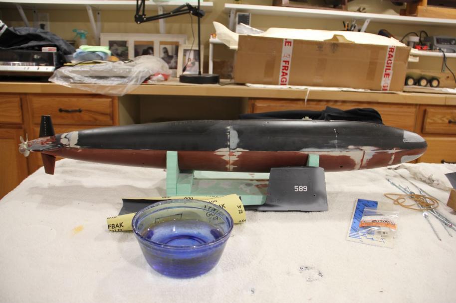

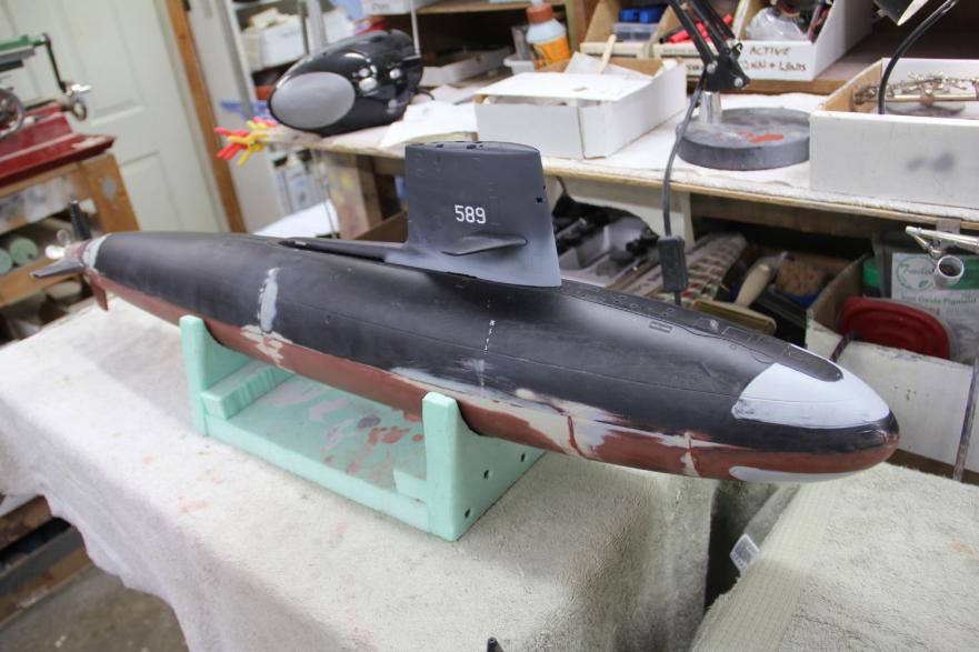

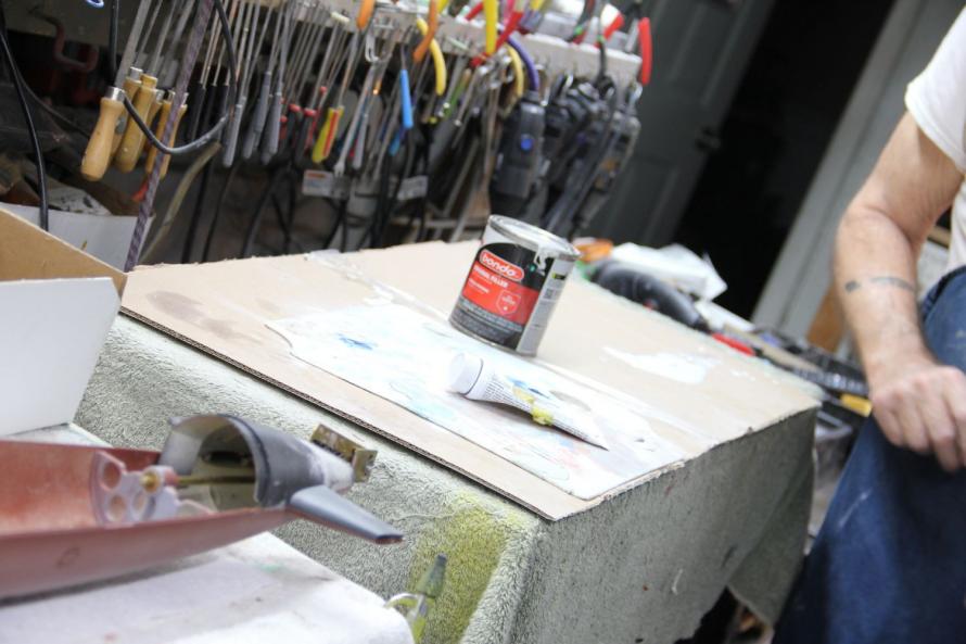

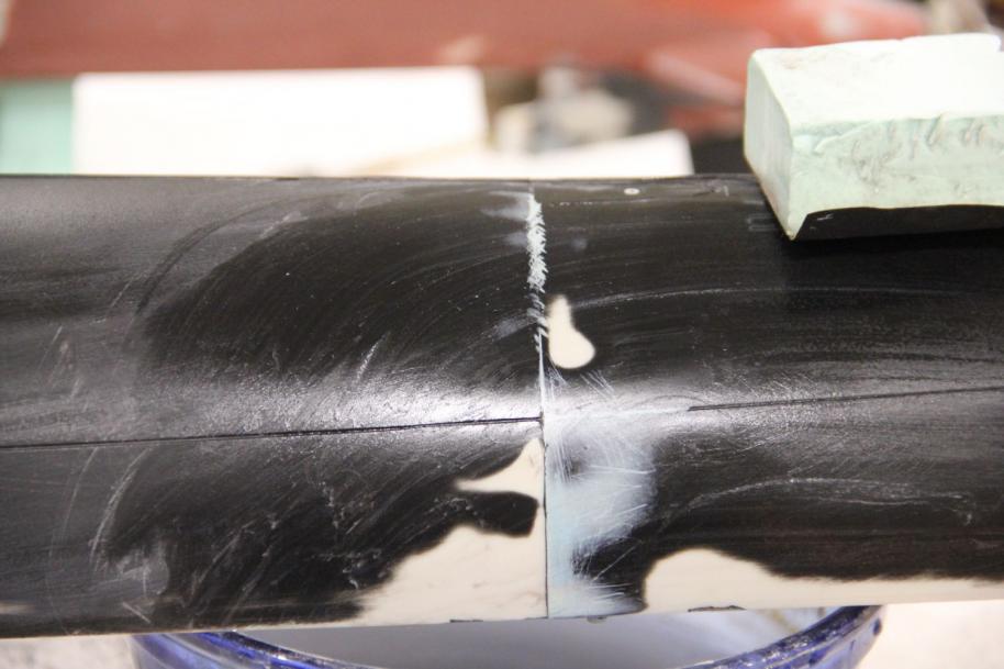

                  This sucker's almost ready to paint. This is where I ended up at Dave's shop all assembled. Took it back to my place and corrected hull issues, mainly with the axial hull assembly seams. Thought I had it yesterday, didn't. Cut the seam out, drowned it with body filler, sand/ wash tomorrow. Going to get it primered this weekend. Gotta get back on the stablized Frsky receiver.
