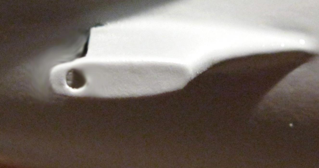

          I may have a better way (due to my own clumsiness) with a portion of the stern planes. There is a small circular portion that the control rod passes through connected to the fixed portion of the stern plane. They are small and somewhat delicate. I inadvertently snapped one in half in the process of handling. Once I knew that it was damaged, I fiddled with the other half and noticed that it snapped off easily.
          My solution was to add a small sliver of sheet styrene (1/32 thick, I think), a bit bigger than the airfoil shape of the plane, glued to the outer edge of the fixed portion of the stern plane. I also added one to the other "good" side. I then drilled holes to allow entry of the rod on he movable portion. I will have a picture of this.
          The styrene is more pliable and although this extends the total width of the measurement of the sub across the stern planes by about a total of 1/16", it makes for a more durable part that the control rod goes through. This is also the reason I have been slowed down taking pictures.

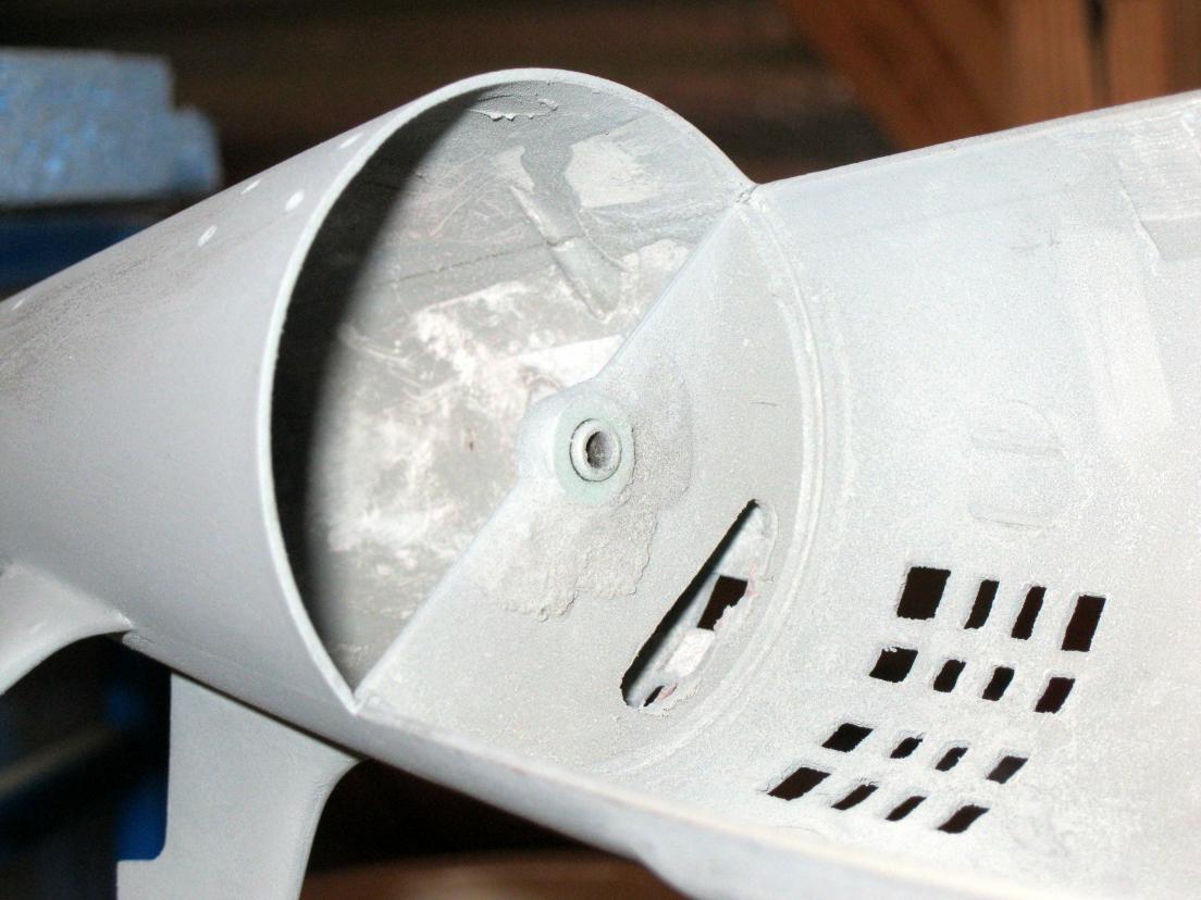

              Fifth picture is repair to stern planes.
              Doodah
              If you ignore the problem long enough, it will go away. Even flooding stops eventually!
              • Peewee
                • 15
                A nice repair,
                Ian
                Sane? who knows, who cares?

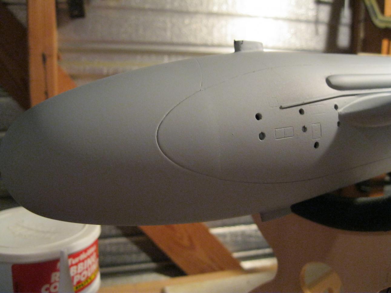

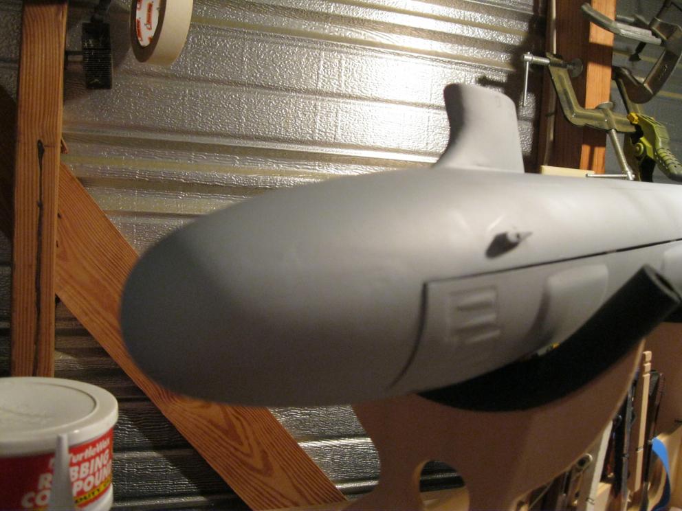

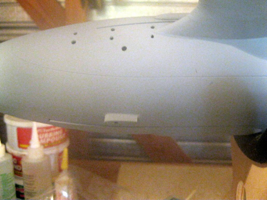

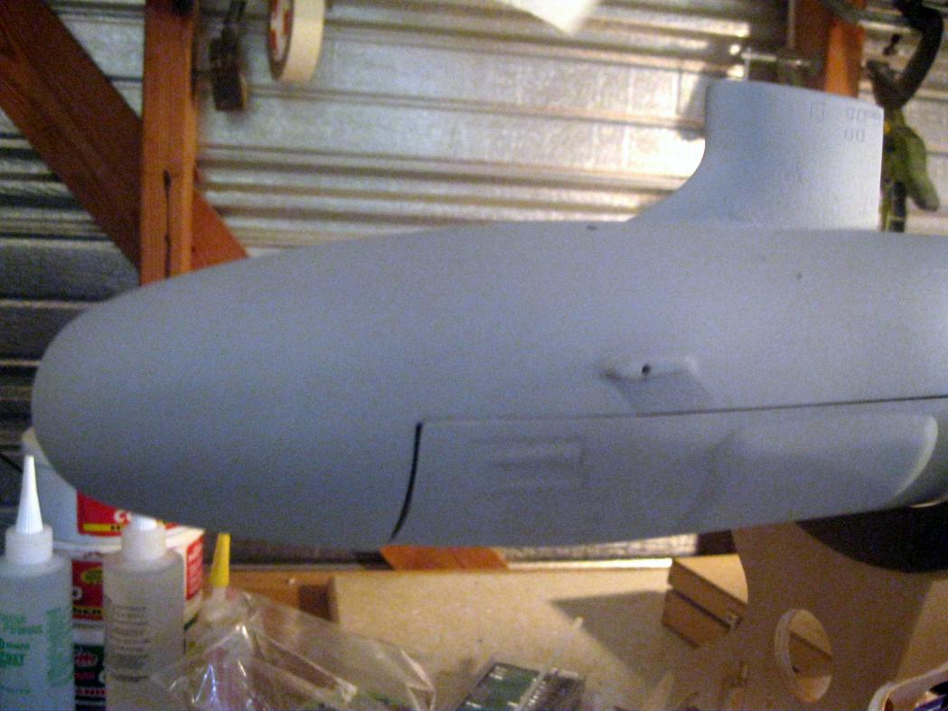

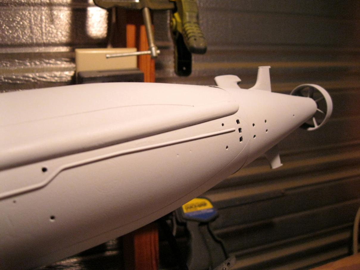

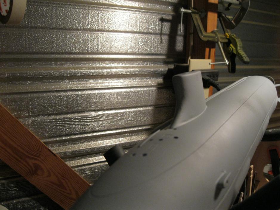

                  Some explanation on the photos. Top and bottom hull halves are just laid together. Am still working the fit aspect. Shot of rear bearing and half cut in stern. Sub Driver assembled without seals to experiment with assembly and fit. Note the black tape on bottom (substituted with locking ring sent by DM yesterday). First coat of primer added to firm up hulls, seems to give them more rigidity. Will be working the tab/magnet combination to remedy fit.

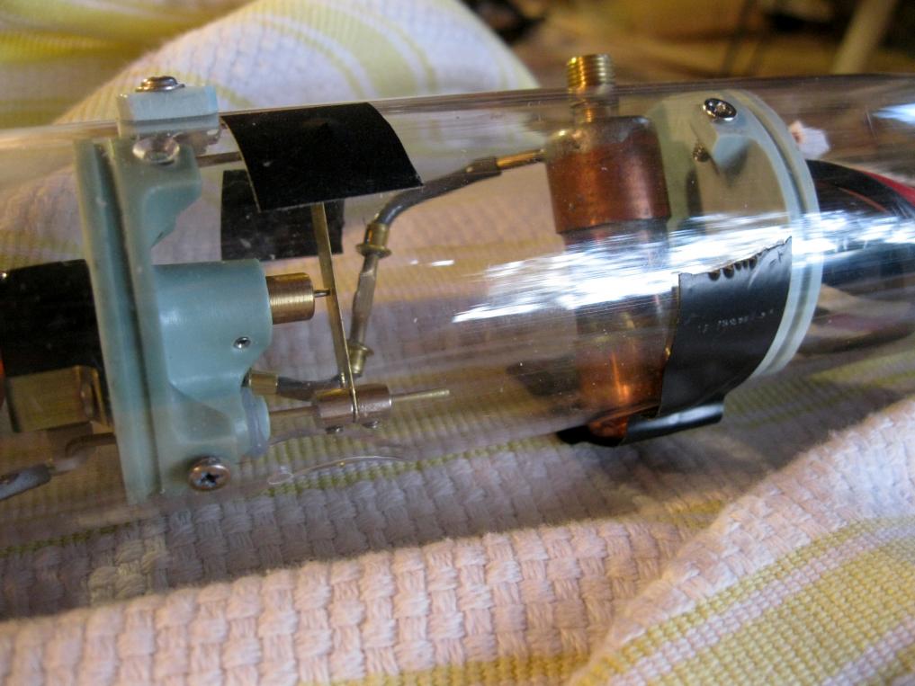

                    Last night I started "messing" with the blow system, adding canned air and using a spare receiver/transmitter to operate the blow valve. Seems to be a leak in the system. Managed to jizz up the lexan tube with too cold propellant. Will need to remove pieces parts and clean inside, investigate leak. Will continue with indexing tabs PLUS magnets tonight. 4 days of construction since my nurse is on for 4 days.

                        Leak on valve inside. Allowed super-cooled propellant to leak out into tube. Seems that the "cap" that is normally soldered to the tube (on the aft ballast bulkhead with the blow servo) was not soldered completely around.
                        Spent my working time analyzing and repairing. Now I need to figure how to clean up the lexan tube.
